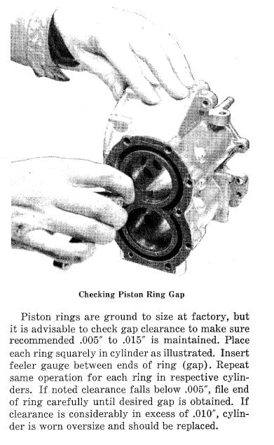

        #221070
          End gap should be measured at several different spots in a used cylinder to allow for wear and the end gap set at the tightest spot.
          TD-TN-Rings

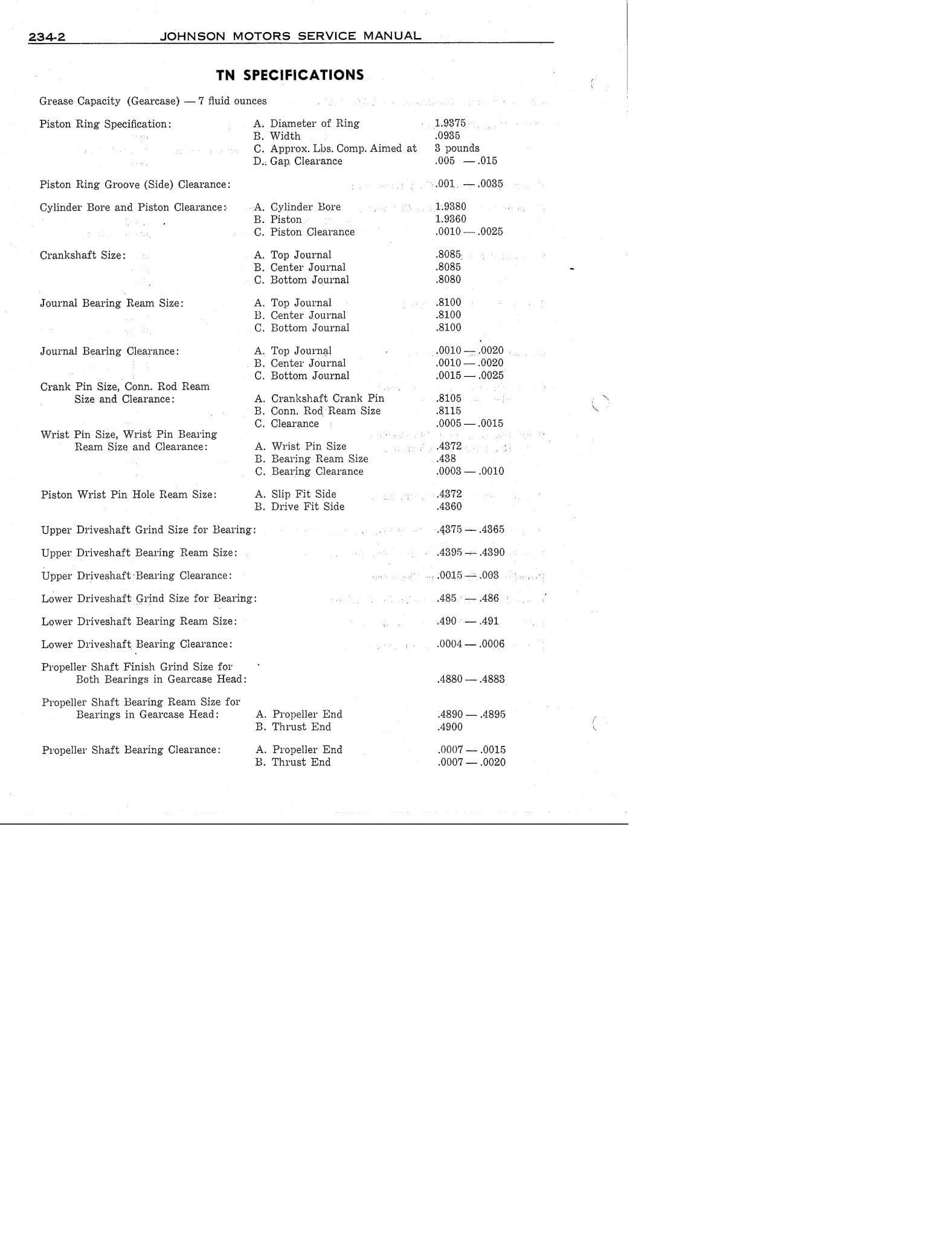

            #221237
            cajuncook1
              Johnson-TN-specifications
