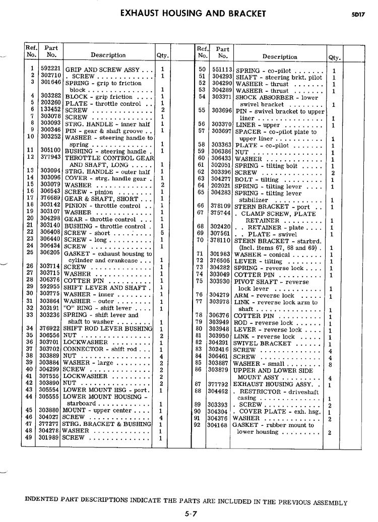

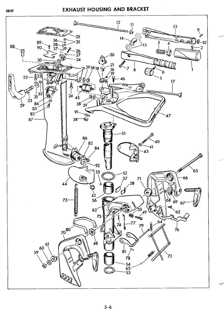

          #248618
            Pg-6-Manifold-and-Bracket
            Pg-7-Manifold-and-Bracket-Parts-List
            #248633

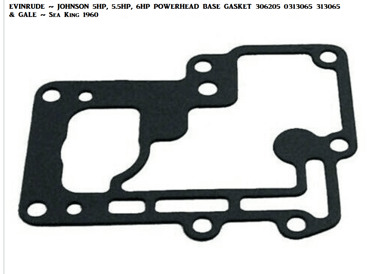

              Interesting! Franks diagram shows it as a 306205 gasket which superceded to 313065 which were used on T-stat motors.
              Gale must have made a design change around this time as the housing and it’s related parts look the same as the ones used on the ’56 and up JE motors, not like the ones used on the ’54 – ’55 JE’s as earlier Gales did.
              #248638
                Thanks Frank and Mumbles!
                I just looked up what said gasket looks like, and added notes to it
                for my records.
                Power-Head-Base-Gaskets
                • This reply was modified 5 years ago by Buccaneer.
