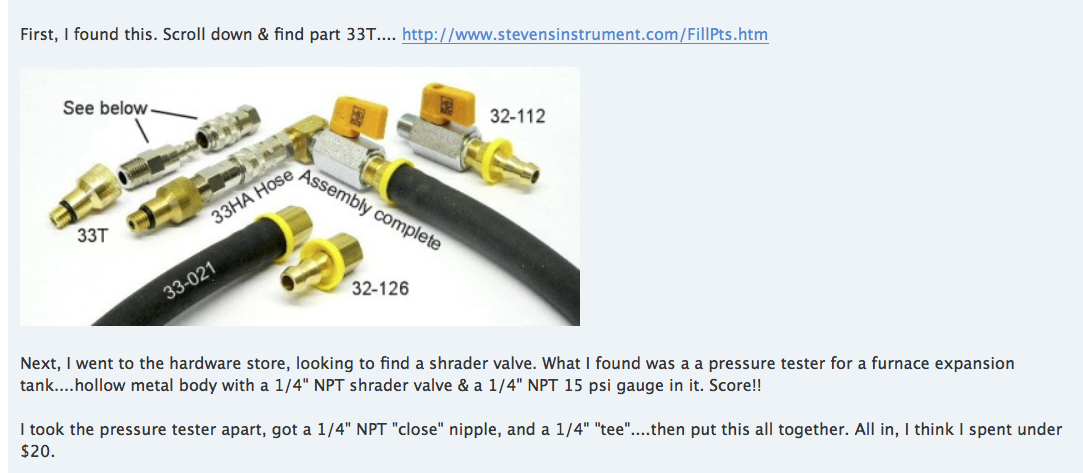

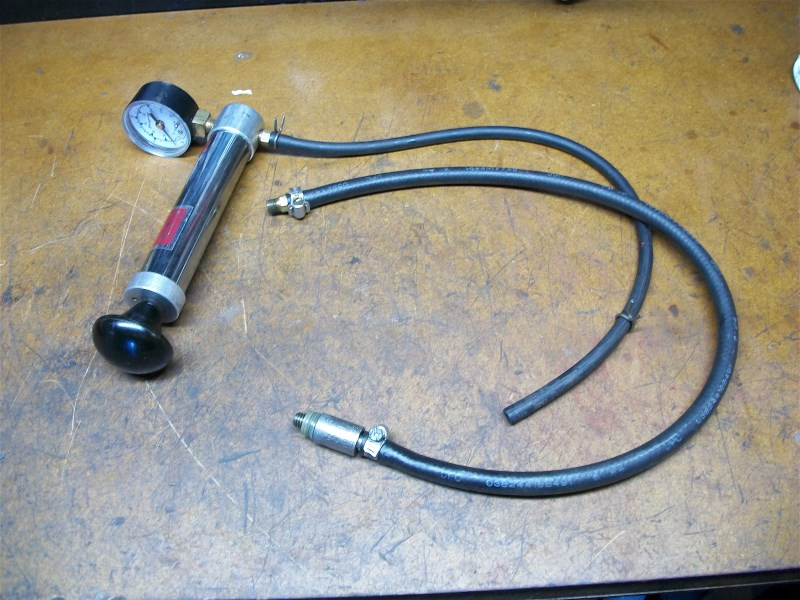

        nj-boatbuilder57
          If you can machine something…..great!
          If you can’t, here’s a 3/8-16UNC to 1/4"NPT adaptor. Part # 33T
          http://www.stevensinstrument.com/FillPts.htm
          3/8-16 is a bolt thread, not really a "fitting" thread. But once you convert to the "world of NPT", there’s nothing you can’t do….

            NJ-Boatbuilders contributed this on a previous inquiry . . . 😀
            You will have to copy the Stevens Instrument site to see the fitting.

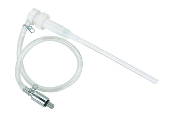

              I used the fitting from a lower unit fill kit…
