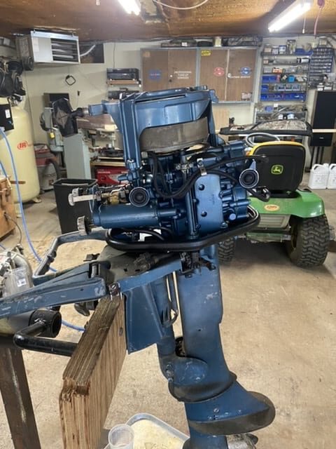

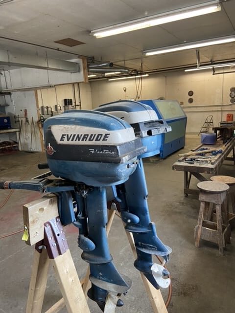

          It’s a 1956 fleetwin. 7.5 hp. Georgeous shape. Had a little milky look in the gear case oil. Not sure if it warrants a tear down? That’s why I’m thinking of a pressure test.
          DFD64280-7A48-4795-A406-0B2ABAD211F1
          AF09355B-C614-4115-A3C1-C2C9635C8505

            90 psi on both cylinders. Not one dent in the cowl. Just faded paint. And taped to the handle is two shear pins. Looks original as the tape is falling apart.
