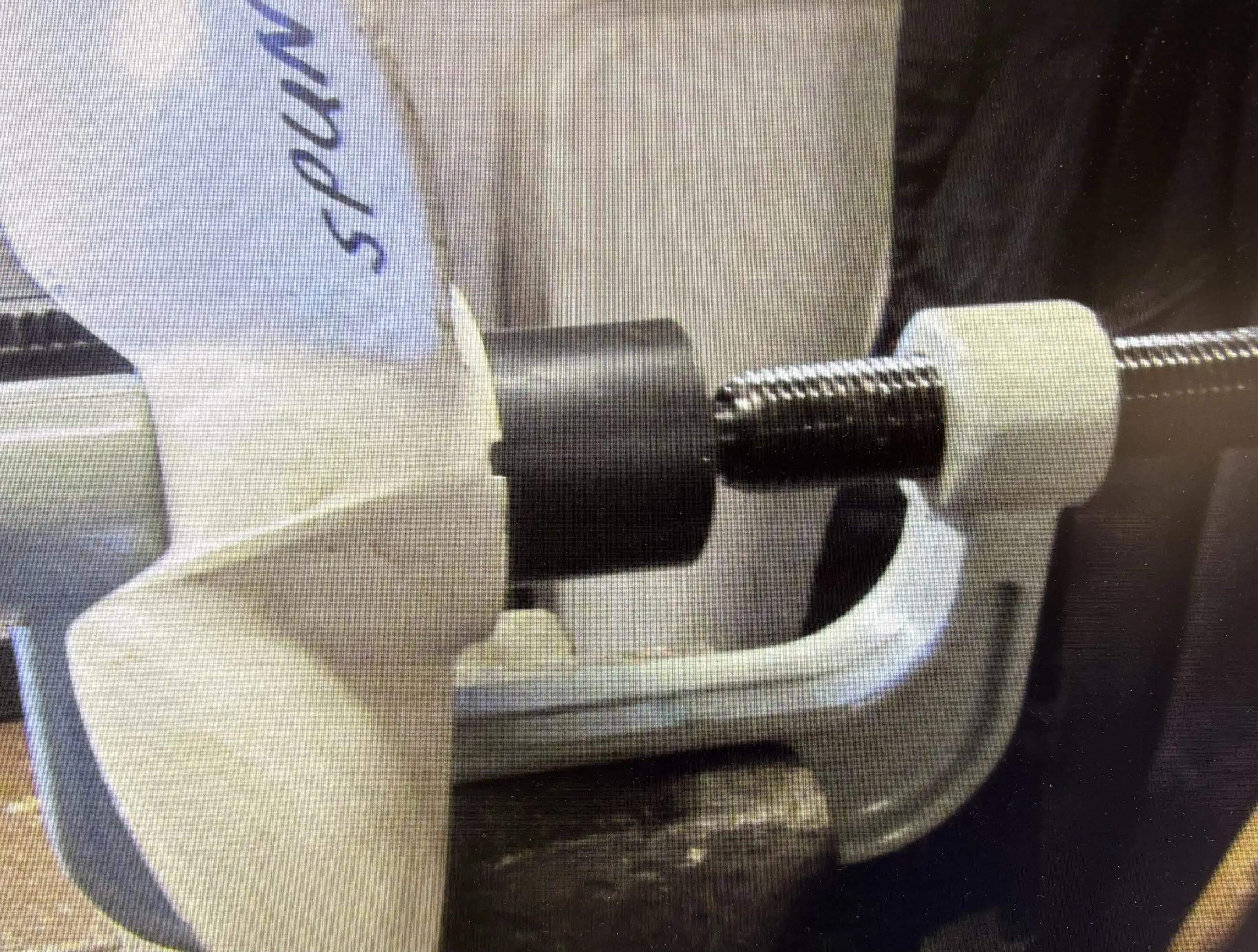

            JT here is my two cents on this subject.  The cost of replacements propellers sometimes is reasonable but sometimes the propeller you purchase is also spun.  I decided to try something to push the new insert in and the old one out.  I bought a ball joint replacement kit.  Clamped it in my vice and pushed out the old and slipped in the new, good as new!  The kit came with a guide sleeve that keeps the new insert from bulging.  I used the same 50/50 mix that was recommend as you did.  I was surprised at how good it worked!  I will try to post some pictures.  These pictures are from a 35hp OMC.   Pictures not posting, I tried twice!

            #318655
            Dale
              Try again different computer!  Hope this works.
              dale

              Dale
                All,
                I have a 1960 Evinrude 18hp Model number 15032 with a slipped hub. I have spoken to 3 prop shops near me and none of them will replace this hub. Left with no other option I decided to attempt this on my own. I have ordered the replacement hub (VS-10) from HMS hubs and am trying to install it. I have followed their directions and I’m unable to get the hub pressed in. According to their directions I have cut the corner of the bub back 3/16″ at a 45-degree angle, soaked the hub in 180-degree water and then lubed it with a 50/50 mixture of dish soap and rubbing alcohol. When I tried to press it in it appeared that the hub was starting to crack. I did confirm with them before attempting to replace it that I did not need a funnel to complete this installation. I know that I can “pin” the hub but I’m all about doing the job right. I have 2 hubs to replace and figured that I would reach out and see if there are any tricks that you could share with me or if there was a specific propeller shop that someone would recommend that I could ship my propellers too. I am using a 60 ton press to press the hub in.
                dale
                One more time!
