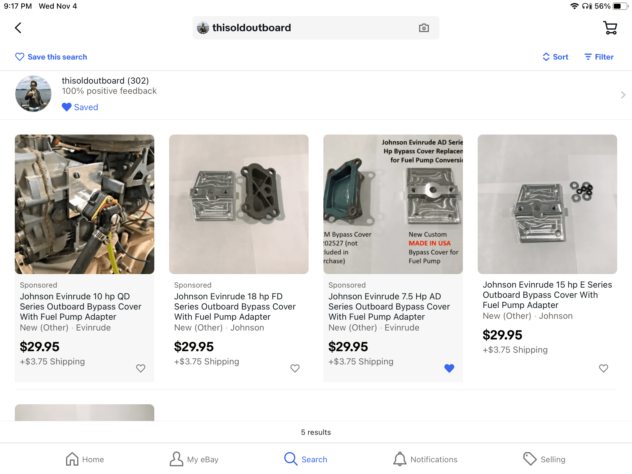

              They have EBay seller that makes intact port covers with fuel pump mounting for the OMC 1950s 7.5hp, 10hp,15hp, and 18hp Johnson and Evinrude motors. They are kind of similar to the ones FR use to make.
              I have not used this seller products but he has good satisfaction scores.
              https://www.ebay.com/itm/274366930896
