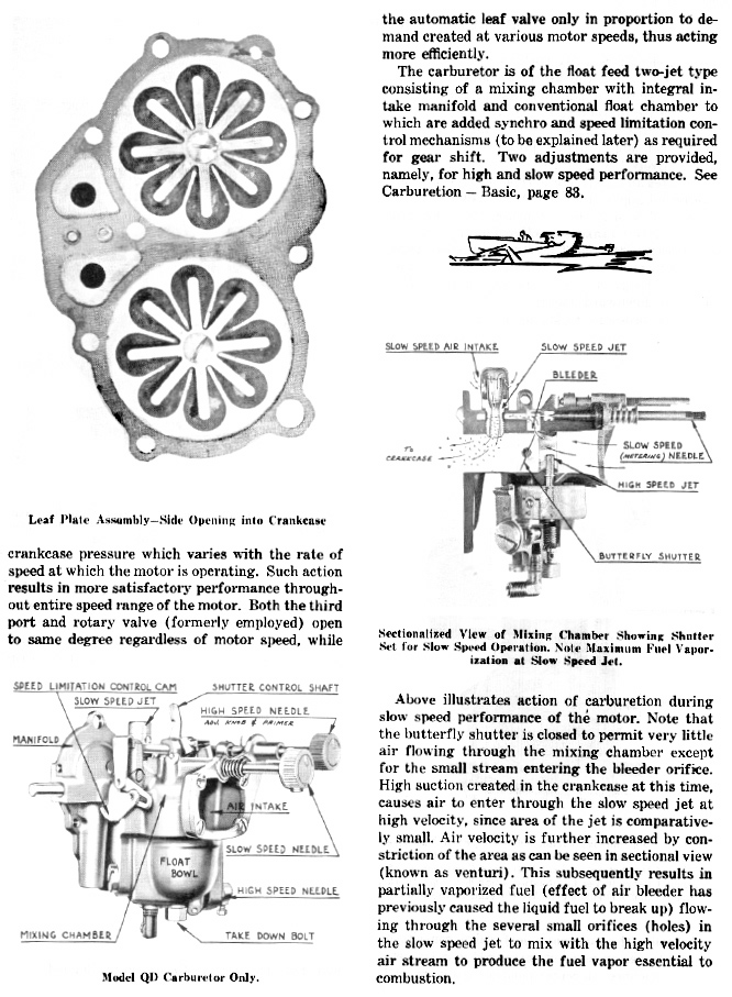

            #181556
              This may help –
