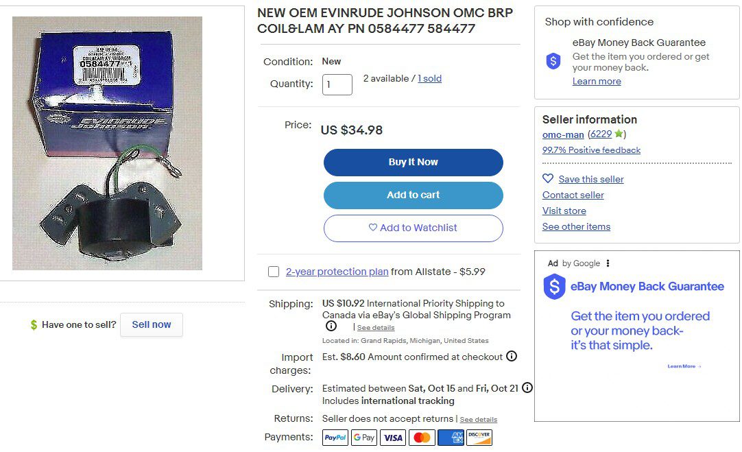

October 5, 2022 at 4:14 pm #267127
May be able to find an even better price if you spend some time looking.
Notice this price is for 2.

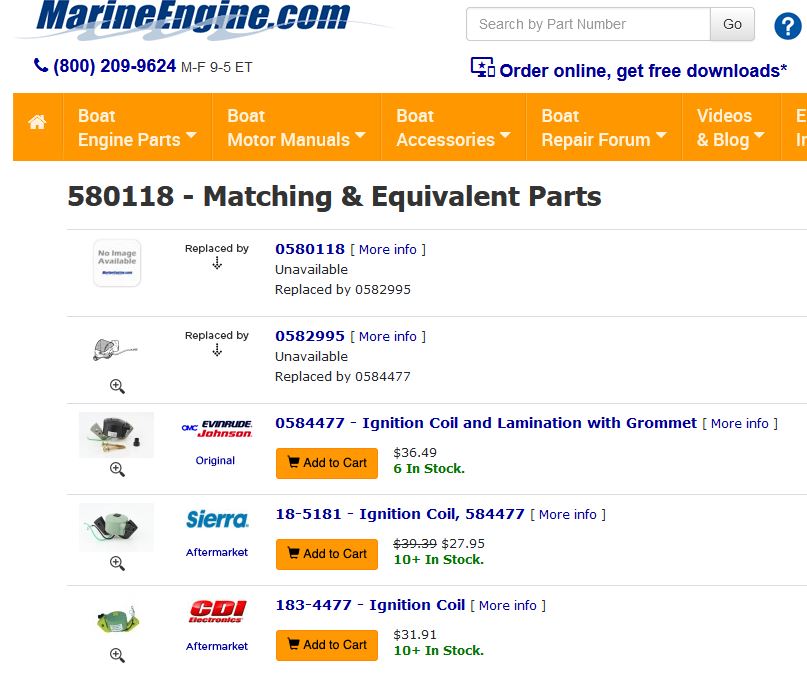

October 5, 2022 at 4:33 pm #267128Marineengine.com
October 5, 2022 at 11:36 pm #267145CDN $49 ==== > U$ 35
October 7, 2022 at 9:02 am #267197Thanks, crosbyman.
I have a QD 14 “Repair Parts Catalog” which says the part # is 580118. I have looked at Amazon, they refer to the same numbers you mention. I guess the new numbers have superseded what my book says. I prefer to get an OEM part, after having read the comments on aftermarket coils sold by amazon. Do you know if OEM part exists in Canada?
October 7, 2022 at 10:02 am #267199have you tried an Evinrude dealer if any around you ??
I have used lots of amazon ..coils and no issues except one pair I returned because the HV pin was bent.
