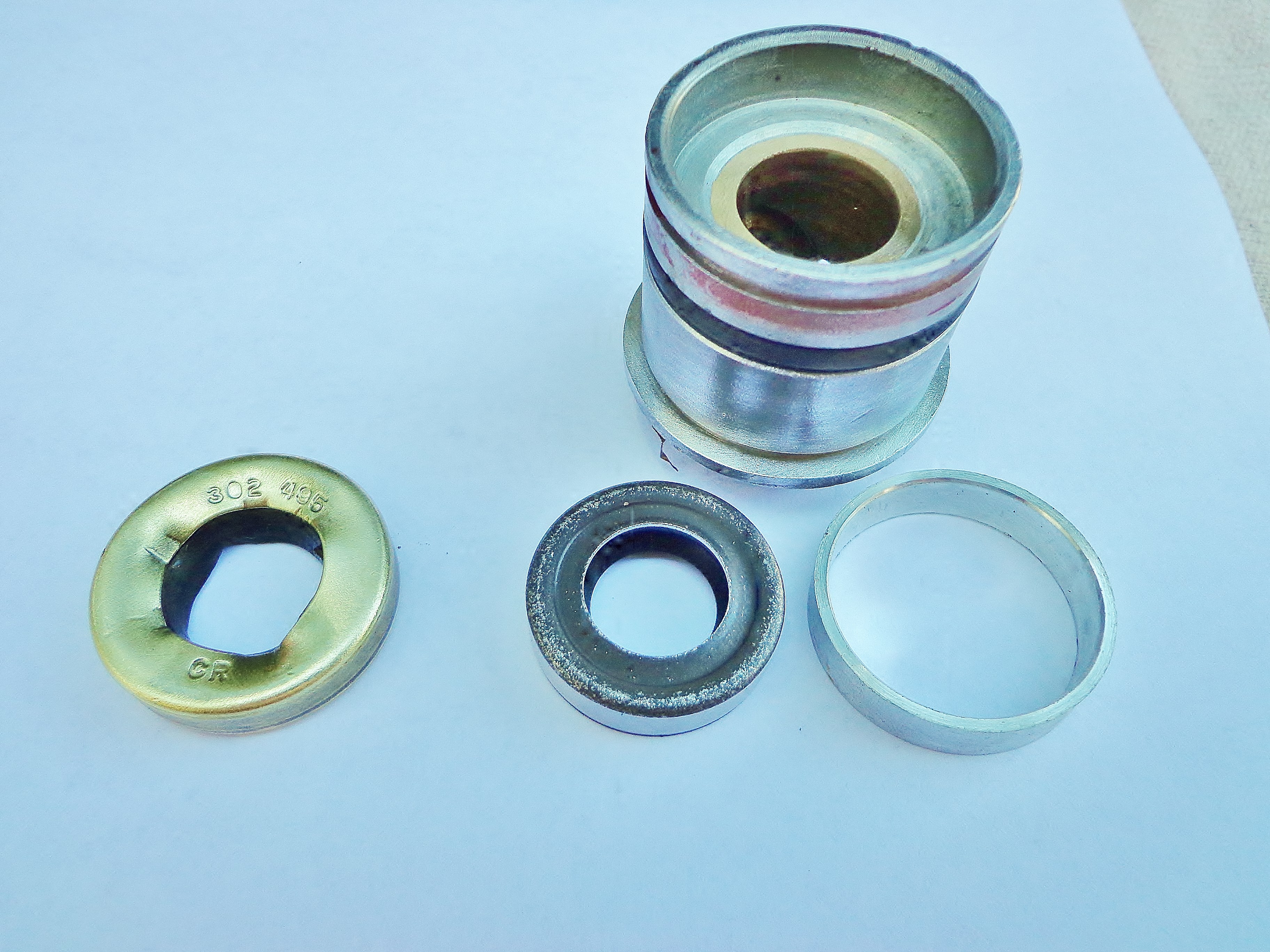

      I’m resealing the gearcase of my 1955 Johnson 10hp QD-16. It had the original brass C/R Seal #302 435 in it. I have not been able to locate a proper replacement for this seal. Does anyone have a source for this seal? The prop shaft measures 0.622 on the sealing surface, the bore is 1.250 in the bearing carrier and the seal is 0.312 wide to fit the pocket depth. I do not want to put a carbon steel seal in it. I want brass or stainless steel. The only seal I have found that is close is for a 0.625 shaft and a 1.125 bore with a 0.312 pocket depth. I could make a reducer bushing for the bearing carrier to allow me to use the smaller diameter bearing but would rather have the proper seal if I can get it. I have another QD 16 that may need a reseal but I may think twice about pulling the prop shaft seal if it seems OK yet after 61 years. Wishing now I’d have checked this one before pulling it.

        You already suggested the solution I use—a reducer bushing and use the seal for later motors (1956-up I think but could be mistaken)

          #46797
            Here’s just what the doctor ordered. Easy to make and saves a lot of time searching for hard to find parts.

            fisherman6
              Thanks Mums. That’s exactly what I was planning to do if I couldn’t find the seal.

                  quote Mumbles:
                  Looks nice mumbles, but where did you find that reducing bushing?

                  ED
                    According to my parts book, the seal p/n is 302495 for the prop shaft seal. SKF 6280 or SKF 6925 will work. Upper seal part numbers are shown above. I have both.
