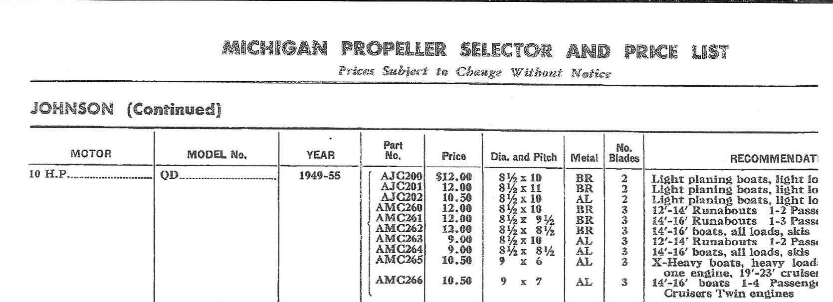

            Membership has access to the “Inner Sanctum” which has all the Michigan Wheel (prop) catalogs.
            Here is a copy of 1955 catalog for the QD
            Michigan
