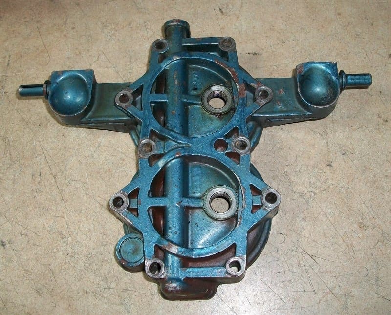

      Steve D
        Shouldn’t be an issue Nick. That cylinder head, if it’s like the one from my ’57, will accept either an Evinrude or Johnson hood. I think all you’d need to do is swap the starter brackets.

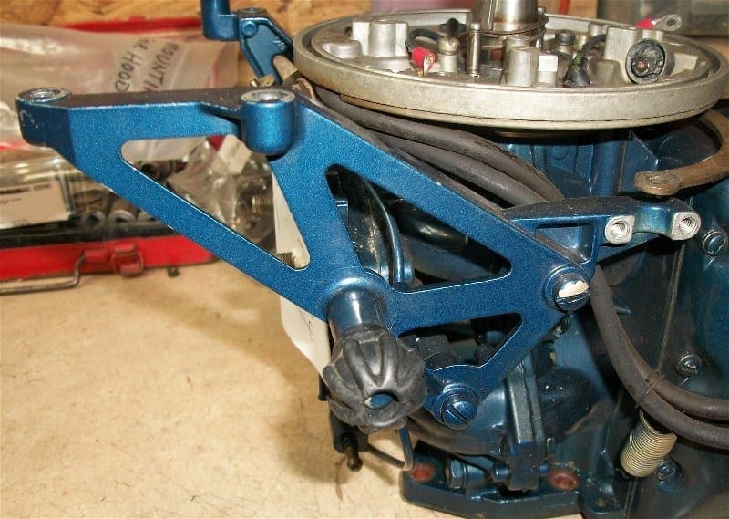

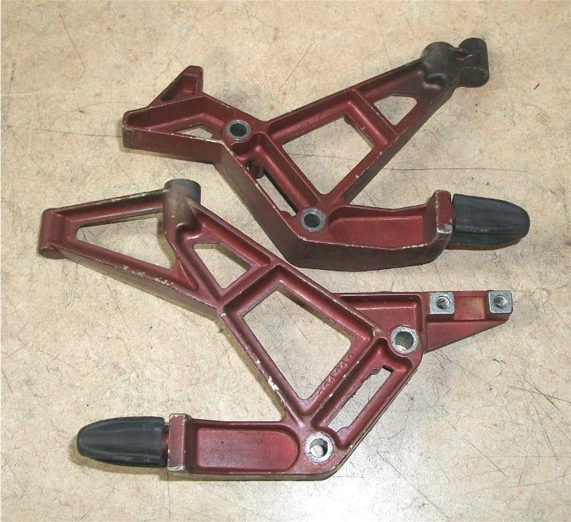

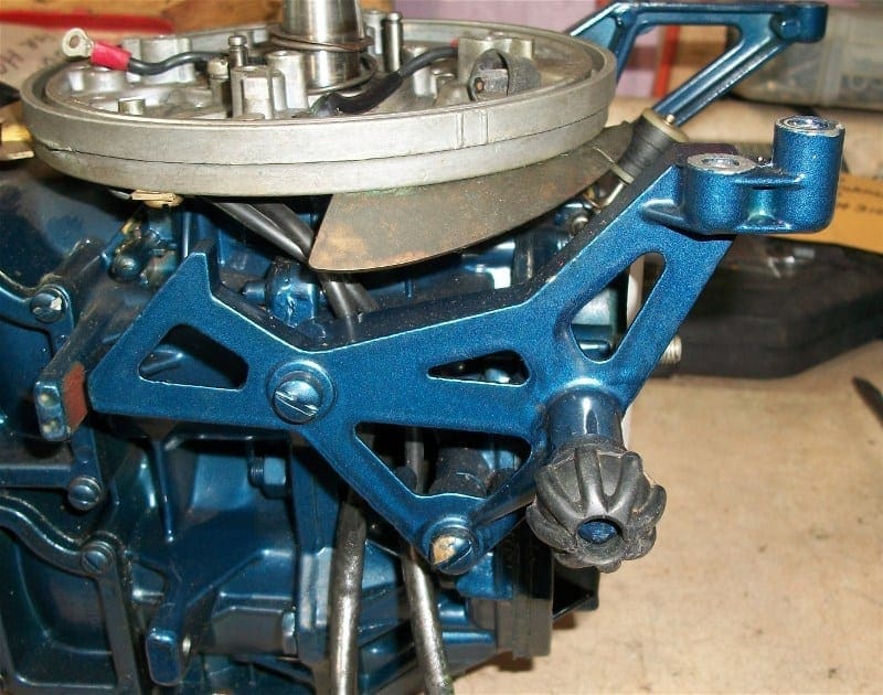

          Steve D
            That’s right Ben, you have to swap them based on the hood you’re using. The hood mounts on the brackets for Johnson 10 HP ’56-’58 are different than Evinrude 10 HP ’56-’58.
            johnson-10-hp-brackets
            evinrude-10-hp-bracket-starboard
            evinrude-10-hp-bracket-port
            #185058
            fisherman6
              Yeesir! That is the difference in the starter brackets. Those will have to swap. If the cylinder head has both features on it, that will work with just swapping the rubber bumpers. Thanks for posting the pictures, Steve!
