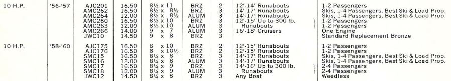

        Here  is a snip from the 1960 Michigan Wheel Propeller Catalogue showing the recommended pitch in relation to boat size and use:
        Snip-Props-2

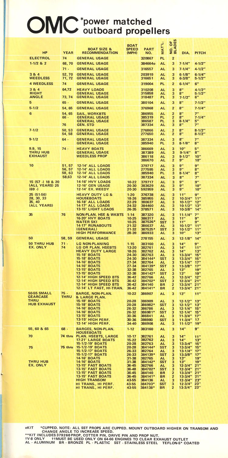

              There was a change in propeller hubs from a rubber shock hub to a “Slip Clutch” hub designed to slip under a certain overload as when striking a submerged object.  This would account for the differing part numbers.   Shear /drive material was changed also, with the slip hub having a stronger pin, usually stainless steel.  Props are interchangeable as long as the correct drive pin is used. This chart shows the newer  part numbers
              Propeller-Chart

                  Thanks all. I’ve ordered the 277595 that shows in the sheet from frankr. Should be here in about 4 to 6 days.
                  crosbyman: I sent the prop from the motor into a local shop and they were going to replace the hub and re-condition. This was the weedless version from an older motor (1954 stamped on the outside). When trying to push the old hub out, the internal bore shattered.
