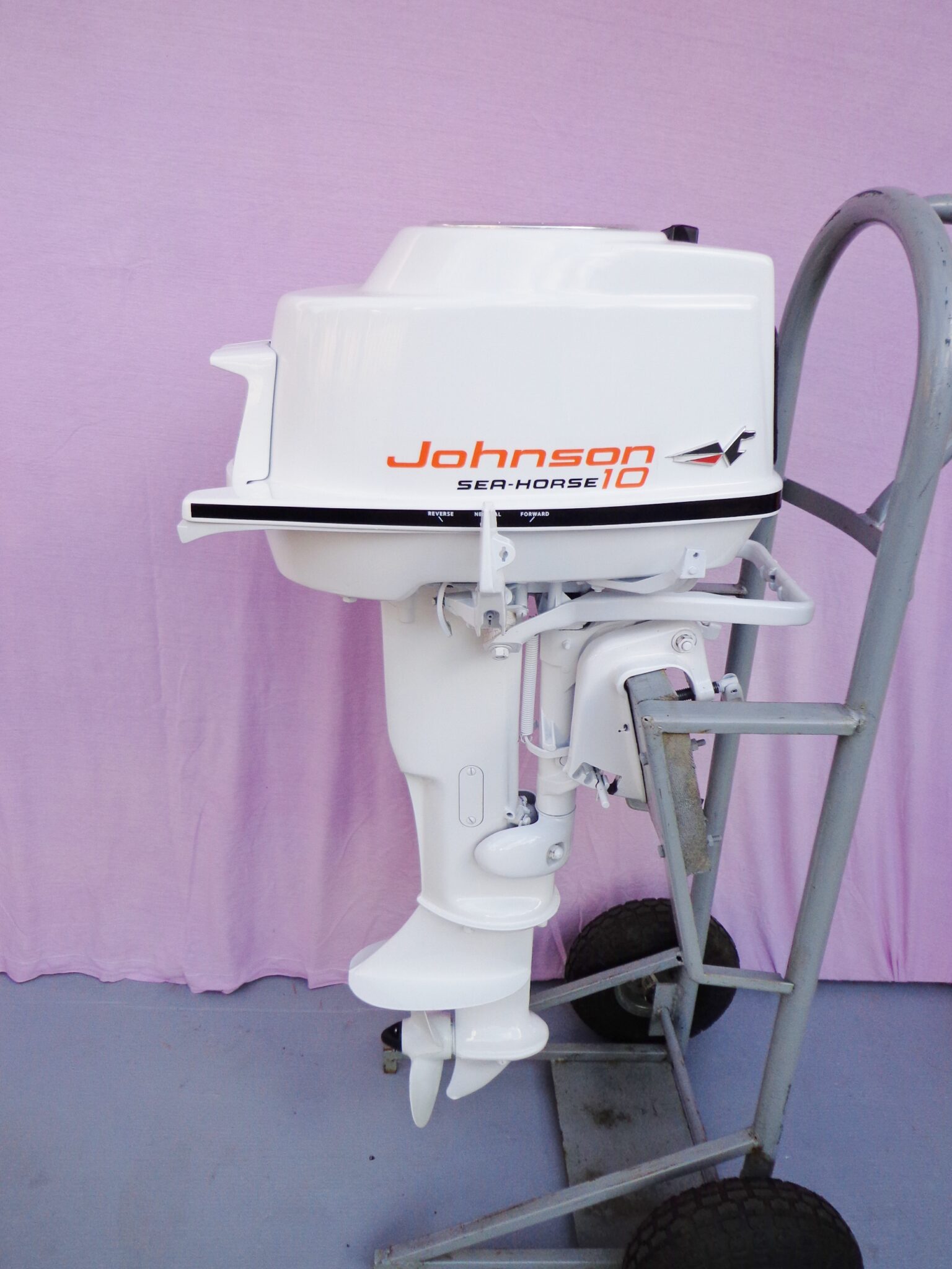

                  Compression numbers would be good closer to 100 PSI.
                  Your ’59 QD-20 should look like this one, with a single chrome ring on top of the hood.
                  DSC01208

                  #267619
                  elgin2
                    That’s it. Got it at a auction for $2.
