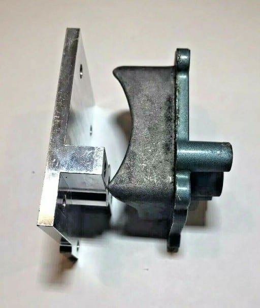

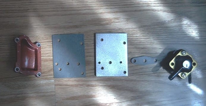

        If no one comes through with an original you can make an adapter plate similar to the one in the 1st picture (I believe courtesy of Frank R. back in the day).

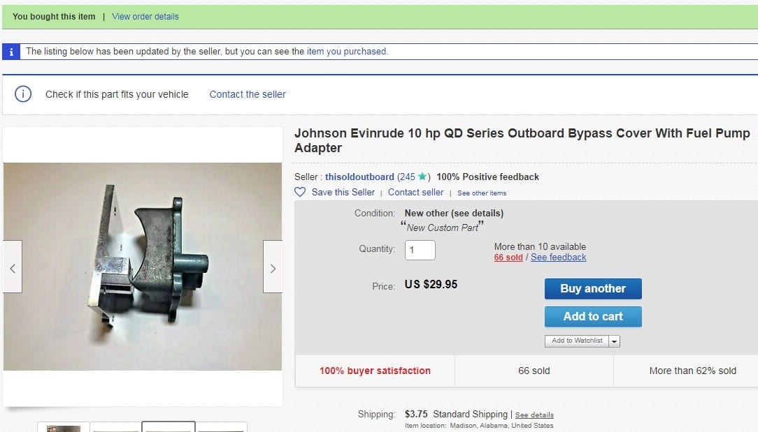

        Also someone on ebay is selling fabricated ones. I recently bought one, haven’t tried it yet but looks to be able to do the job just fine. https://rb.gy/zpeaem
        Frank-Robbs-adapter-plate-bypass-cover-for-fuel-pump

          Anyway amuller, if no one comes up with an original you could make an adapter plate similar to the one in the 1st picture (courtesy of Frank R. I believe back in the day before he retired from making stuff).

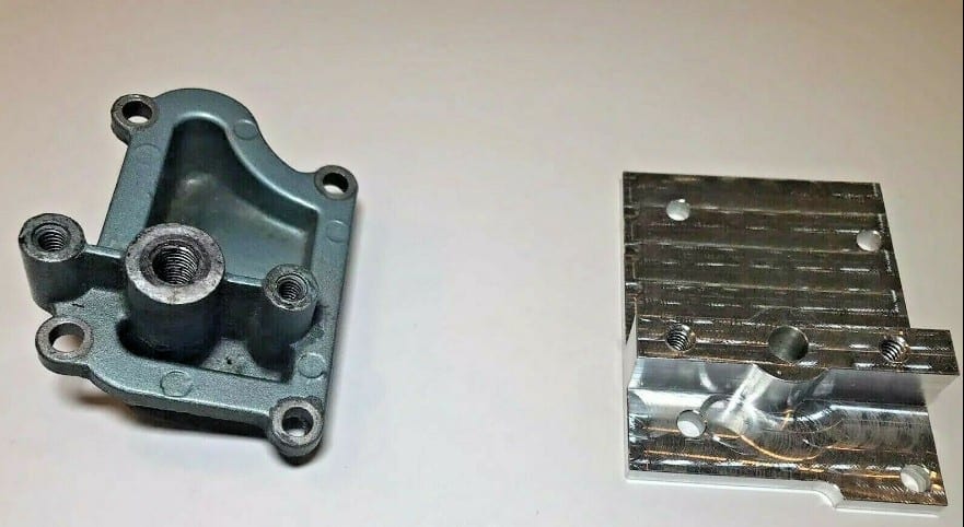

          Some guy on ebay is also selling a fabricated version that I recently bought but haven’t tried yet. But it seems to be able to do the job just fine. I won’t include the link this time, just the screenshot of the page and if you want it you’ll have to search for the item manually.
          For anyone reading this he also makes them for the 7-1/2 HP making it much easier to convert those to a fuel pump, rather than having to go in behind the manifold and mess with that.

              That milled version is very interesting. Does he say to mount it on top of the bypass cover, or in place of the bypass cover? If without the bypass cover, you won’t have the deflector. Will that harm performance? Very interesting.
              I can still make one of my adapters, if somebody sweet-talks me enough.
              #209076
              Steve D
                Good question Frank, didn’t think of that. He says in place of…not sure if or how that would effect performance. If I have a chance to mount it on one of my motors and try it out before the end of the season I’ll post back.

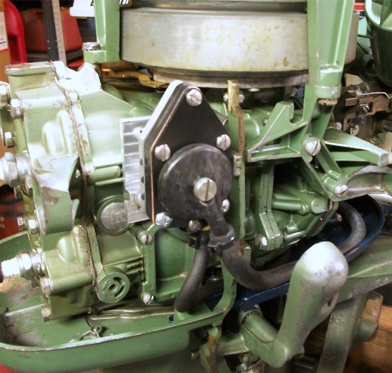

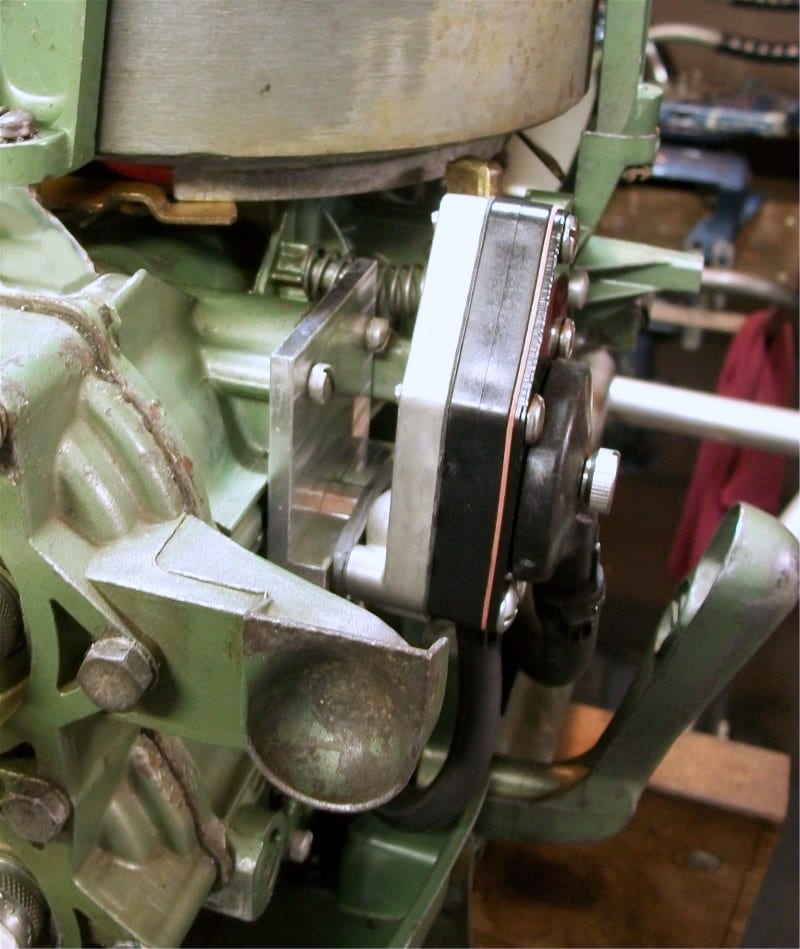

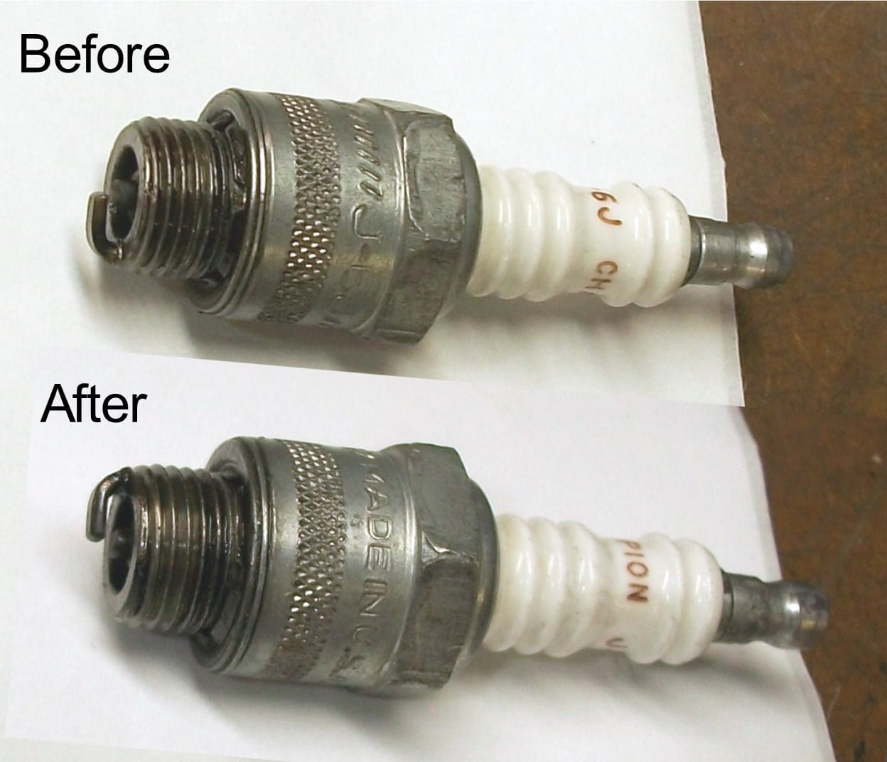

                        Ok, so curiosity got to me. I installed the plate on my ’55 Johnson 10 horse, and took it out yesterday. This wasn’t an extensive hours long test. Just an initial test to see if this plate would have any immediate negative effect on the way the motor ran. I would have to say it did not. Maybe if I ran it longer, or tested on a bigger motor there might be, I don’t know. I looked at the top plug before and after and it looked to be burning about the same, maybe only slightly wetter?.
