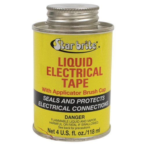

            #282648
              Wouldn’t  using shrink require cutting the terminal off and installing a new one?  Liquid tape would be much easier.
              liquid-Tape
              #282656
              BRENT BERGEN
                As long as the smallest diameter heat shrink tube that just fits over the terminal is used, the heat shrink tube works great. No need to remove and reinstall the terminal.
                Regarding the liquid electrical tape, that works too. It’s just a matter of preference. Just don’t try using both together. The heat from the heat gun will melt the liquid electrical tape.
