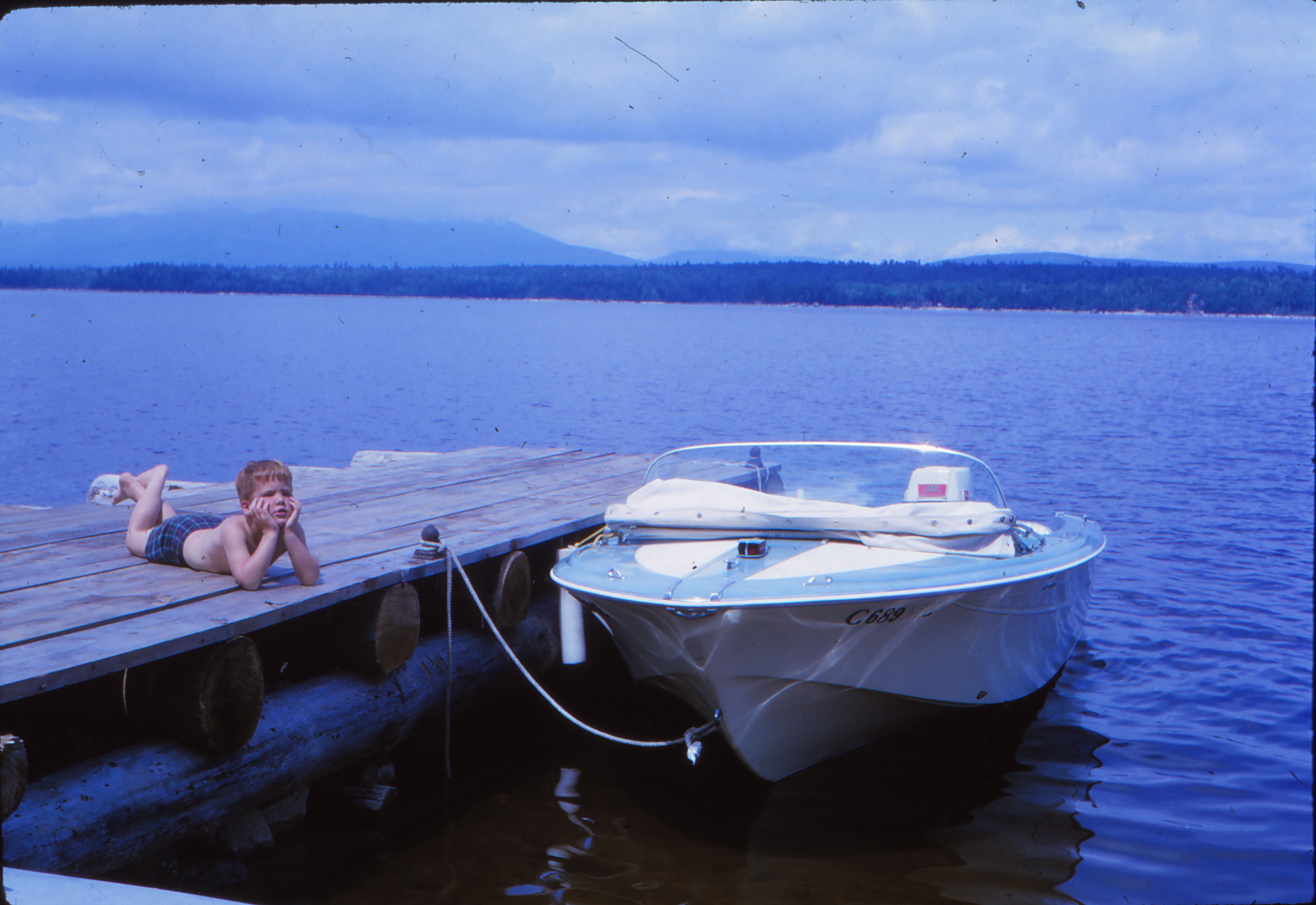

Really, a pleasure to run them.October 9, 2016 at 12:27 pm #45493October 9, 2016 at 12:59 pm #45498Nice pic! I had the same boat/motor combination back in the day. 14′ Glasspar Marathon with a 1960 40hp Lark. We replaced the 40hp with a 1964 Sportfour 60hp. That was a big and heavy motor, and didn’t perform much better than the 40hp. Should have stuck with the 40hp on that boat. I’d look for a ’64 Lark.
