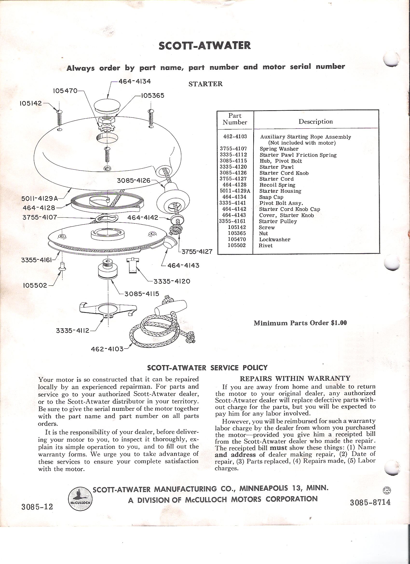

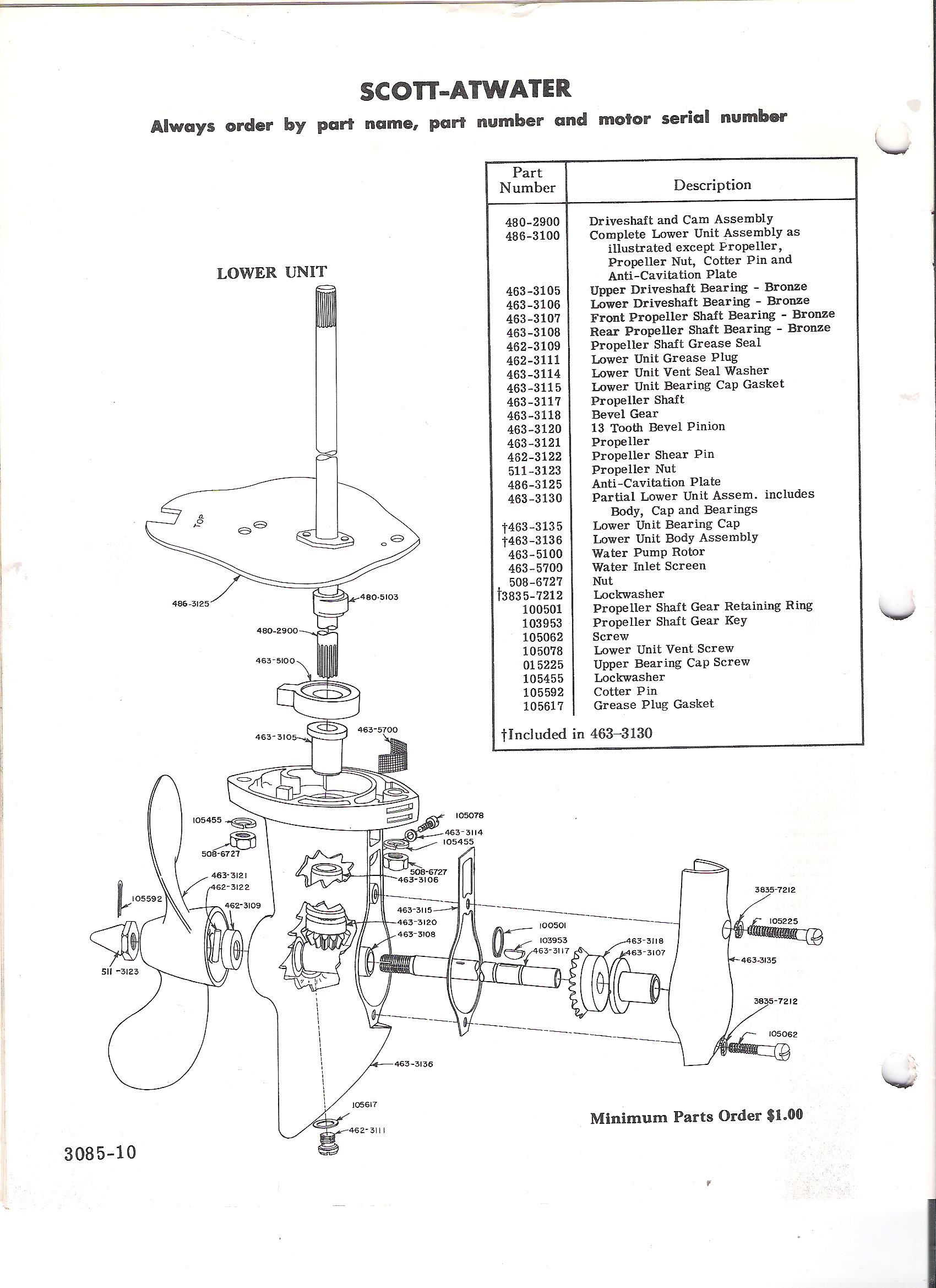

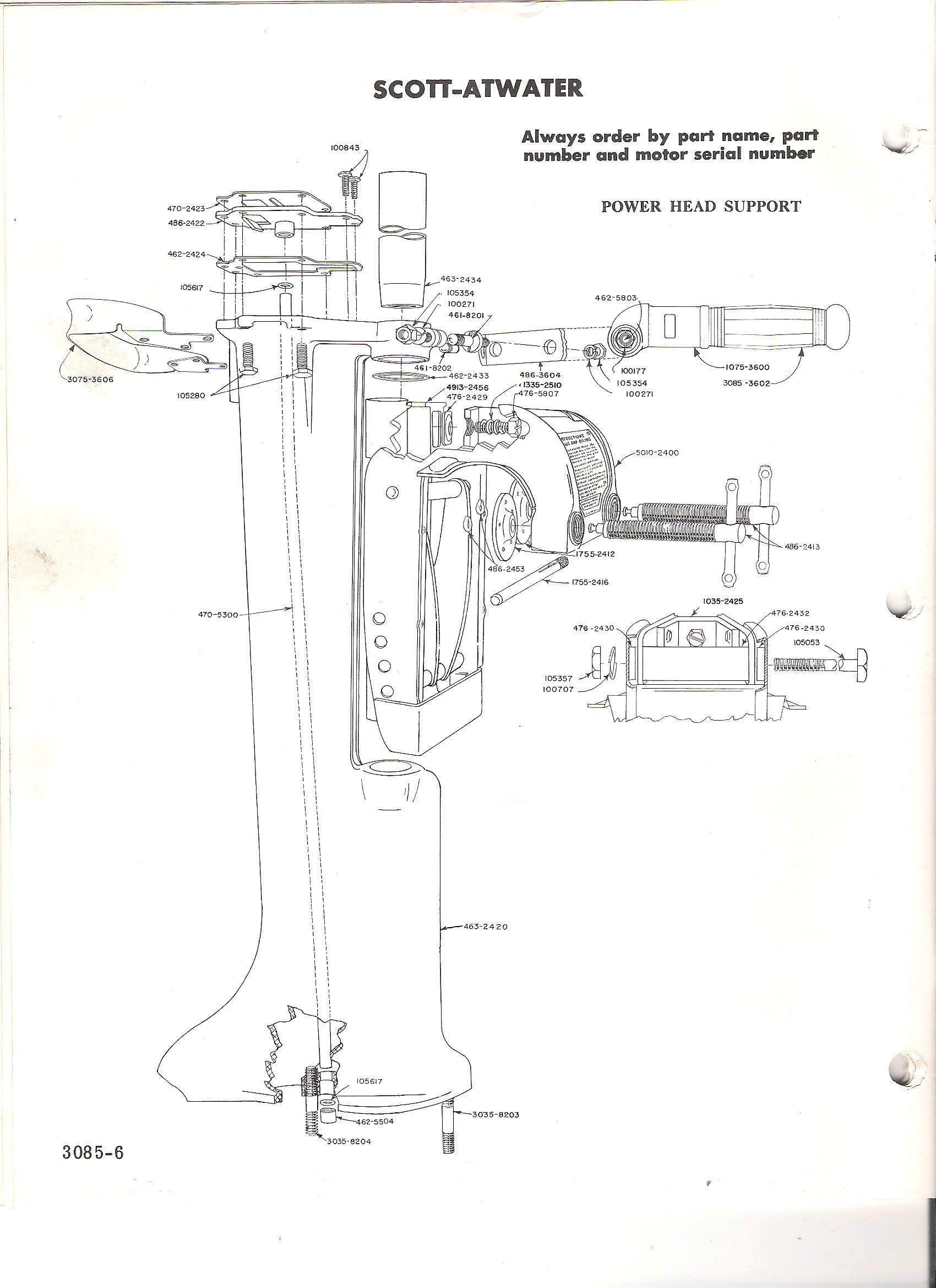

October 18, 2016 at 1:10 pm #46051Nali, if you PM me your email address, I can send a comprehensive digital Scott Atwater service manual.

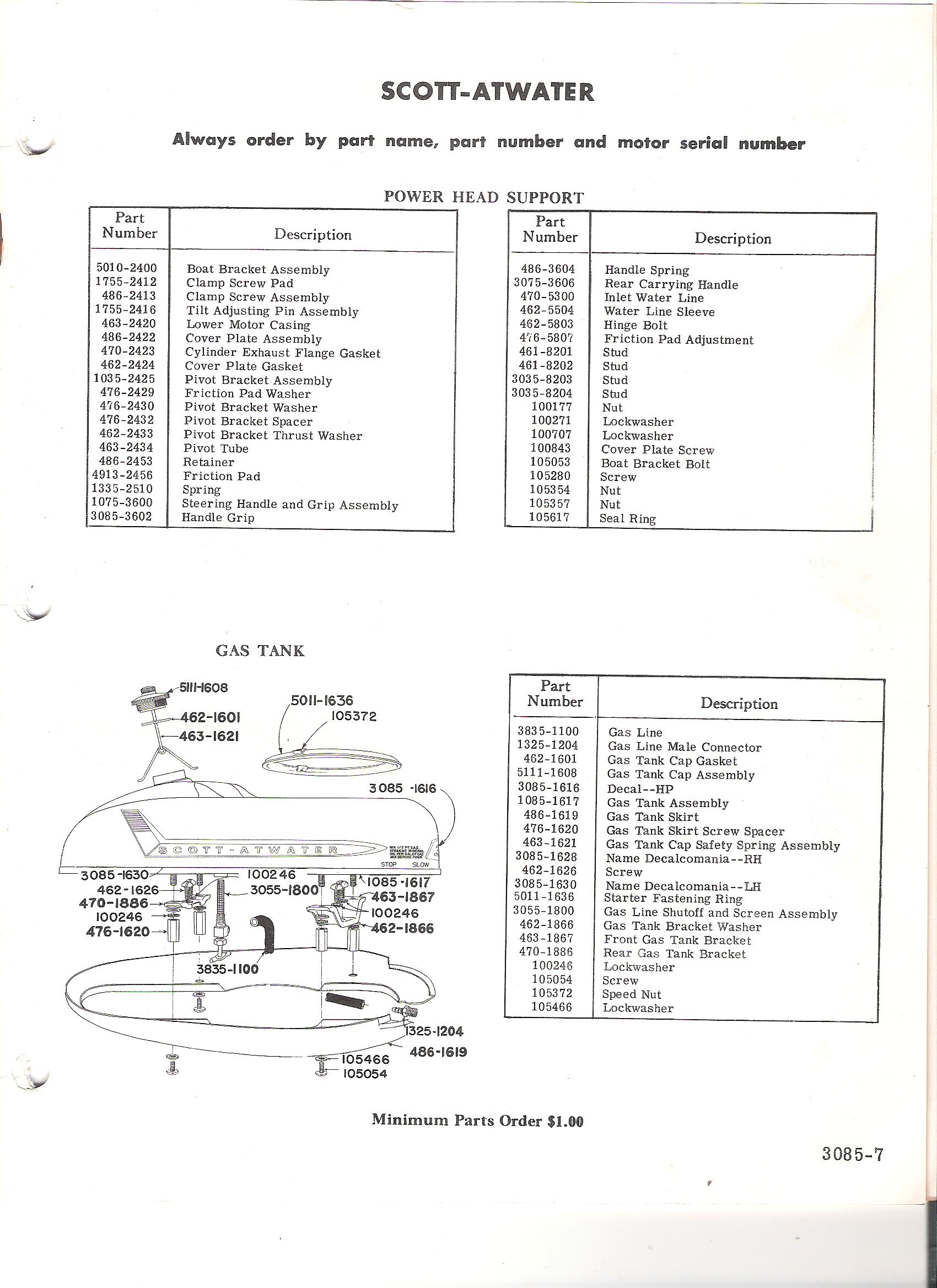

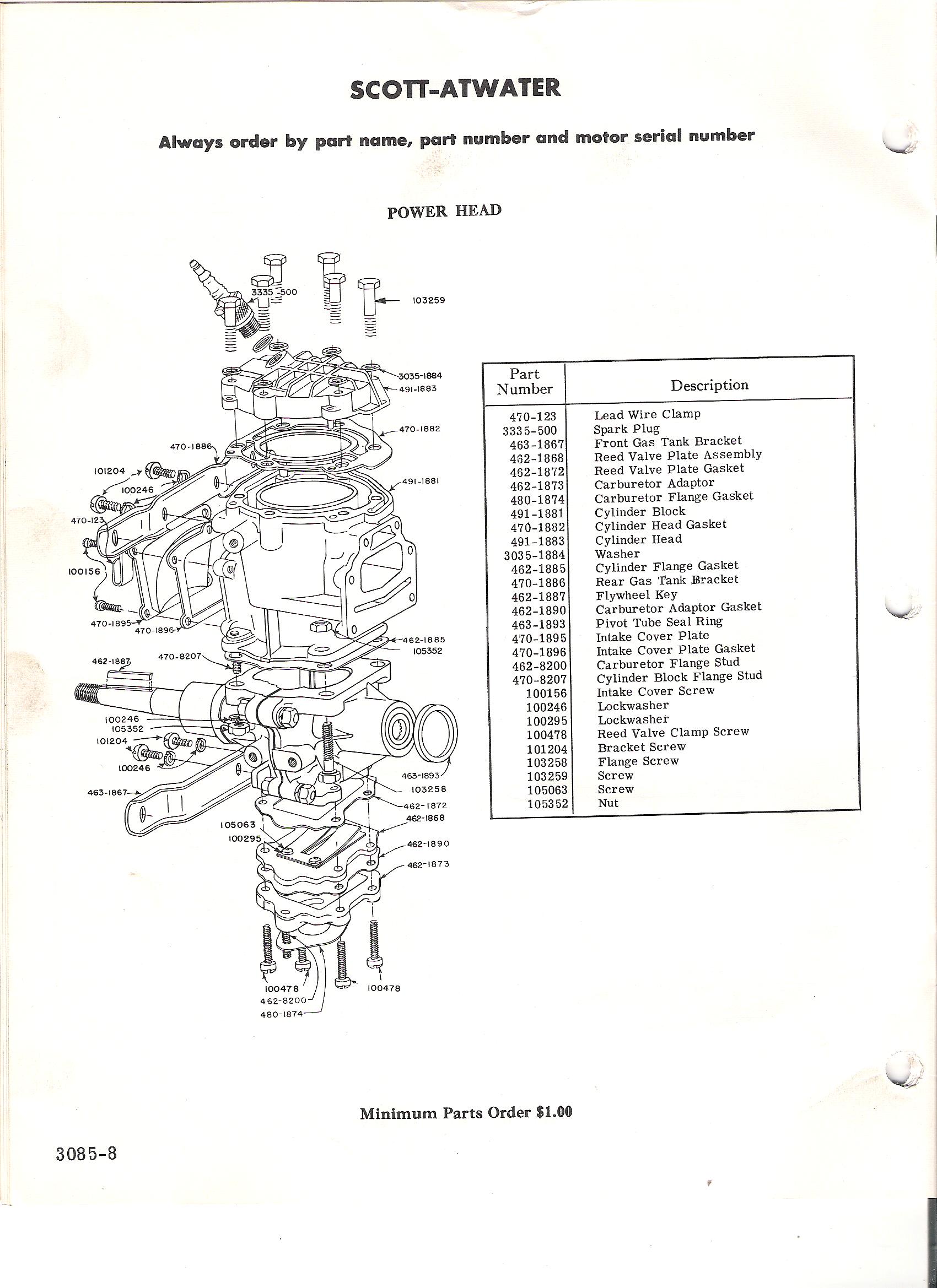

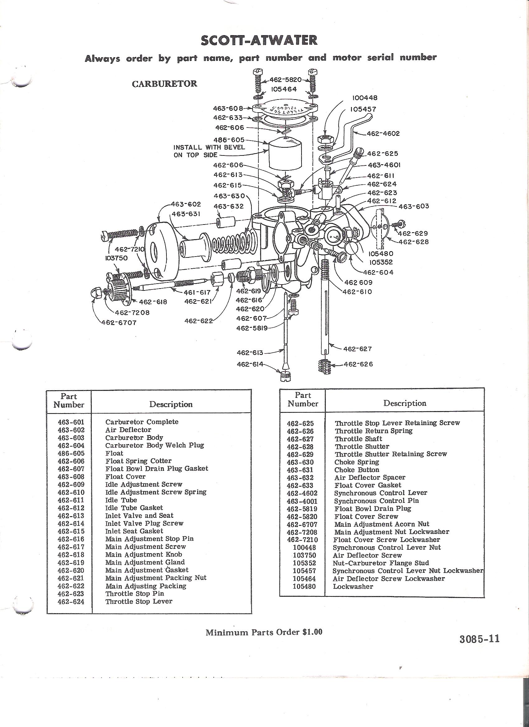

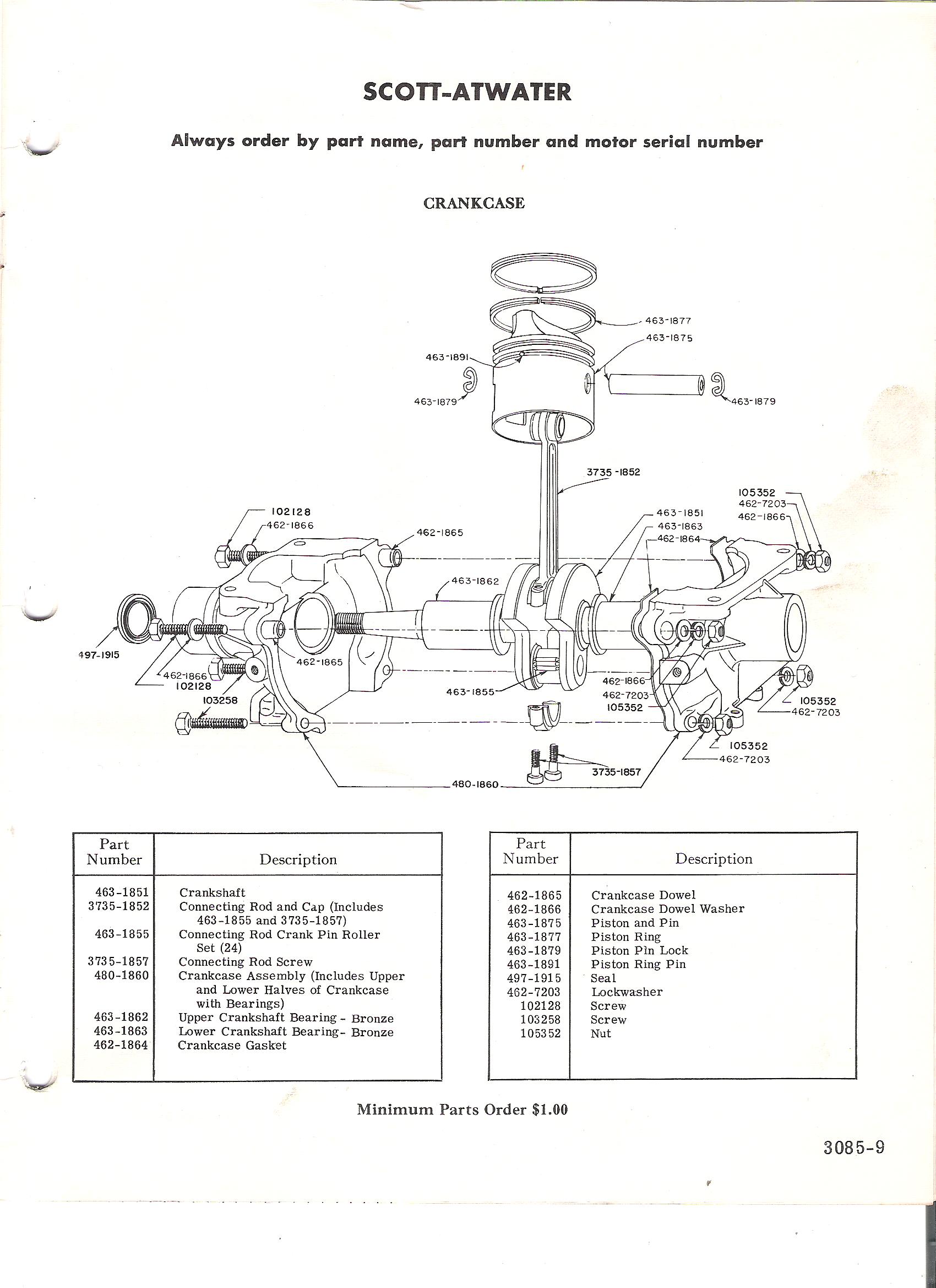

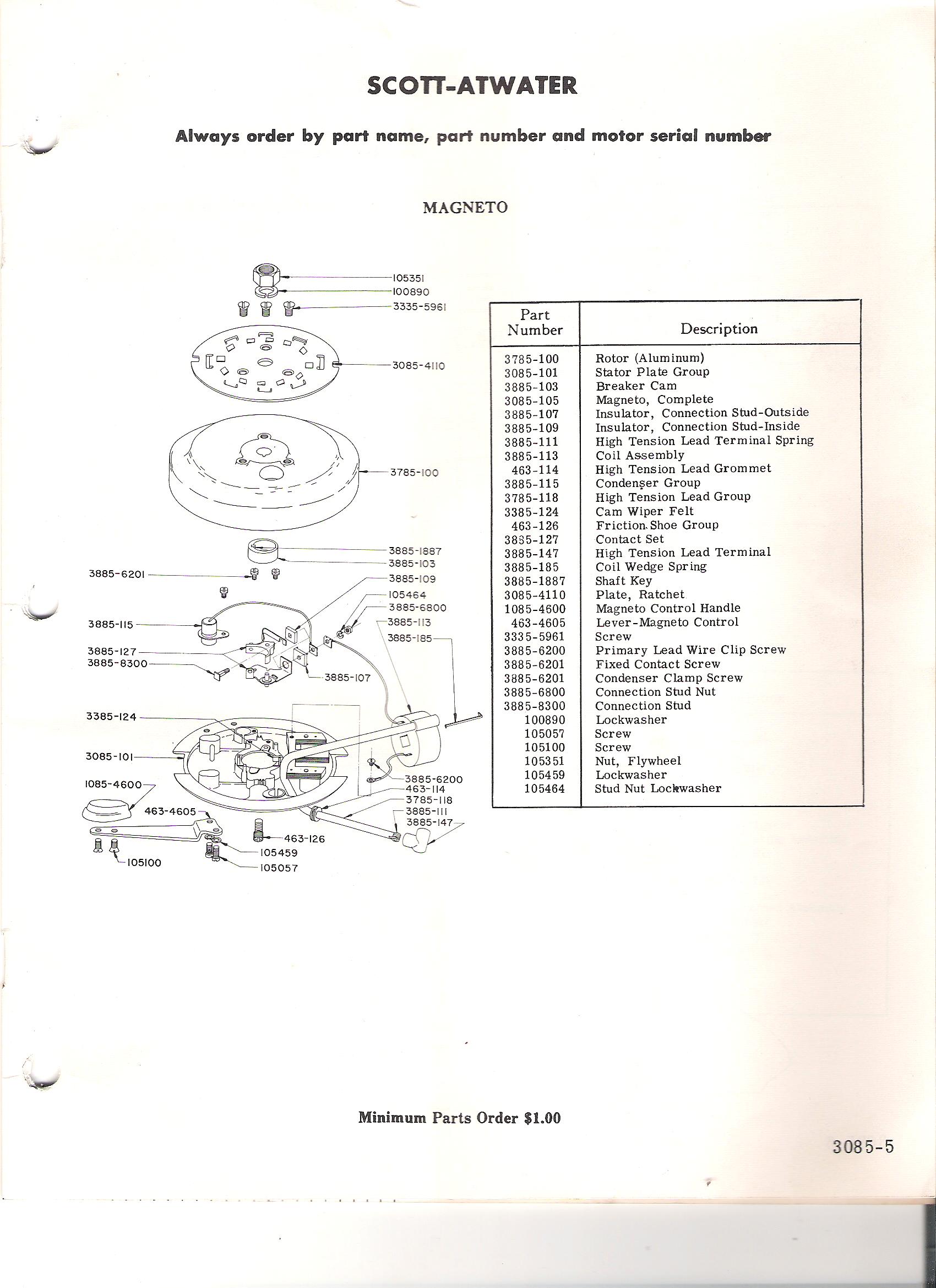

October 18, 2016 at 5:09 pm #46063Thanks for the pictures Wedgie !
I also found a pdf here :
https://www.fiberglassics.com/library/Scott_Atwater########

Thanks for the link FranckR.
I will order the gasket from them, and maybe some other parts..########
cajuncook1 : done. Thanks.October 18, 2016 at 8:01 pm #46066Anonymous

October 18, 2016 at 8:58 pm #46068wedgie, would it be asking too much for you to post the powerhead support and magneto pages from that parts book you just posted?
