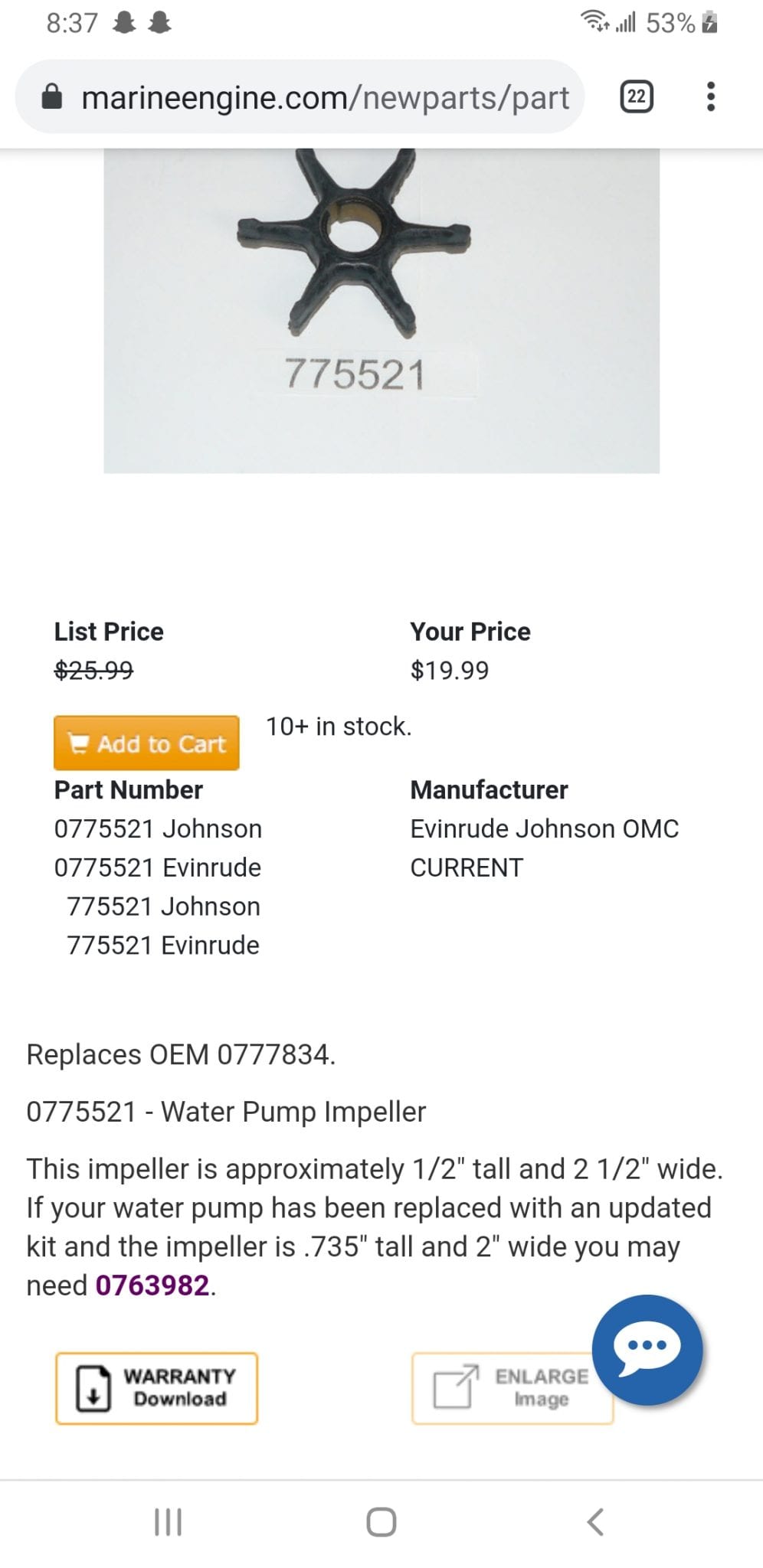

          trex014

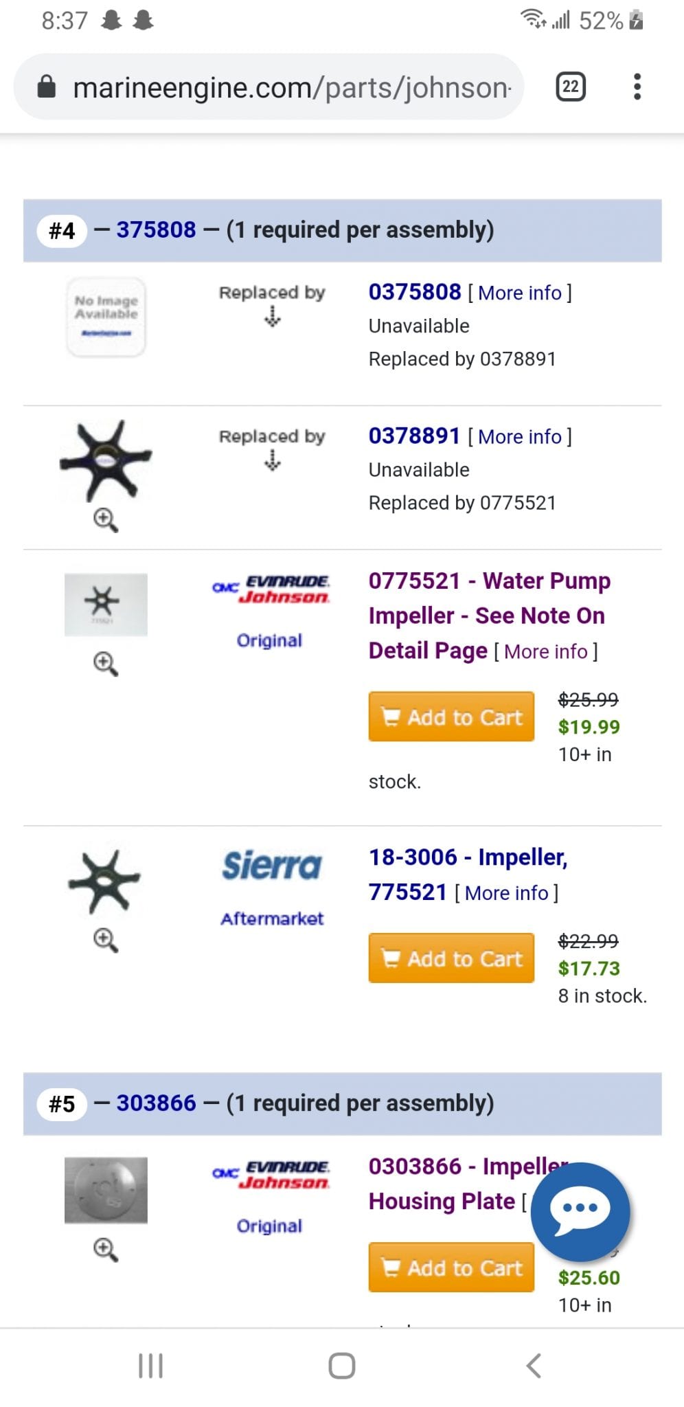

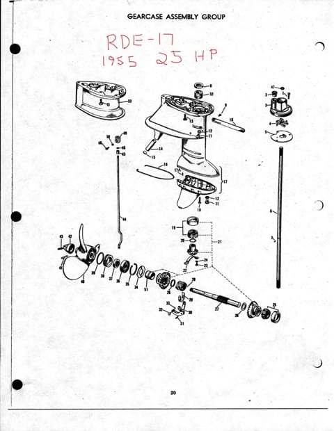

            I am getting all this from MARINEENGINE.COM fyi. I’m working on a ’55 25hp though the earliest marine engine parts manual breakdown is a ’57 35hp which uses the same original impeller currently 0775521 and original housing 0303831.
            On the impeller page it says “see note” which mentions an updated impeller and water pump housing. Though it only gives the number for the updated impeller (PN# 0763982) but not a housing PN.

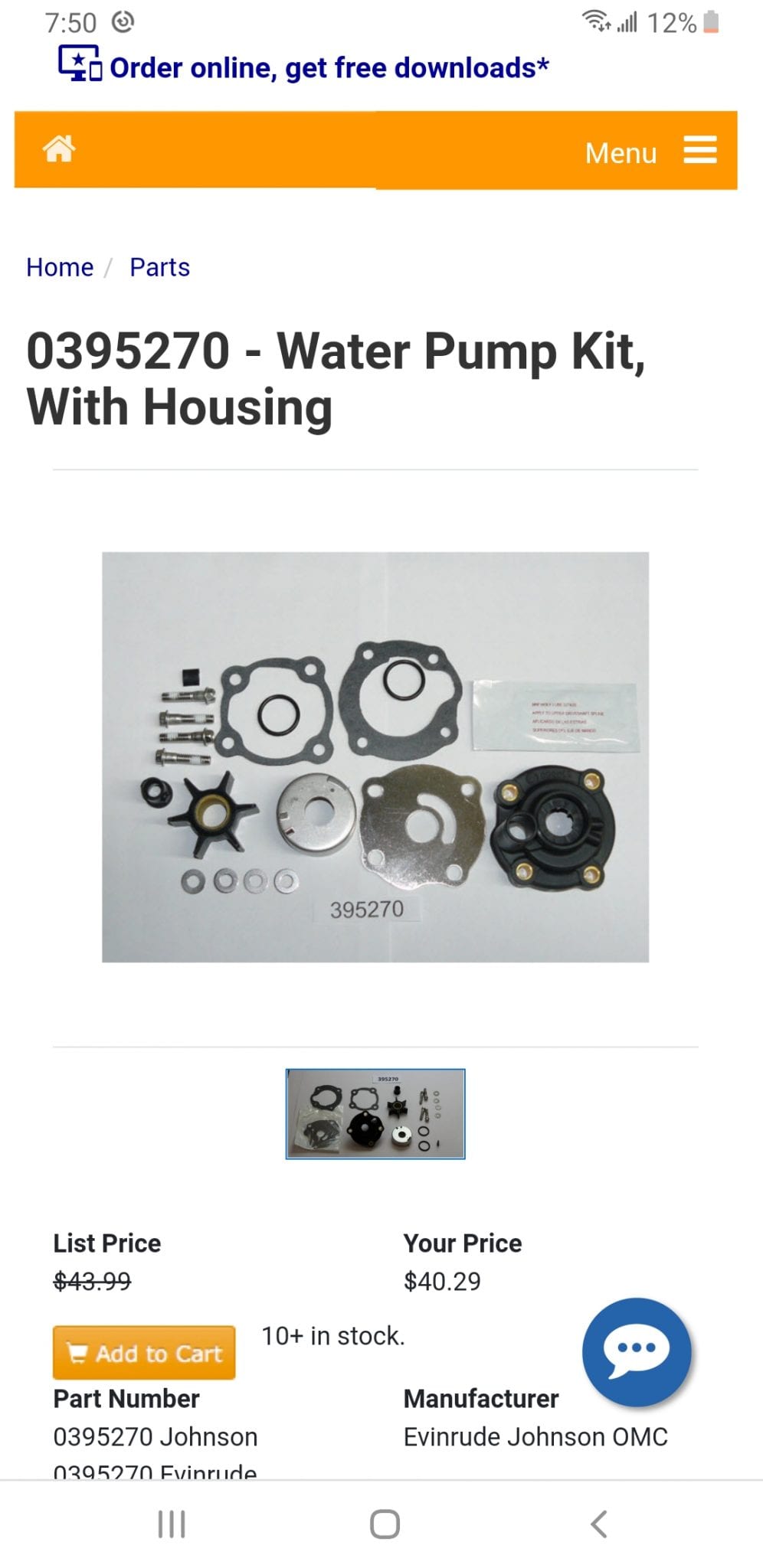

            If my digging is correct I believe the updated kit with housing is #395270. It is has the updated impeller as well. I believe this would fit the big twin lower units even though it has 4 bolts instead of the original housing’s 3. I cannot remember if those lower units are drilled and tapped for that 4th hole.
            Screenshot_20201224-203723_Chrome
            Screenshot_20201224-203714_Chrome
            Screenshot_20201224-195024_Chrome
            #225919
              I think I know what’s going on here with the ‘updated kit’. The 763982 impeller is used in ’78 and later 25-30-35 horse motors along with the plastic four bolt housing in the 395270 kit? That impeller might use a wedge style drive key so some filing might be necessary on the ’55 driveshaft to get it to work.

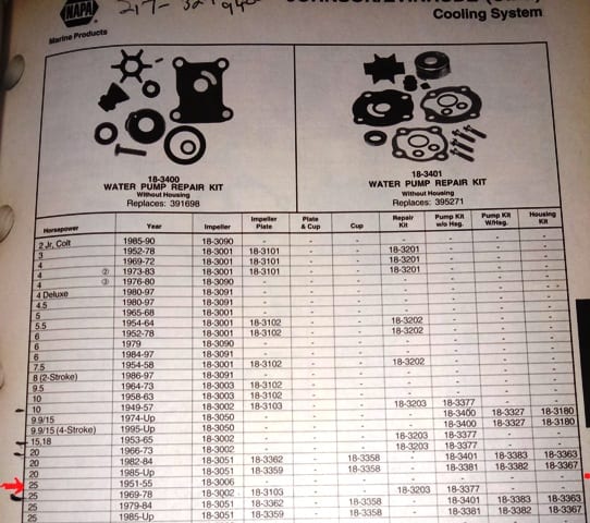

                outboardnut
                  sierra 18-3006 is the impeller only
                  this is from a 1999 Napa catalog
                  napa-1

                  #225933
                    That is true for the original pump. But I thought the question was for the new style pump kit with plastic housing and stainless steel liners, if one exists or the RD models.

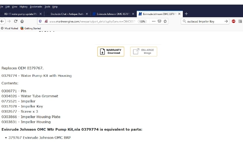

                      I do believe Mumbles is spot on about complete kit (0379767 / 0379774 )
                      except – I do not remember ever running across 317078 – Impeller Key
                      Marine-engine-page0001

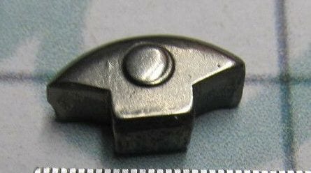

                        Impeller Key 317078
                        317078-keyway
