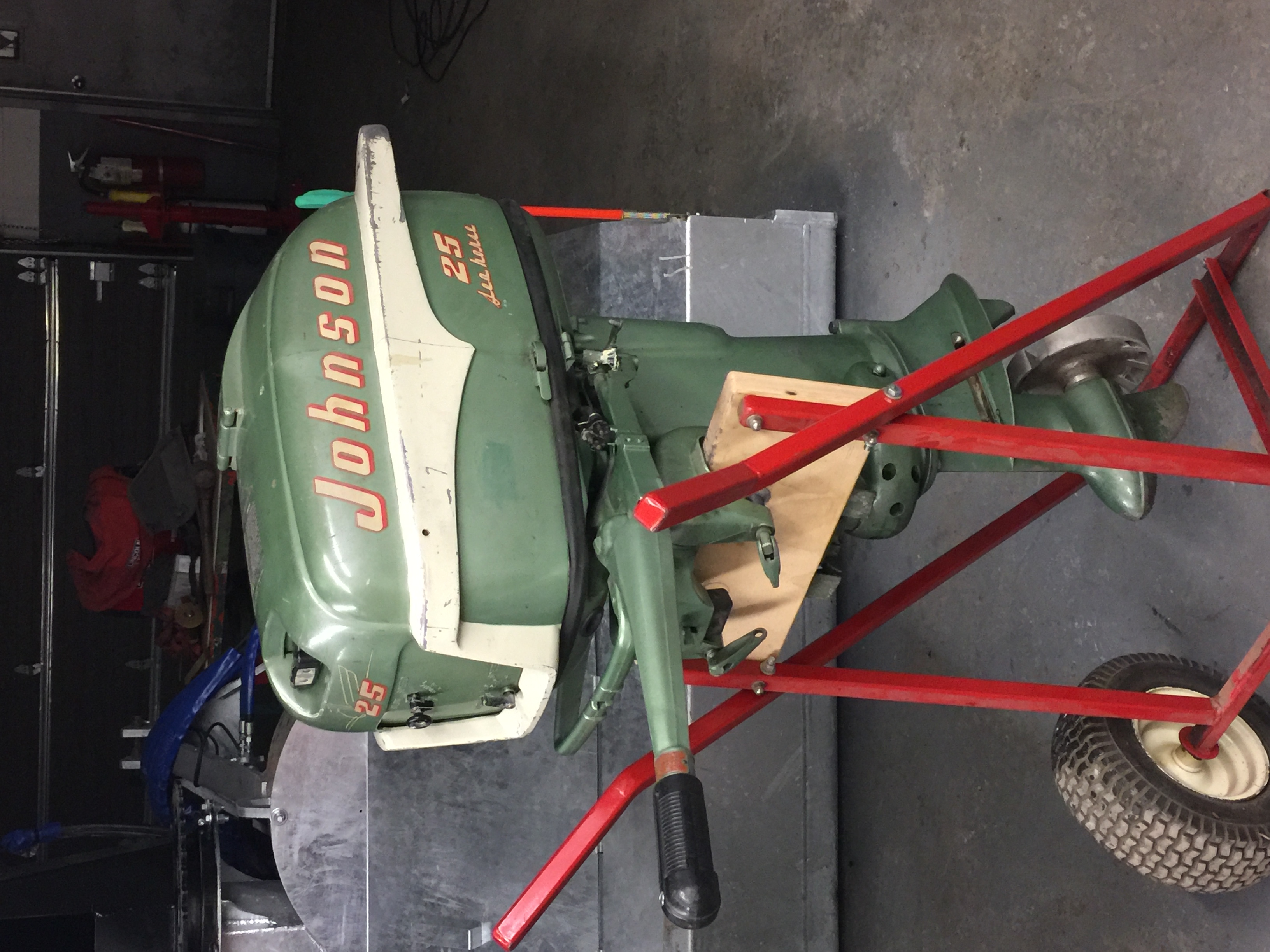

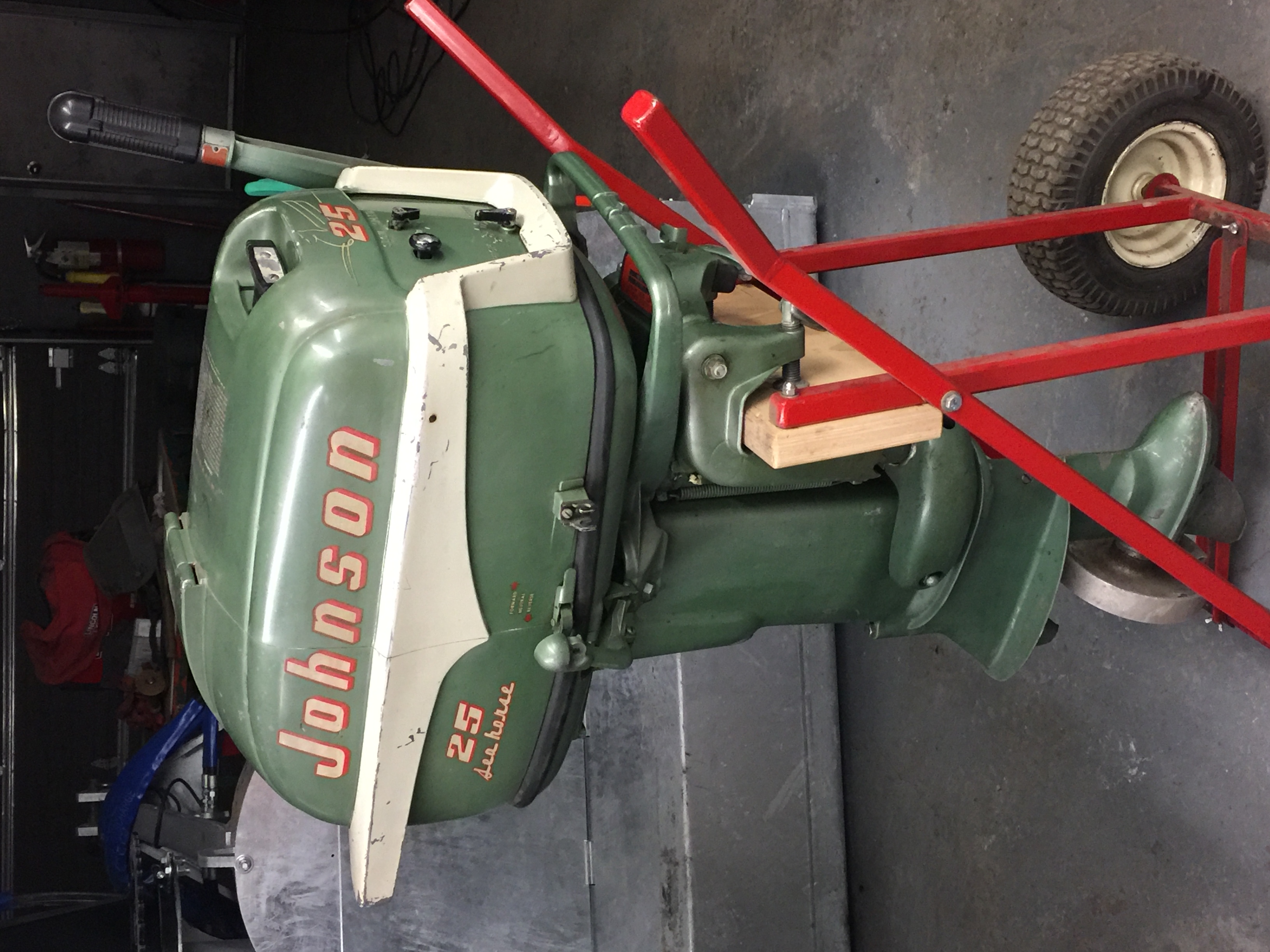

A few weeks ago I was cleaning up the shop and looked at a cowl and though "hmm, that’s a bit too nice to repaint." So what does any responsible outboarder do when they have a nice original cowl, but no motor…..dig through the parts bins. After rounding up the appropriate parts, I assembled this RD 17.
The Powerhead was assembled from good used parts, bores honed and new rings. All seals replaced
Today I put it in the tank for a run. It starts and runs well. It seems to run rich. It was running best with the low speed open 1-1/4 turns and the high speed was only open 3/8 to 1/2 a turn. It seems to me that most of my other motor take about 3/4 to 1 turn out on the high speed. The needles on this one are good. After about 15 minutes of running. The plugs came out very wet. It also seems sensitive to throttling up, and sometimes has to be leaned out and then richened or it will drop a cylinder.
I was testing in a cold garage (5 Celsius) and the water was also quite cold, but what puzzle me is how much fuel it is getting with the high speed almost closed. The carb does not overflow, and it pumps up and holds pressure against the tank primer.
What would you check first?
