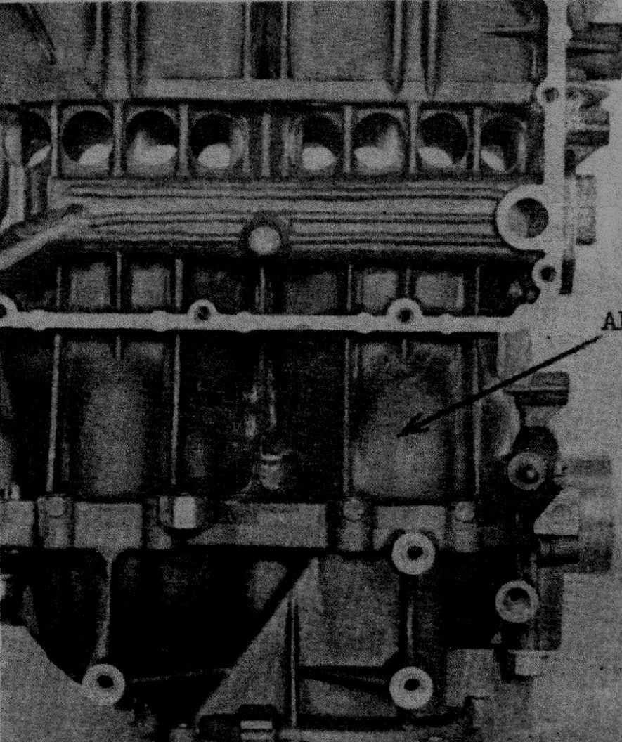

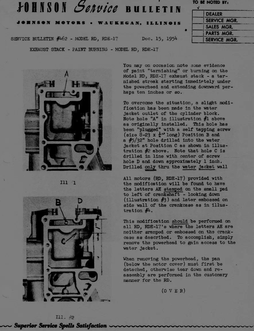

            Yes, I would definitely have a closer look before condemning it.   Is the paint on the block discolored, if so that would indicate an overheat.  It is possible that someone ran it light on oil, or perhaps the rings are stuck.  Or, like you say, the readings might just be low because the engine has been sitting.  What are the current compression readings?
            #268624
            outboardnut
              paint-burning-1-of-3
              paint-burning-2-of-3
              paint-burning-3-of-3
