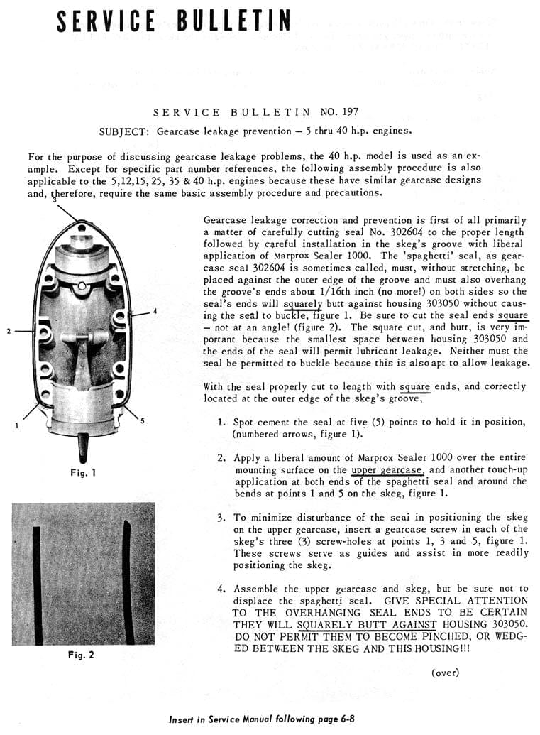

        #177666
          I have this info.
          Service-Bullitin-197-Gearcase-Leak-Prevention-5-thru-40hp

            I did pressure test it. Thats how I found the leak
            I have that same bulletin
            The leak is where the two half’s and the large O ring meet
            #177682
              Well at least you confirmed what we’ve been preaching all these years. The parts are not to be mixed.
