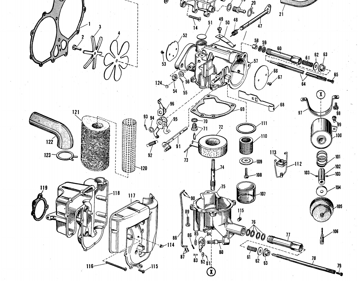

                Refresh my memory please…….. Is the carb’s low speed circuit fed
                through (and shared with the high speed circuit) the center nozzle,
                or through a passage in the carb bowl?

                  It fits on the bottom of the "fuel nozzle", #74. It’s not pictured in any of the parts catalogues until about ’60 or ’61 for the RD models. In most I have torn apart, there is installed a leather looking ring that is usually tattered and frayed pretty good. NOS ones are impossible to find. I put an o-ring on there, though I can’t remember who recommended it-maybe Frank or another knowledgeable source. I ordered a bag of 50 from mcmaster-carr. I’ll track them down and get you the number. Could send you a few if you like.

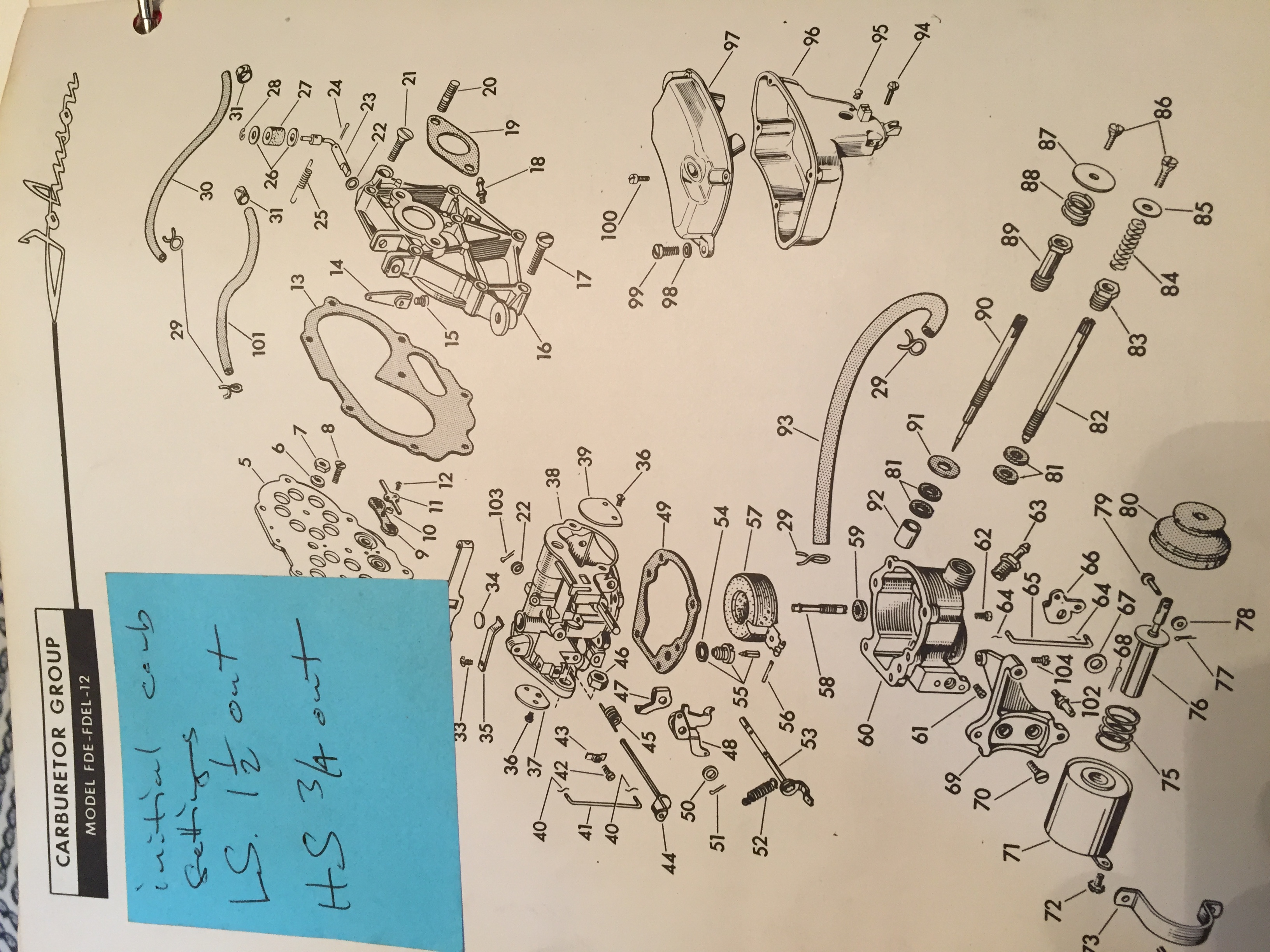

                  opposedtwin
                    Buc, here’s a pic of the gasket Ben is talking about. #59 in this catalog for a 1958 FD-12 (18hp). Hope you can make it out.

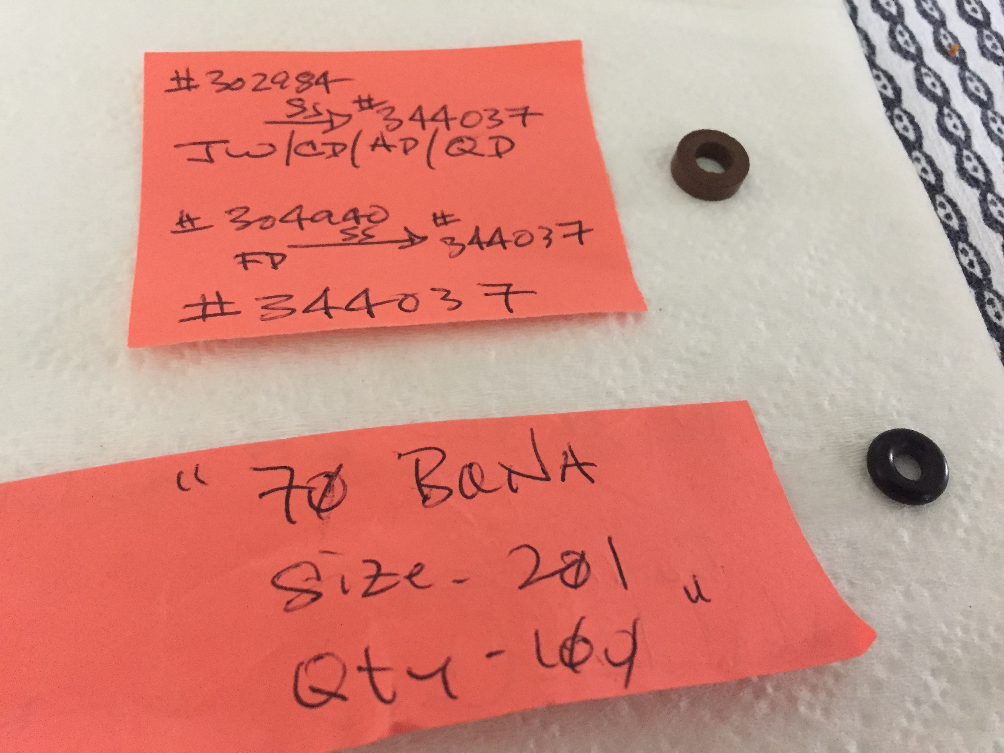

                      Top is a NOS gasket for jw-fd models. All the previous numbers superseded to #344037. It has square edges.
                      Bottom is the one I got from mcmaster-carr. "70 BUNA size 201"
                      Will gladly mail a few to whoever may need some. I have about 92 left! 😆
                      Scott
