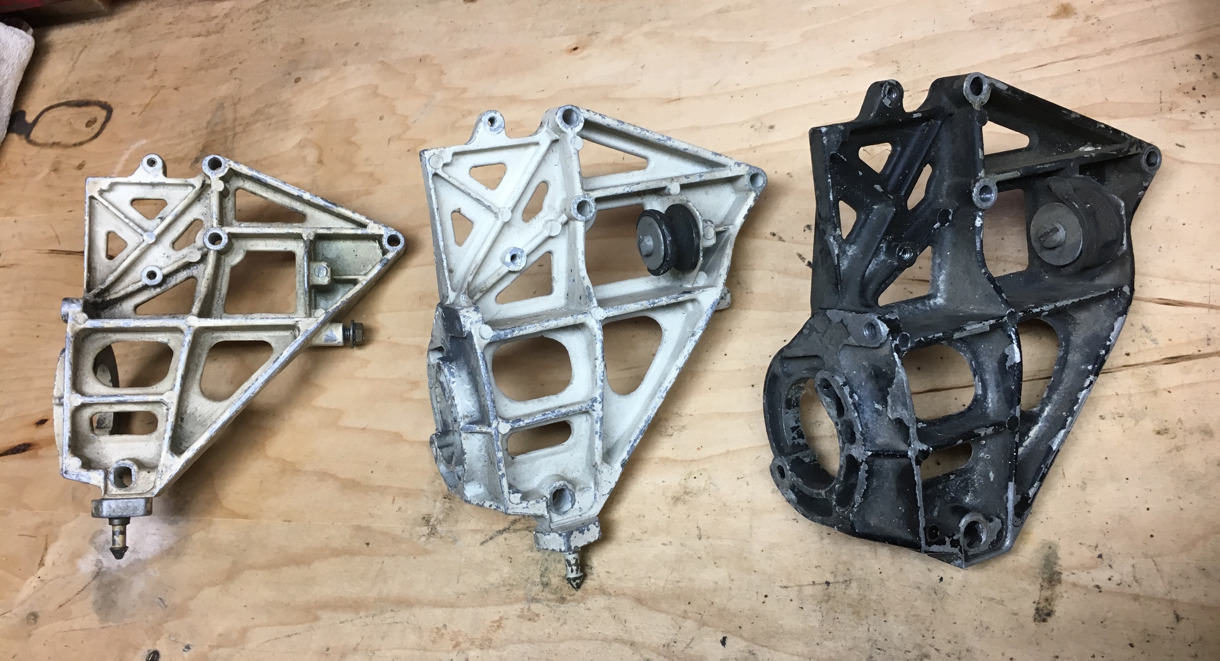

            WAYNE
              Sorry, NJ-boatbuilder, I forgot about you. I checked my generator brackets. None of them have part numbers. They don’t come up for sale very often. Here is a photo of the three available styles.
              From left – right; Johnson, Johnson/Evinrude, Evinrude
              Wayne

              #76581
              nj-boatbuilder57
                An OMC casting without a part number in the casting? I thought they put numbers on damn near everything….
                The black one on the right….I have two of those. It’s the one with the cowl point that I need. You’re right: very rare & hard to find.

                olcah
                  Is there enough meat on the black bracket to fab up and add the point for the cowl?
                  #76614
                  nj-boatbuilder57
                    Meat? Yes. However, the "face" of the black frame isn’t in the same place as the white frames with the points. If I were to mount a "point" on the black frame, it would be too far to the side….such that it would not align with the bushing in the cowl.
