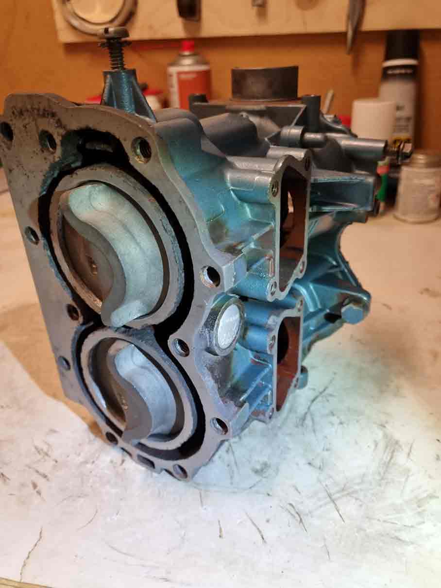

I have totally overhauled my Evinrude 18 HP Fastwin 1960, and today time had come to start break-in procedures for the first time. I had made myself a test tank and mounted the outboard in it with plenty of water to do a first run after assembling all parts (new pistons and rings, honed cylinders, and plenty other parts).

November 29, 2022 at 3:25 pm #269473OR did you put the pistons in wrong ??
November 29, 2022 at 3:45 pm #269475If you mean I put the pistons with the slanted side facing towards the intake? No. The slanted side of the pistons face against the exhaust side. The steep side face the against the intake ports.
Should be right.

November 29, 2022 at 4:54 pm #269478Talking about pistons reminds me of something that happened when I ordered new pistons and rings on ebay. I looked up part numbers on marineengine.com for the 1960 model 15032 (18hp) and found #385338 (piston std). The part numbers for rings on marineengine.com was not recognized as valid part numbers, so for some reason I ordered ring set #378415 (rings std).
It turned out that the rings I received (3378415) had 3 rings in each set, and they did not fit the pistons I had received, which only had 2 grooves. In addition the two grooves were different. The upper was slanted. The rings I received did not fit the pistons. So I had to find out what pistons I had become from the seller. After some searching on marineengine.com I found out that some later models 18hp around the year 1970 had only 2 rings. I found out what the part number those two rings were, and ordered them. They did fit my pistons, so now I have installed pistons #385338 and two rings on each piston (It might be #383473, but I haven’t made a note of the part number, so I’m not sure).
Long story short: I now have pistons in my 1960 18 hp with two rings on each piston, and they fit in the cylinders. Now I wonder if this could cause any problem like the engine does not start?

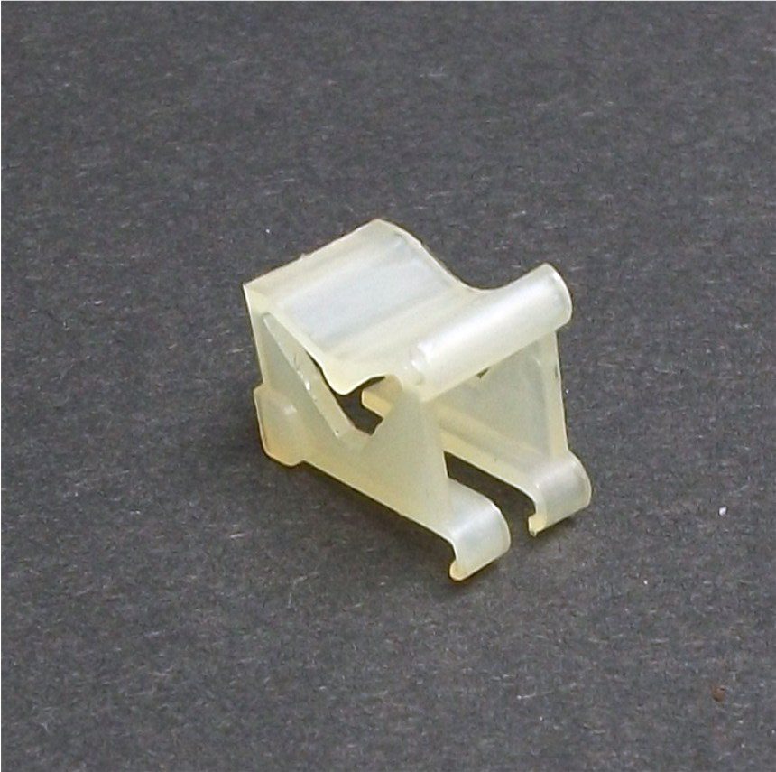

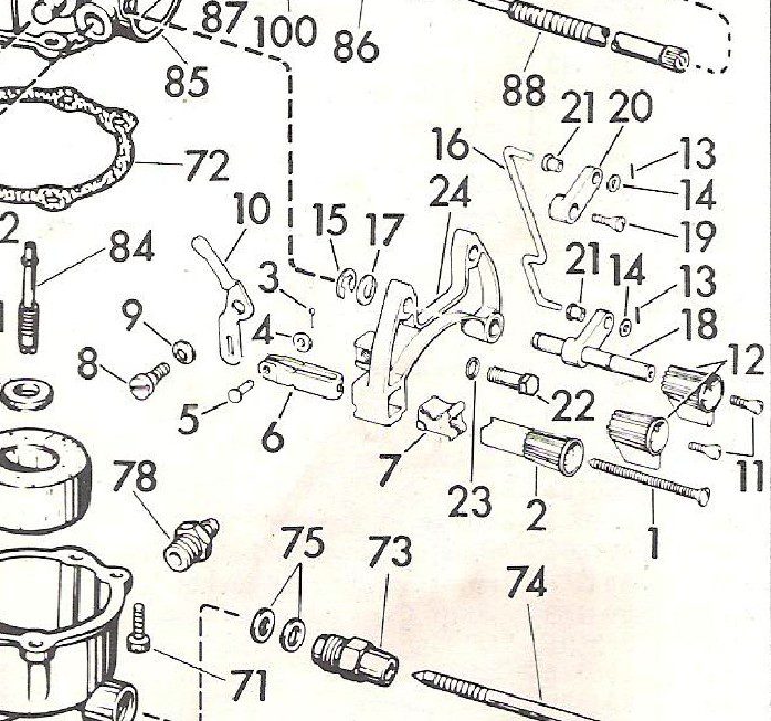

November 29, 2022 at 5:00 pm #269479As far as the choke issue you mentioned, yes, having the choke out helps a lot on a fresh start like that. Can you get someone to hold it out for you while you turn it over? Or wedge something in near the knob that you can pop out quickly once it starts. It’s probably a missing or worn choke detent #7 that holds the notched choke link #6 in place.
November 29, 2022 at 5:26 pm #269484Thank you very much, Steve. I think you are right. I will take a look at the detent tomorrow. It’s just before midnight here in Norway now, and I have to get some sleep.
I will try to get the choke to stay out the next time I give it a try. Probably tomorrow.
I hope the issue with the piston rings that I wrote previously about does not mean I have to disassemble the power head to swap pistons and rings back to the piston with 3 rings. That would be really dreadful.
November 29, 2022 at 5:42 pm #269485You can slit a piece of rubber hose lengthwise and place it over the choke knob to help keep it open.
As far as the pistons and rings, others with more knowledge about those 2 ring pistons and what I believe are called pressure back rings will have to chime in about those.
