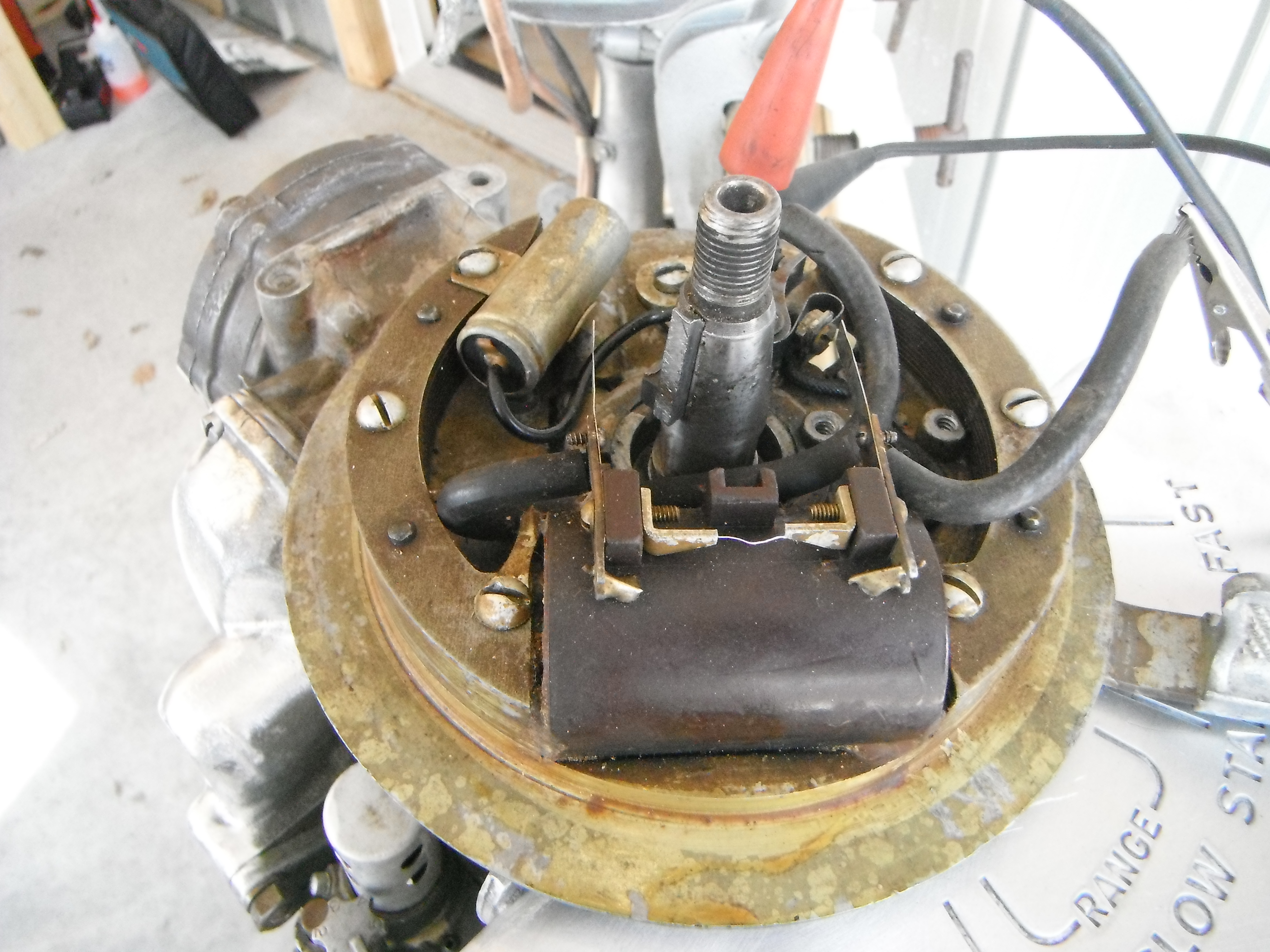

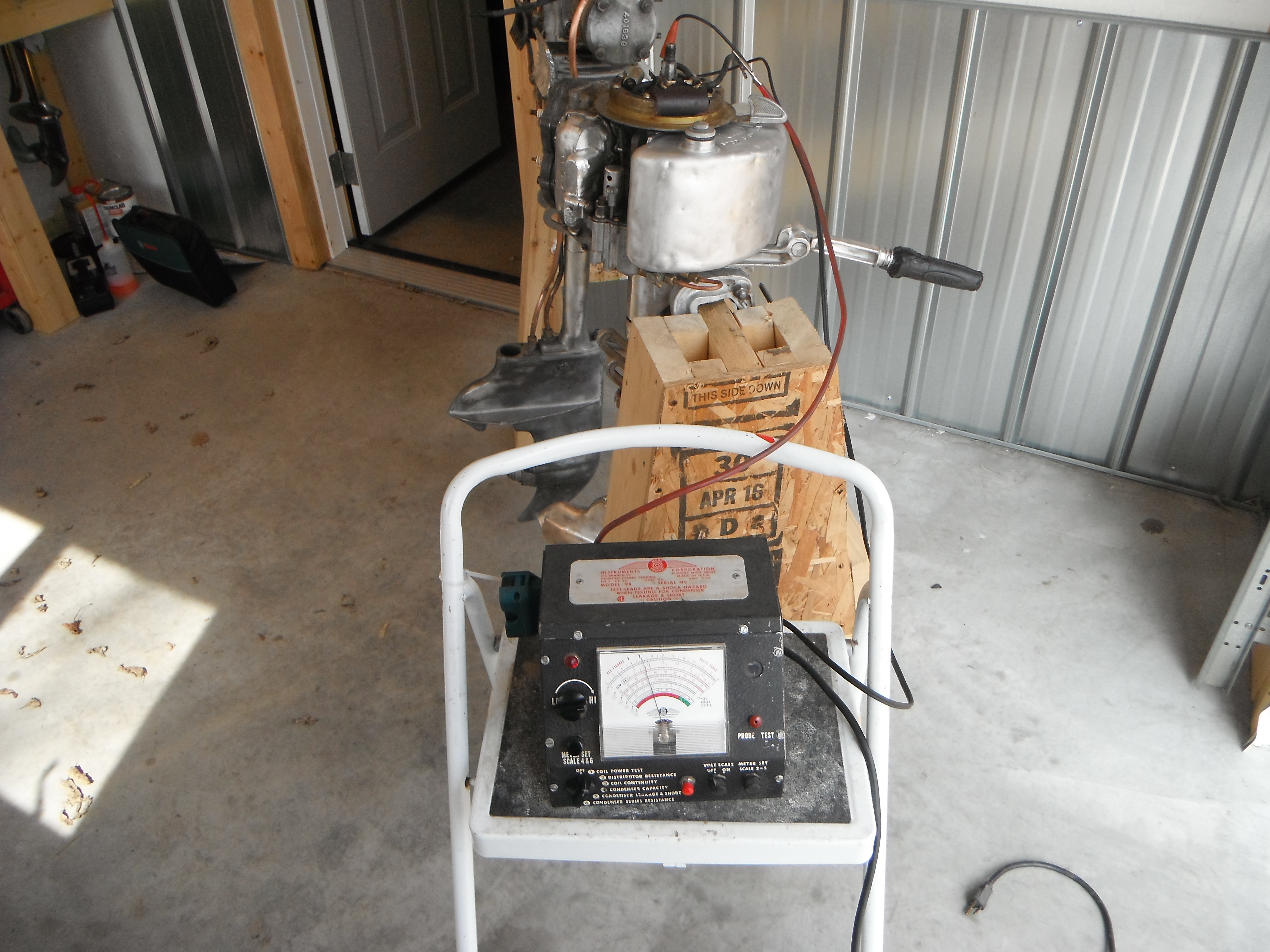

That looks normal to me. It indicates the resistance across the gap in less than the resistance of the tester. The voltage being developed should be enough to fire the plugs. If one plug does not fire, it is a short or open circuit in one of the external high voltage wires or hardware. . . ๐
April 14, 2017 at 9:55 pm #56094Okay so if I pick up some plug wire and caps it should jump the plug before that gap ?
April 14, 2017 at 9:57 pm #56095any idea looking at the picture which side fires top plug ? the wires were cut off when I got it .
April 14, 2017 at 11:04 pm #56100Turn the flywheel so one piston is at top dead center. Measure the resistance of the spark plug wires. The one with the highest resistance is the one that goes to that cylinder. One spark plug wire measures the coil resistance, the other is shorted by the distributer brush and does not. . . ๐

April 15, 2017 at 3:24 am #56112I will have to put some new plug wires on it with caps and see if it has spark at the plugs . With the spark tester it sparks up at the coil as seen in the picture but with my meter it shows a open on both sides of the coil on the secondary coils.
April 15, 2017 at 7:17 pm #56127It would show open to ground from either end of the coil unless the other end was grounded. . . ๐
