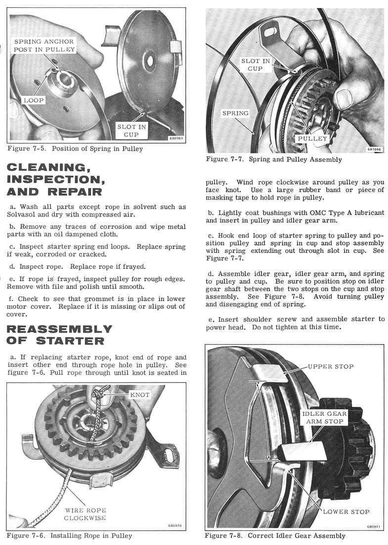

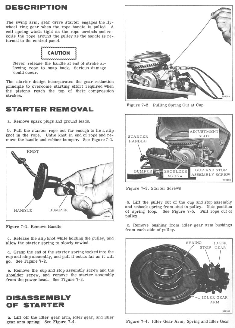

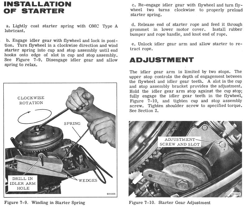

        Aw come on, they aren’t hard. Easier if you have the special tool, but doable without it.
        EDIT: common error–there is a flat washer between the cup and pulley. Leave it out and it won’t work.
        3-hp-Side-Mount-Starter-P1
        3-hp-Side-Mount-Starter-P2
        3-hp-Side-Mount-Starter-P3

          Yeah, they are actually pretty EASY if you read the directions. Pretty darn slick, really.

            The directions look fairly easy. Ordering a new spring and will give it a go! Thanks frankr and billw
