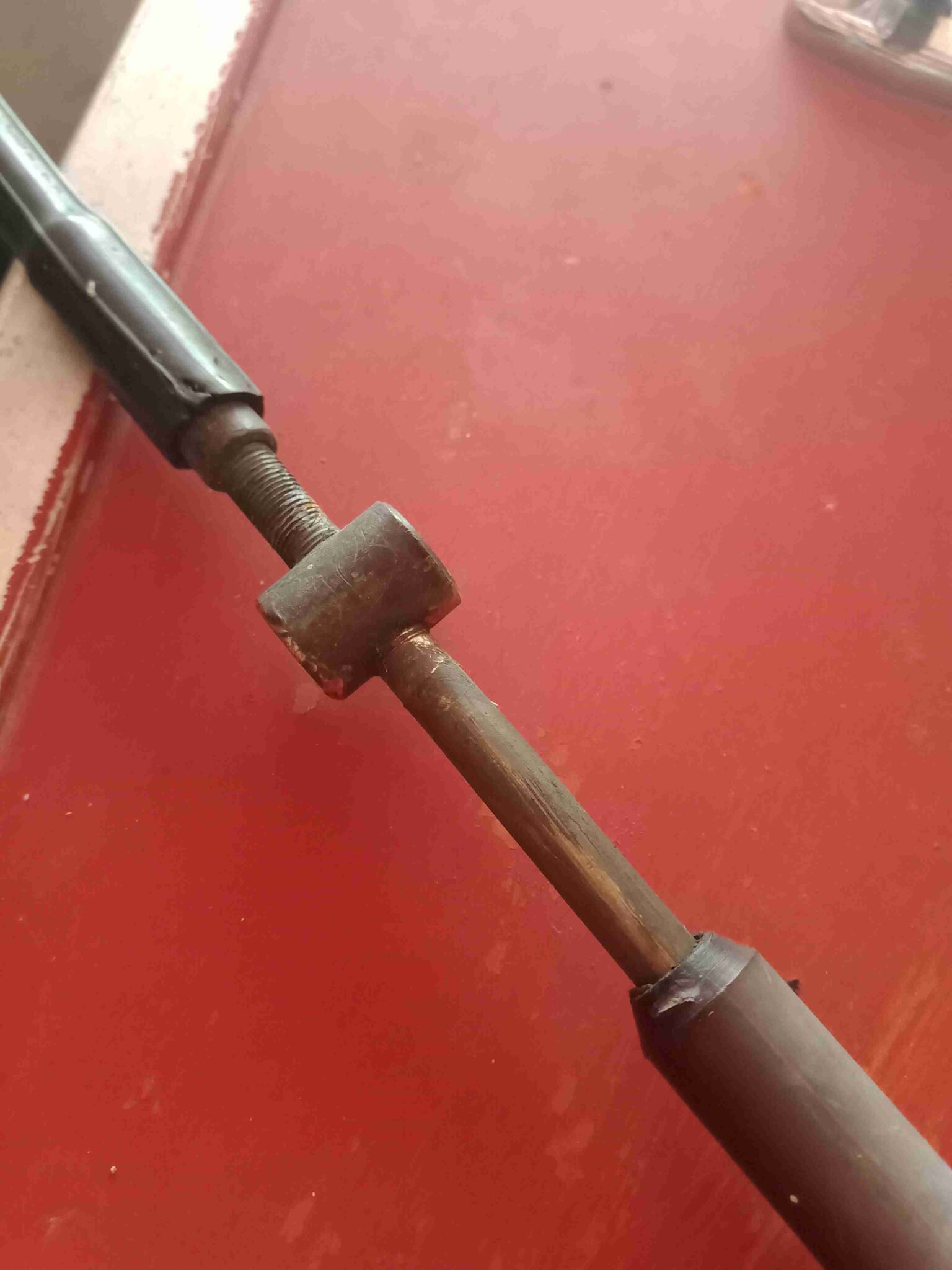

            The older, 1950s, OEM remote control cables had brass  hardware that went in those cable brackets you are talking about, and those brass pieces were shaped different than the plastic ones, so the optimum size of the bracket was different.  Photo below.
            Remote-OMC-cable-end-brass-lo-res
