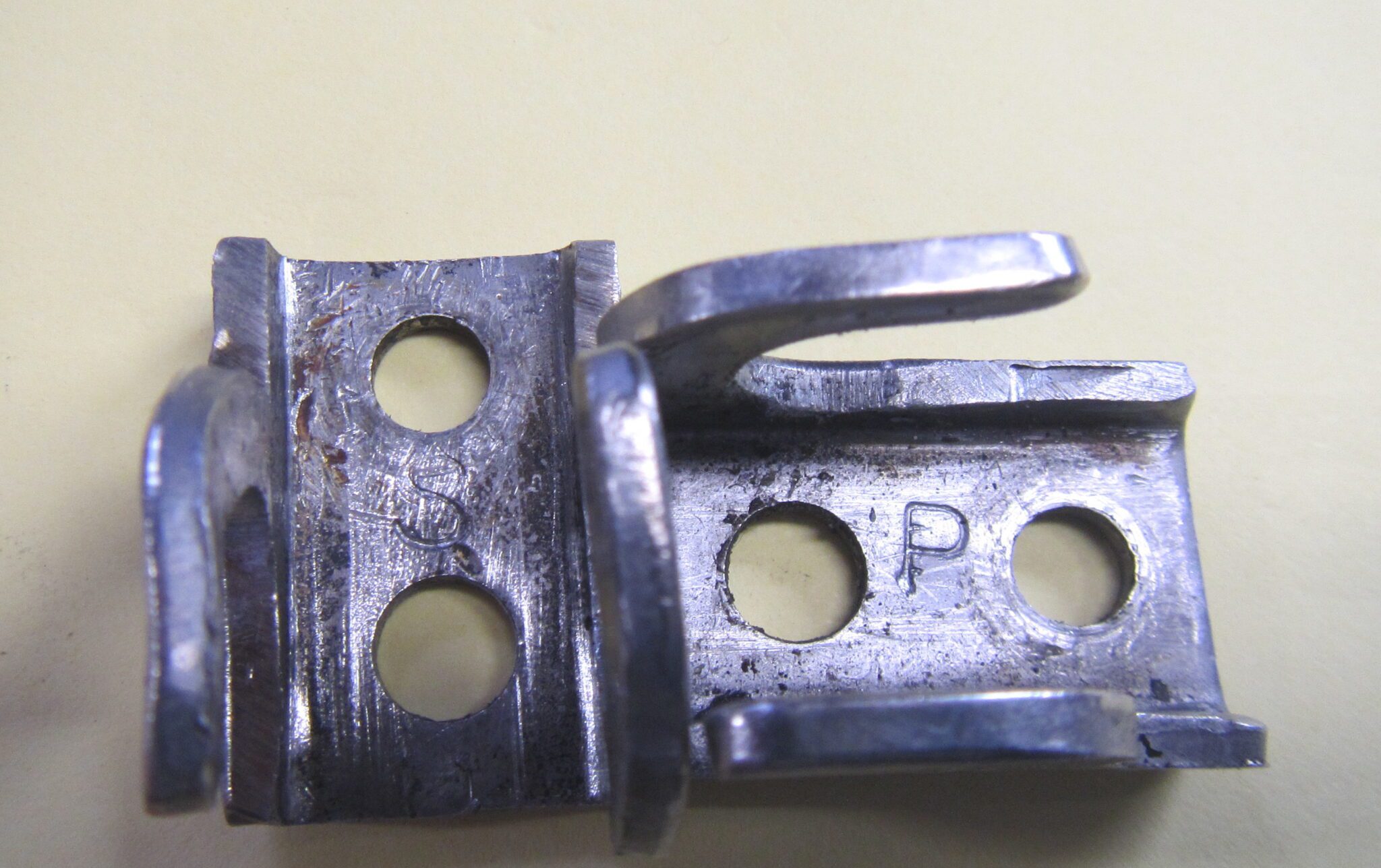

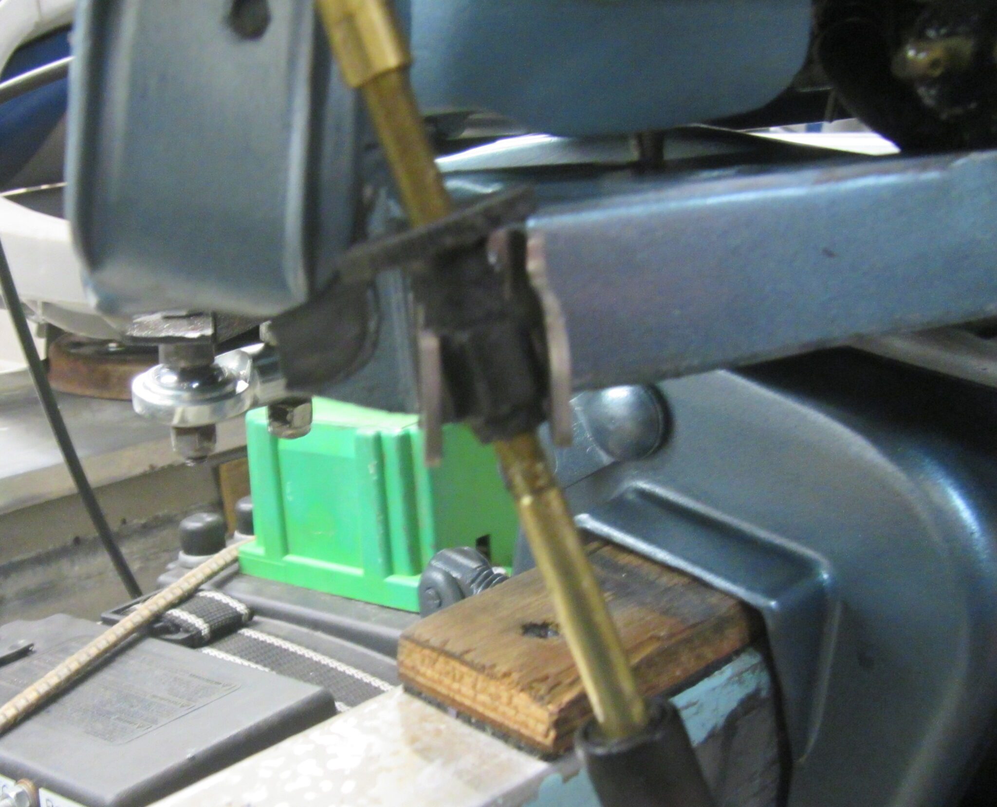

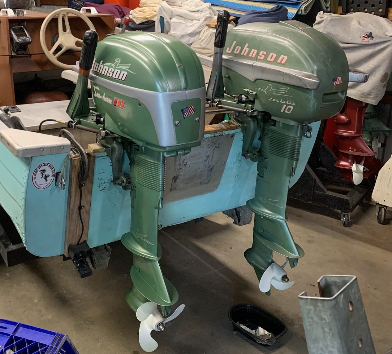

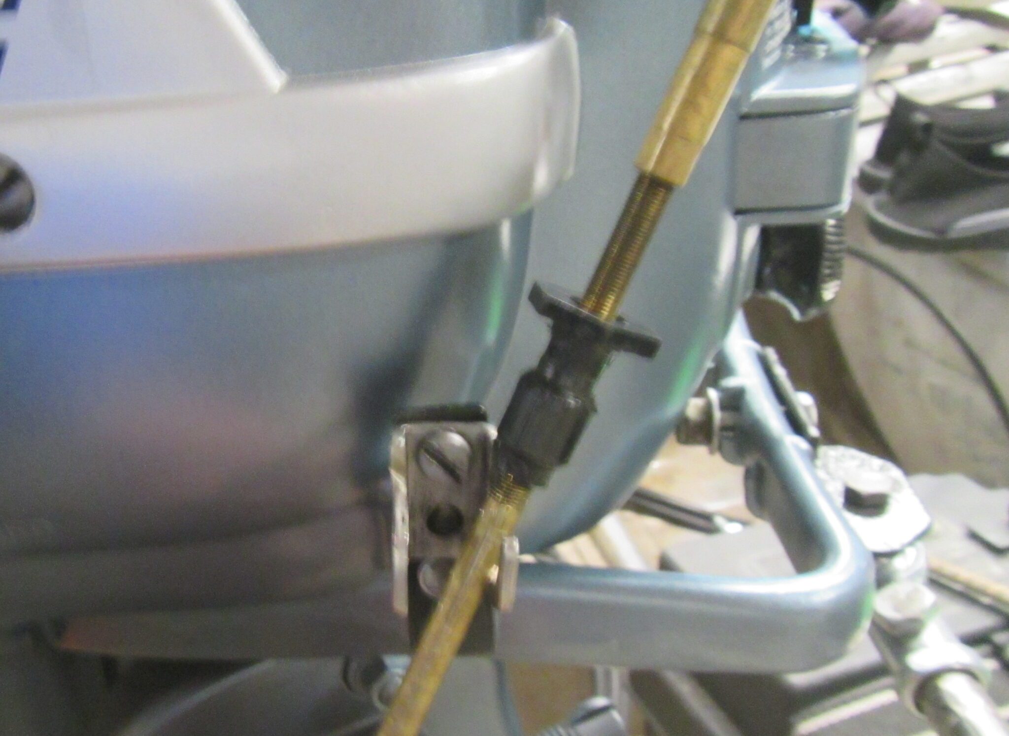

May 6, 2025 at 2:56 pm #296230Hello Shell and welcome! Let me give you a little 101 on OMC cables. I have several 50’s OMC motors that I run with remote controls. If you are ruining the plastic part of the cable you are installing them wrong. The attachment part that attaches to the cowl of the motor are side specific. Meaning one is port and the other is starboard. Some are marked some are not. When putting the cable on you start with it straight up and down. The brass part in the bracket. You will have to turn the motor right or left for the cable to miss the transom. I hope my pictures make some sense of this jargon! I also run dual outboards with remote hookup. I especially like running two 10hp OMCs

May 6, 2025 at 3:22 pm #296234Shell I forgot to mention there was a smaller cable bracket that was used in the early 50’s. These that I have posted are later 50 through the 60’s maybe more!

May 6, 2025 at 4:49 pm #296236Greetings Dale and thank you for your replies. I do have the brackets in their respective port/starboard locations, I also noted in my old outboard inventory that as you mentioned there were smaller cable attachment metal brackets. I have the same ones currently installed that you show in your pic. I know with time that the more I install/remove the remote control cables the easier it gets as they “condition” themselves. This is do in large part to the plastic cable portion getting whittled into shape, I hate forcing these cables into the metal bracket, especially new cables. If one were to only have to install them once that would be OK but I am always removing the cables due to as I mentioned I remove the outboard for travel as well as try out different motors on a boat.

You can adjust the fit of the brackets by bending the prongs with pliers. Do it off the motor so you do not damage the motor attachment points. I just use a vise and maybe support using wooden blocks..
