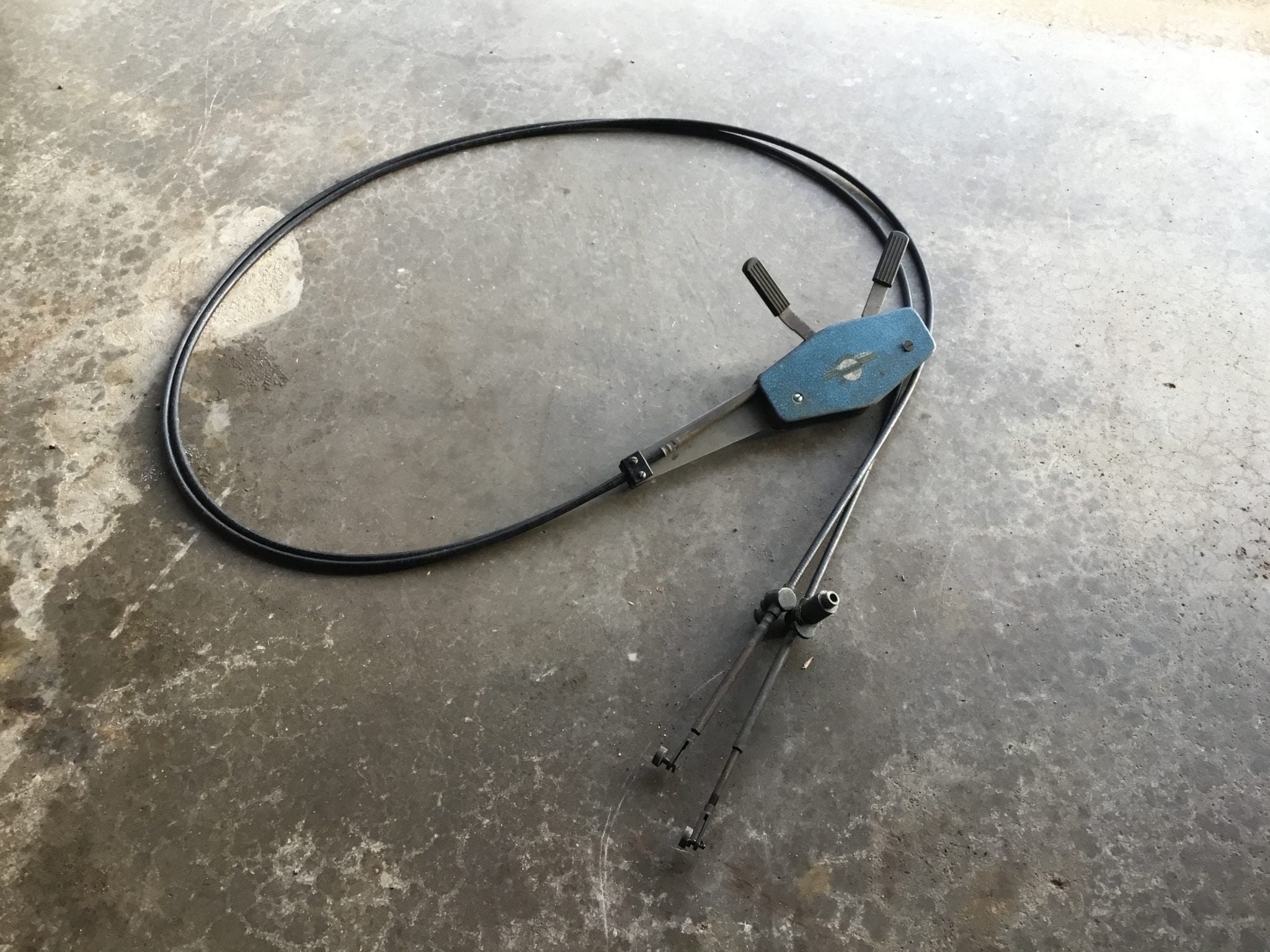

      I was wondering if any member has adapted a different control unit, to work on a Champion Sweet 16 motor. There must be some other control unit that will work on this motor. I have one unit so I can fabricate the motor attachment points.

      #197720
      davidk
        Will you show us the unit you do have and how it attaches?

            #197746
              Those cables sure resemble the Morse 33C cables with their threaded ends and grooves for attaching, probably an aftermarket copy.. But that control box with the extended bar sure looks goofy.

                #197820
                Mike-Sea
                  I think the goofy looking extension on the control box is to keep the cables from binding. The cables in this box attach half way up the control lever. Thanks for your info on the Morse Cables. What is the difference between a 33c cable and a 43c cable?
