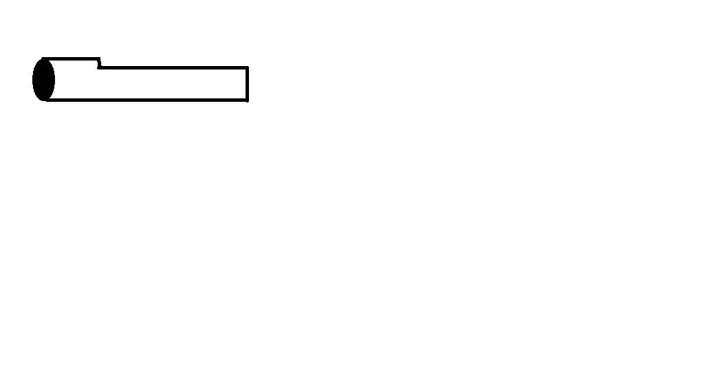

      I have a brass exhaust tube on the motor I am restoring and it has some small dents I would like to remove. It has two different sized ends and they have a small crimp on ends. I tried to use a ball bearing and was going to force threw but the crimp on end prevented that unless I wanted to flare end and I don’t want to do that.
      Any suggestions on how to remove dents.

          If there aren’t any creases a soft hammer will
          take the dents out. A solid rod may be a better
          choice than a pipe for what your doing. You may
          have to grind down part of the rod to get around
          the crimp or if you do use a pipe cut a part of it
          out.
