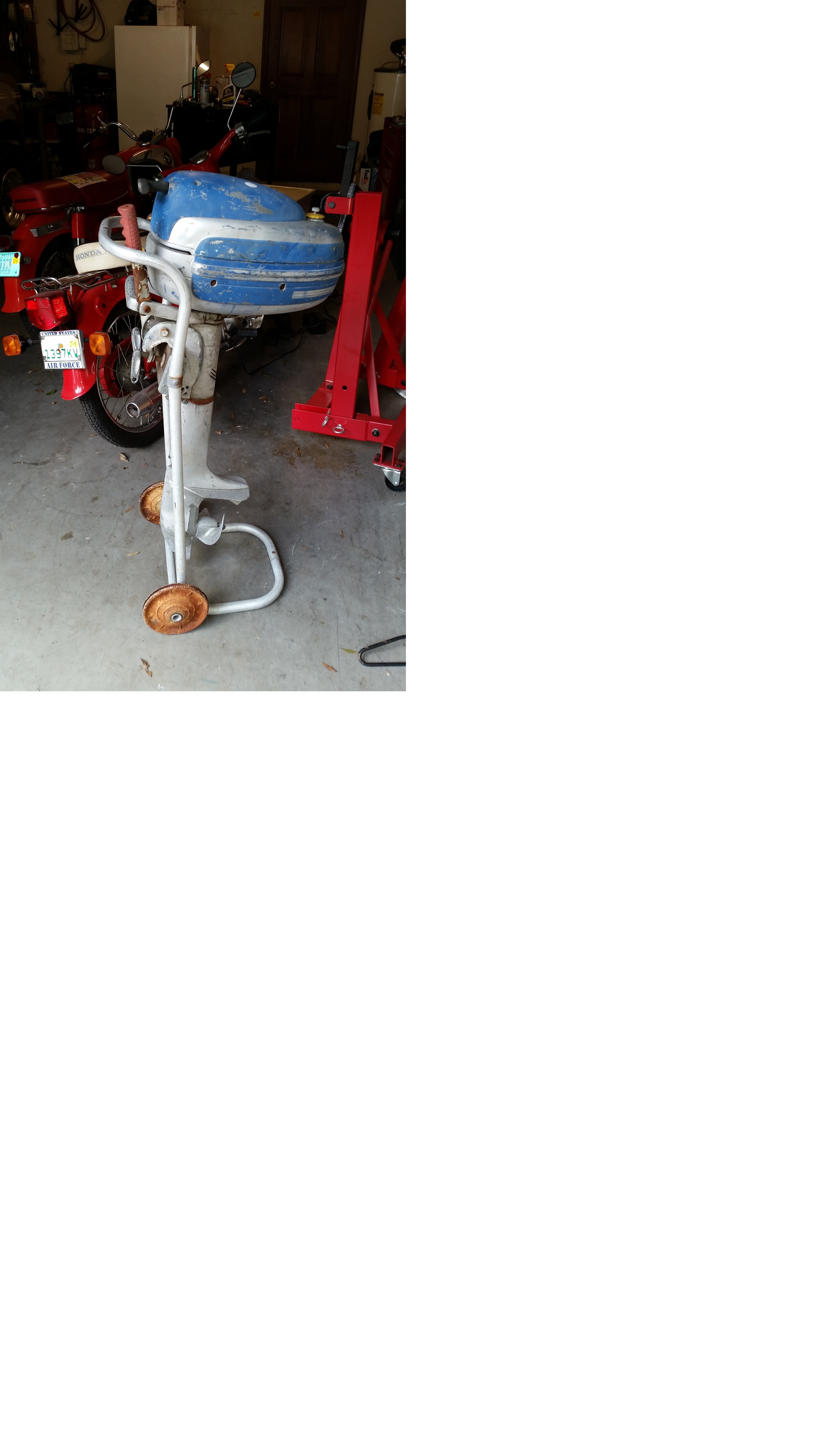

      First post, I recently acquired this Goodyear Seabee 5 hp motor (model # 025-3564A) in non-running condition. I found it in what was basically a junk heap in the back of an antique shop & couldn’t resist it.

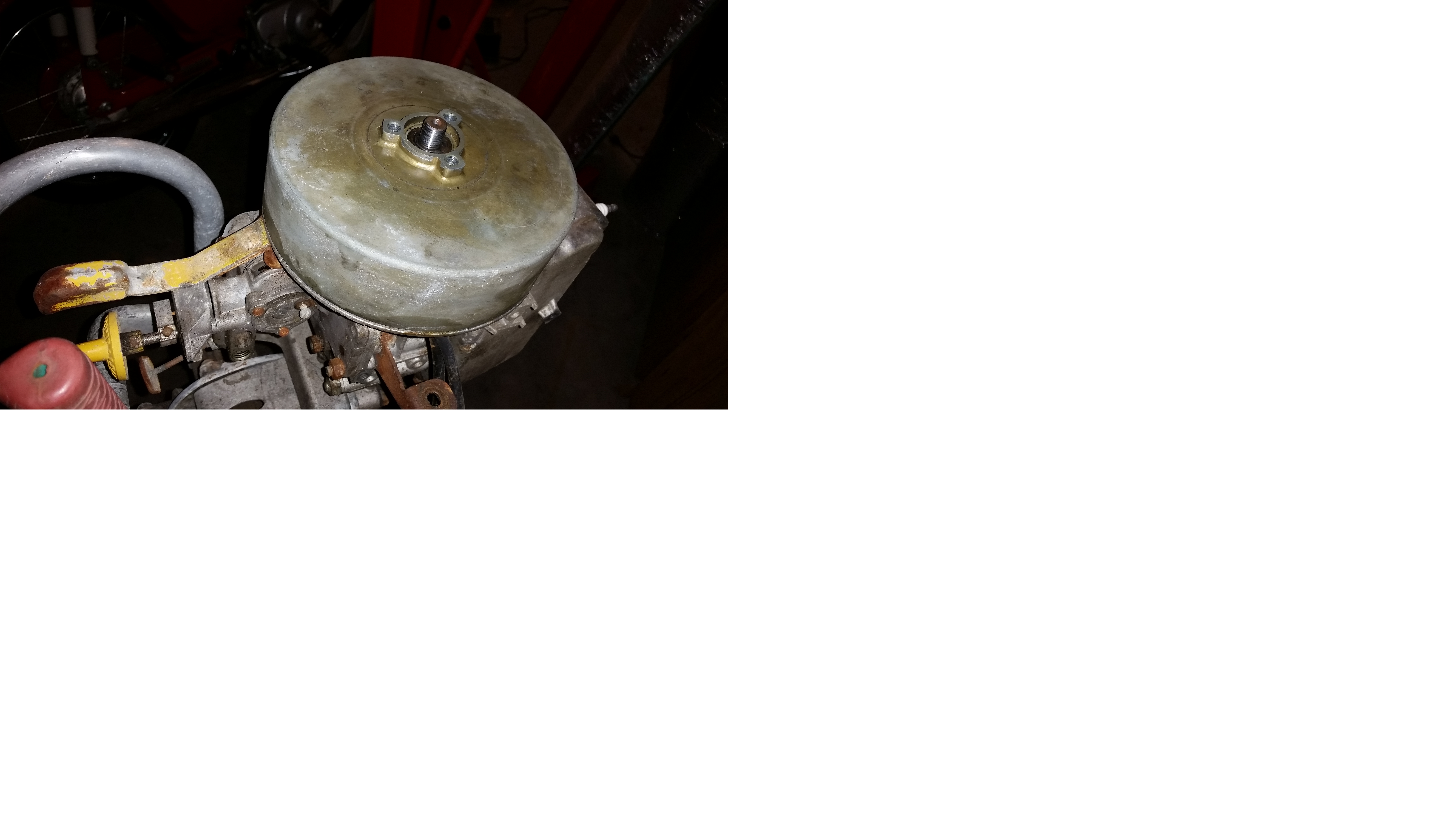

      The engine turns and has compression but no spark. I need to pull the flywheel,But am uncertain how to do this without damagingthe flywheel. Can I thread bolts into the holes that attach the the starter mechanism and use a harmonic balance or steering wheel puller?

                  I used a harmonic balancer puller and the flywheel popped right off! Incidentally this is probably common knowledge but Autozone & O’Reilly’s have the pullers available in their tool loaner programs.

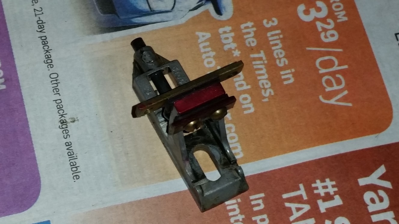

                  Both sets of points were so full of oxidation or whatnot that both of them read infinite ohms across their contacts when they were closed! I cleaned them and I now have spark. I’ve never seen points like these, I’m assuming they’re no longer available. I saw a set that were on eBay about a month ago, the buy it now price was $77.00. For a set of points…

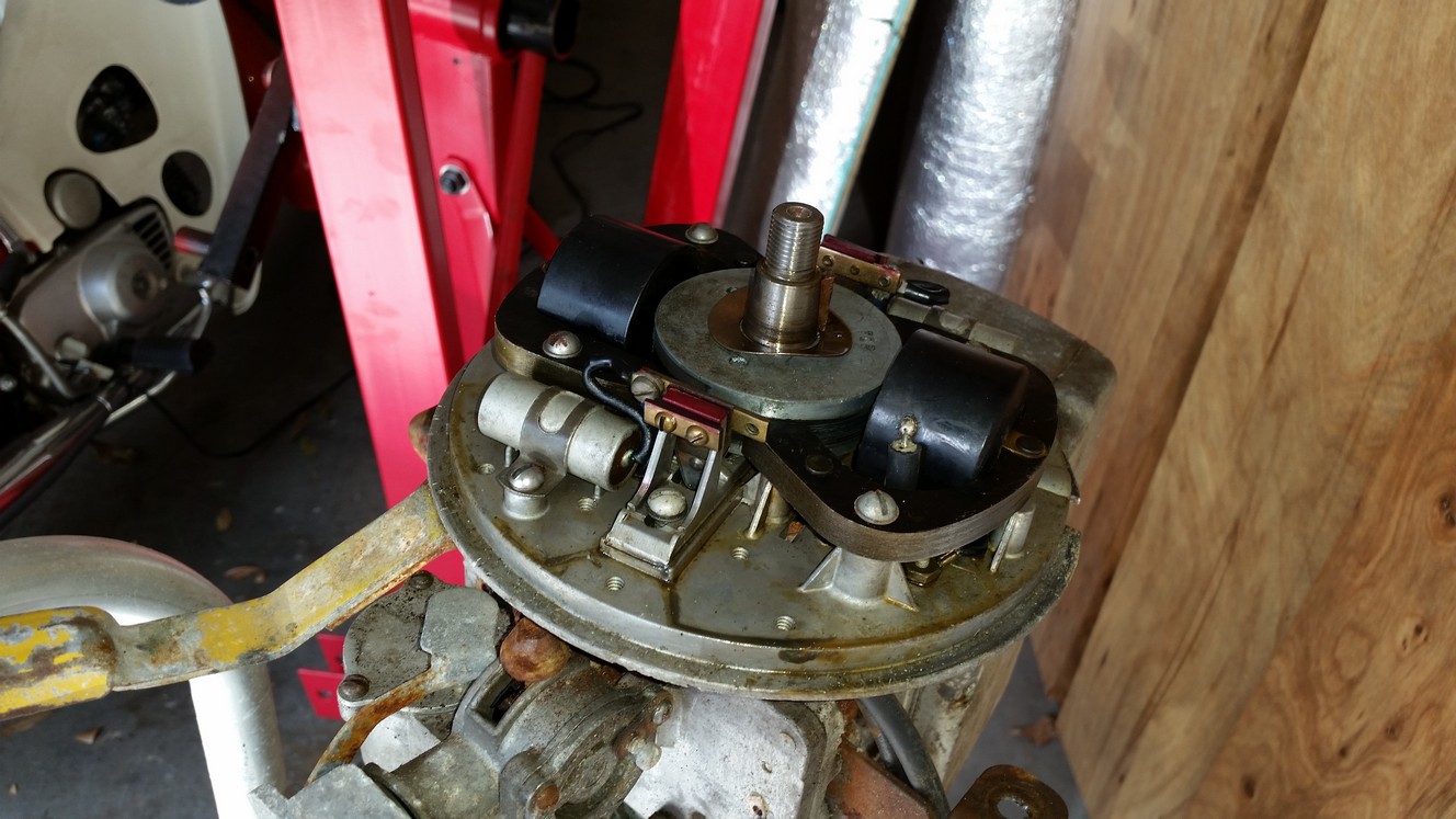

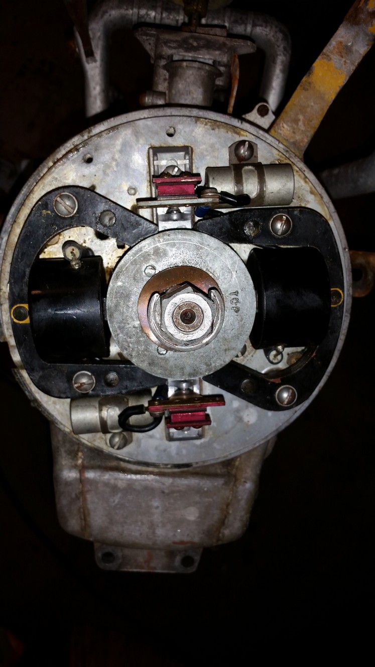

                    Ray, could you take a picture of your ignition plate on the motor from directly above and post it on the forum. Please include the whole ignition plate. Would like visualize something. Those coils look to be in great shape. The ignition videos on my channel are unfortunately for the later OMC universal magneto.

                      ray-mason
                        Cajuncook1,
                        Will this work?
                        Betty Ann,
                        I set my points to .020", does that sound right?
