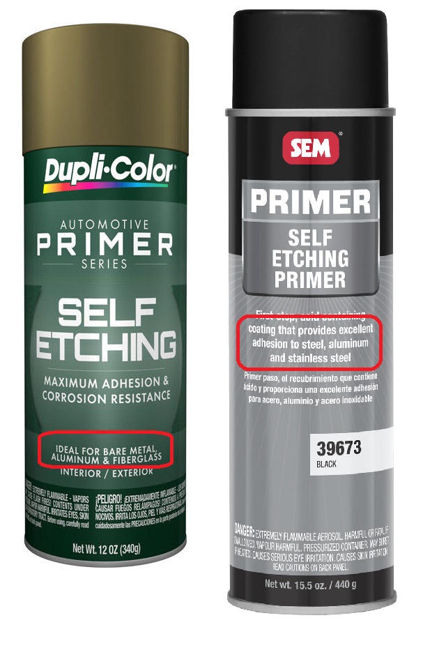

              You can find etching primers in spray cans.
              Rust-Oleum would be the cheapest.
              I had used the Dupli Color on a motor I
              wanted to do over as it was getting a little
              beat up from use. It was a real pain to get
              off before I could start over. When aluminum
              gutters first came out they weren’t coated
              like today. Painters would acid etch the
              aluminum with vinegar before the lead
              paint was applied.

                But most of these "hardware store" rattle-can primers just don’t work very well on aluminum. Regardless of the printing on the can, they just aren’t very good on aluminum. Fine on steel, not so much on Alum.
                Zinc Chromate – works great! And you can’t get it, and it will kill you.
                Zinc Phosphate – Not bad, but not as good.
                "Hardware Store" (rustoleum, duplicolor, krylon, etc.) – on aluminum, they all kinda suck. Bonding to the oxide layer just doesn’t hold very well. Better than nothing, I suppose, but in my experience, "not by much".
                Whatever you use, surface prep is the key. hot water & soap, then hot water, dry it, then acetone, then naphtha, then do not touch it! (skin oil un-does the washing)…..then paint immediately
