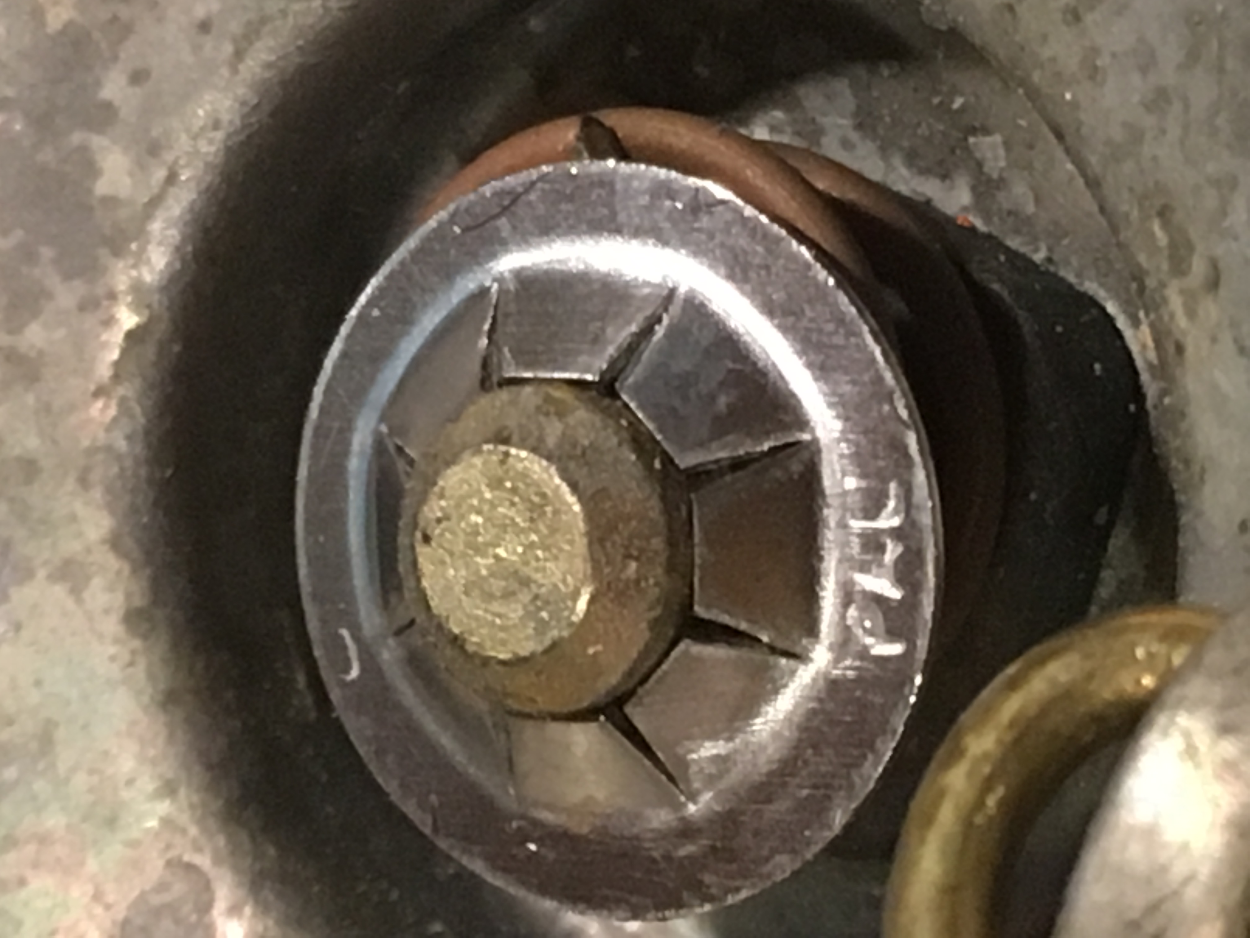

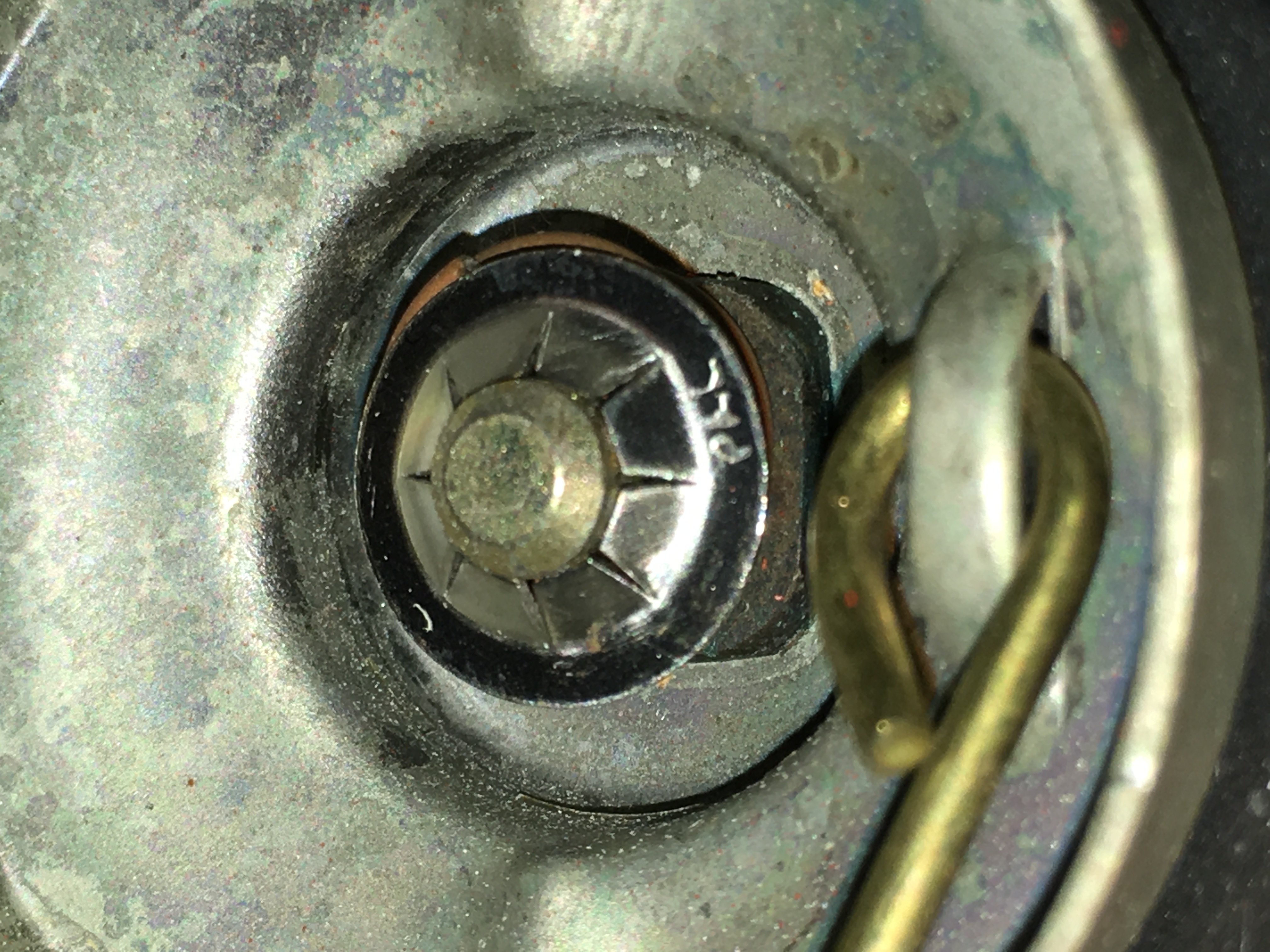

      This might be a dumb question, but:
      I need to replace the sealing washers under some tank cap vent screws. Like what’s on the 3 gallon OMC tanks. These are prevented from coming all the way out by a thin stainless steel washer with spring tabs on it, that engage a groove near the end of the screw. I don’t see an obvious way to remove the washers without buggering them up. Is there a trick to this? What are these washers properly called and are they a hardware store item?
      #77694
      david-bartlett
        They are called Push Nuts or PAL Nuts. Can get at a good hardware store.
        https://www.mcmaster.com/#push-nuts/=1d7b4b7
        #77710
        John Schubert
          To remove them take a center punch & tap at the base of the tab where it begins to taper up. This will release the holding effect & makes for easier removal. Hardware store, auto supply stores & McMaster Carr have tab washers.
