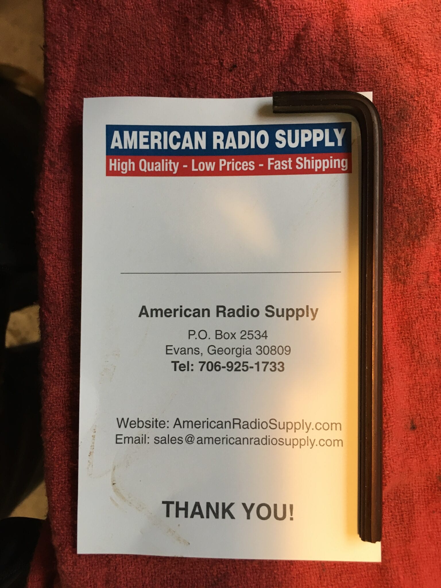

        I think you need a bristol spline wrench . That is what I had to use on my Scott 1-30. If you think you have them all out, heat the base up real good with a hair dryer (or carefully with a heat gun) then give the block a rap with a rubber mallet. I had to do that with a Mark 30. Some times they put sealant on the gaskets at the factory which acts like glue. I believe my wrench was a 1/4 inch.

          i appreciate the info- i will look at the screw again but from memory it was a 3/16″ allen/hex head screw… not sure if they were replaced at some point in the past. Any tips on how to get access to them all? that seems to be my problem at this point
