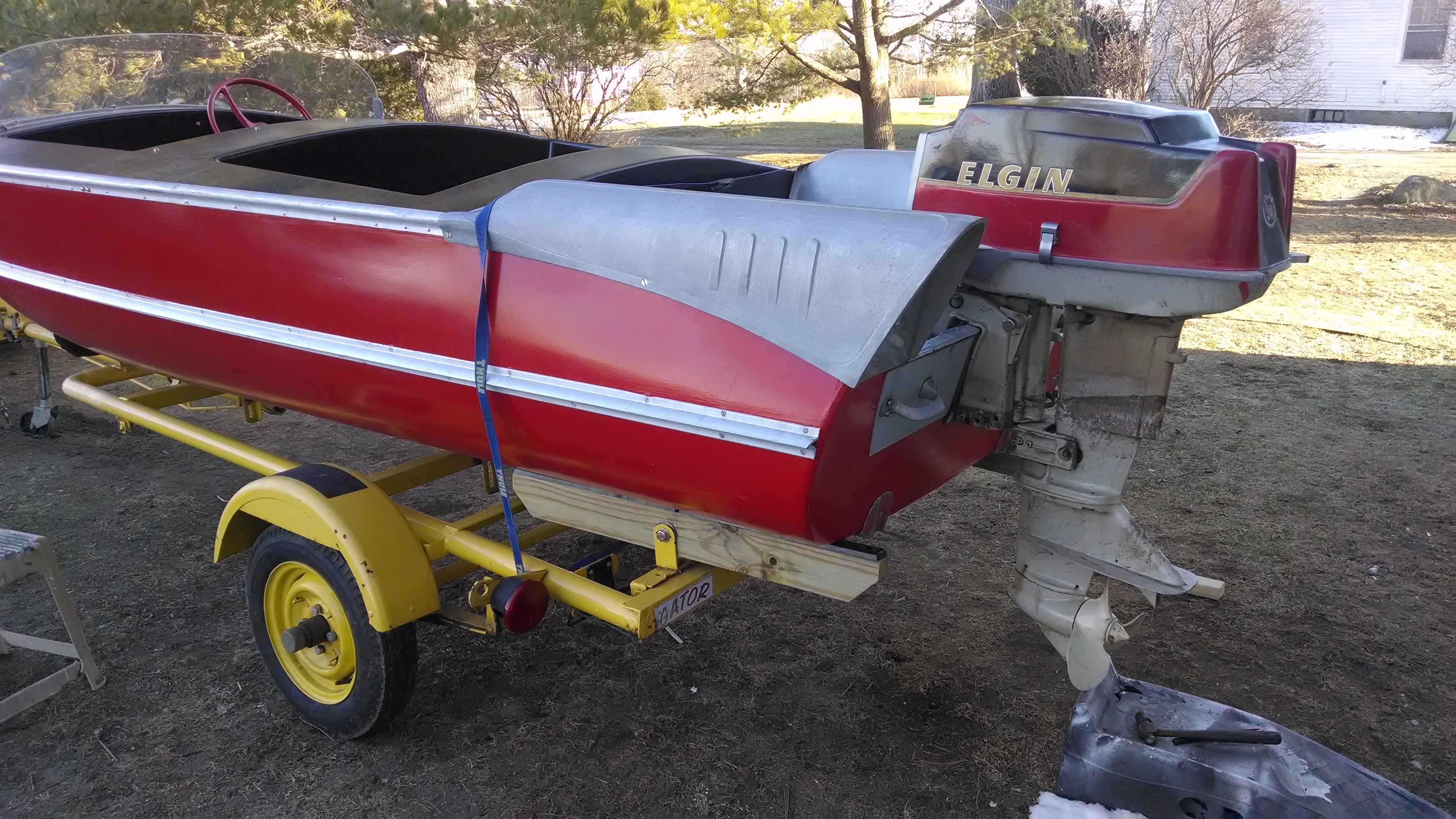

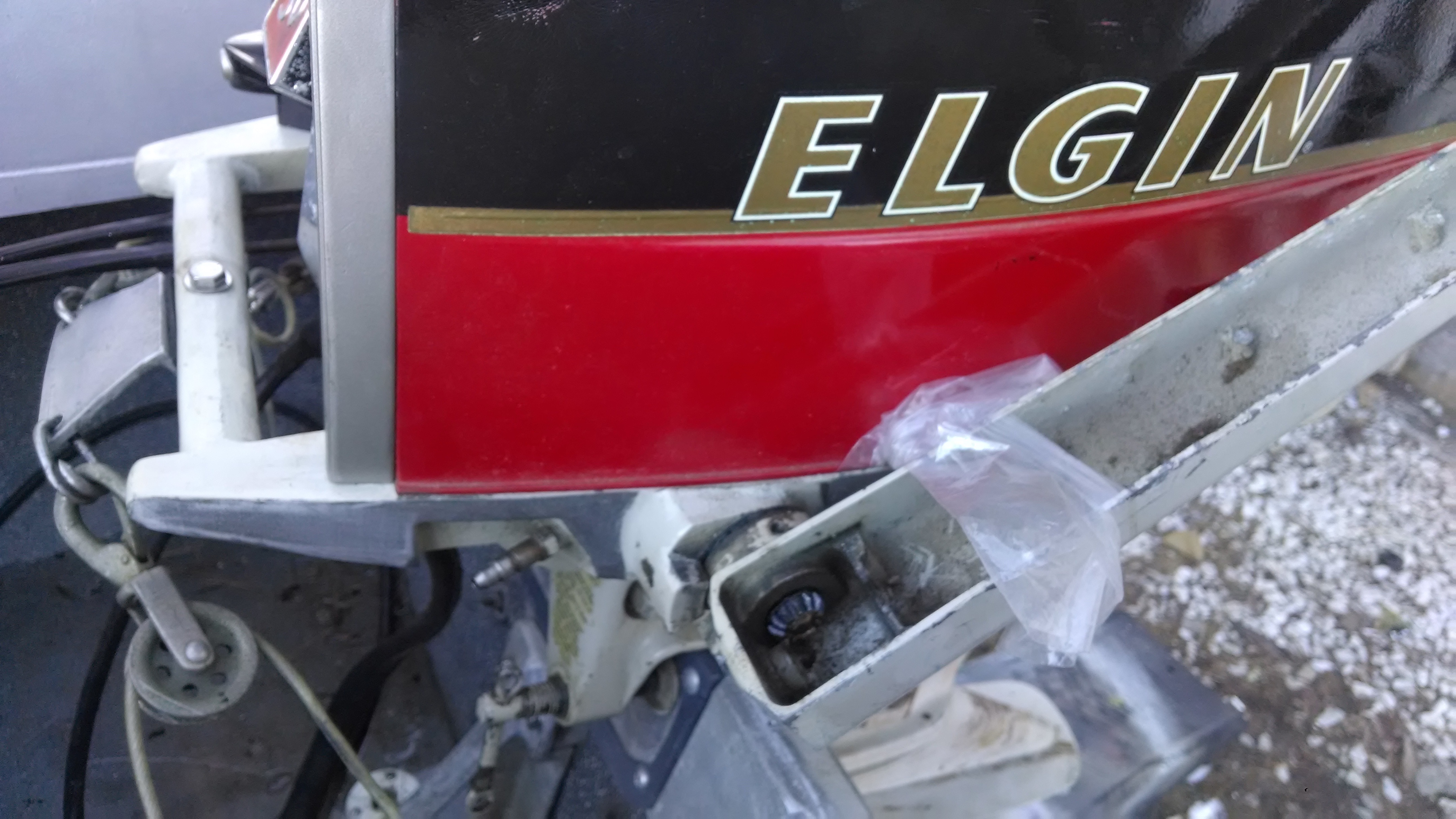

      Anyone have experience setting up a 1957 Elgin 30hp for remote steering? I’m attempting to use this on a 1956 Herters Flying Fish. The tiller hits the port side fin. It folds back doesn’t look so good and but seems to me it will become a rain catcher. I started to disassemble the throttle but the deeper I go, the more complicated it gets leading me to wonder if it’s meant to be run without the tiller?
      I believe the OMC’s of this size had a plan for removing the tiller arm for remote step, and even a cover for the point of attachment, right? I sure hope someone at West Bend had this thought through. I think this boat and motor were made for each other. I hope they can reconcile their differences.

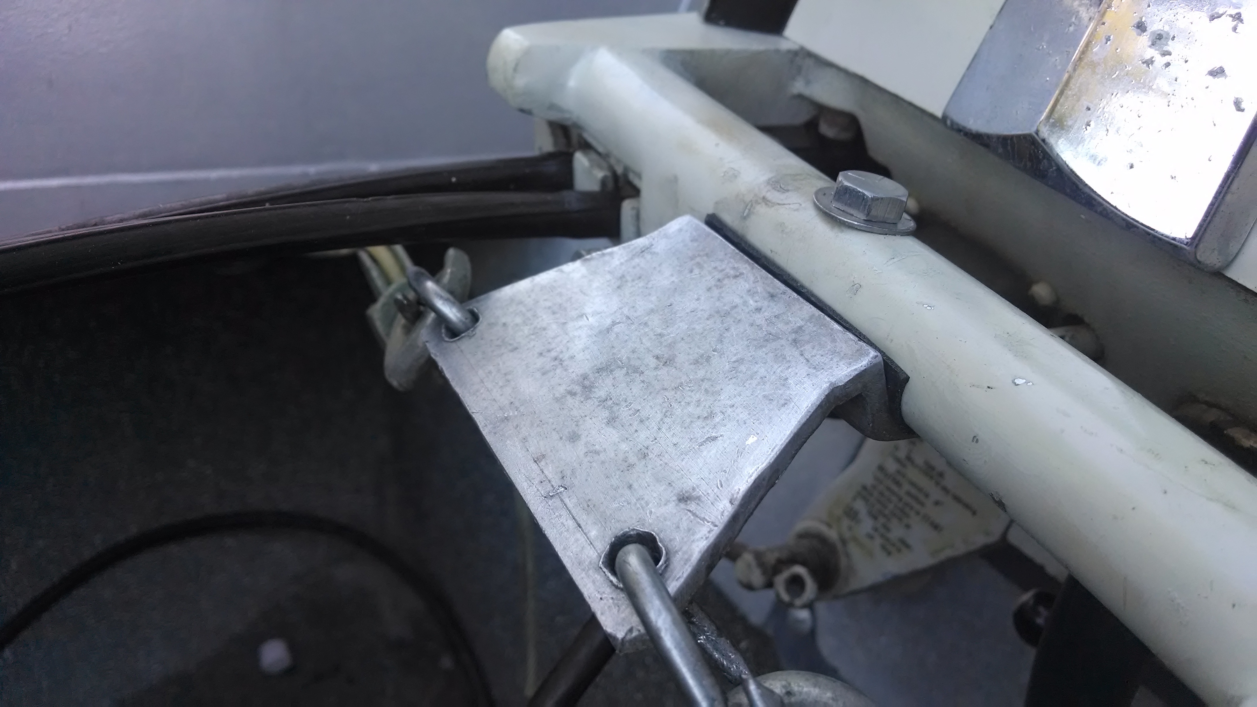

        Another question…..I wonder what the original steering connector was like? I found this home made bracket in my parts pile and it may work but it’s aluminum and I’m worried about a potential failure.

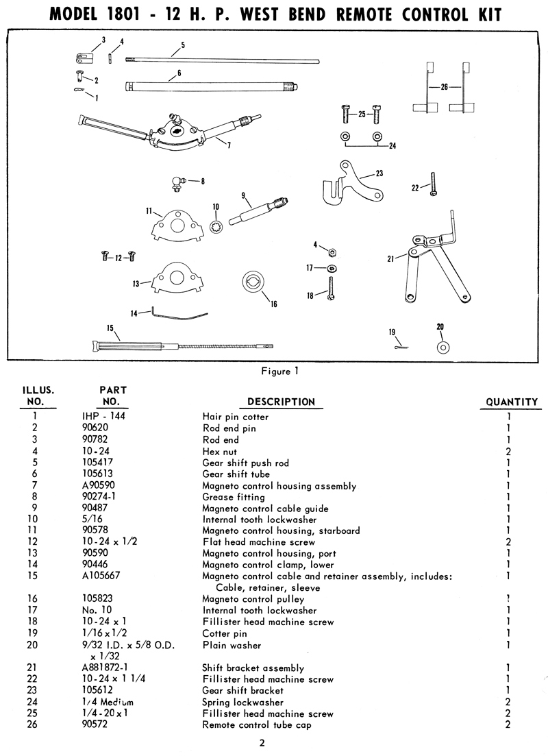

              #73734
                Do you have the remote control adapter kit? I don’t know about the 30, but if it is anything like the 12hp, it is quite different from anything else.

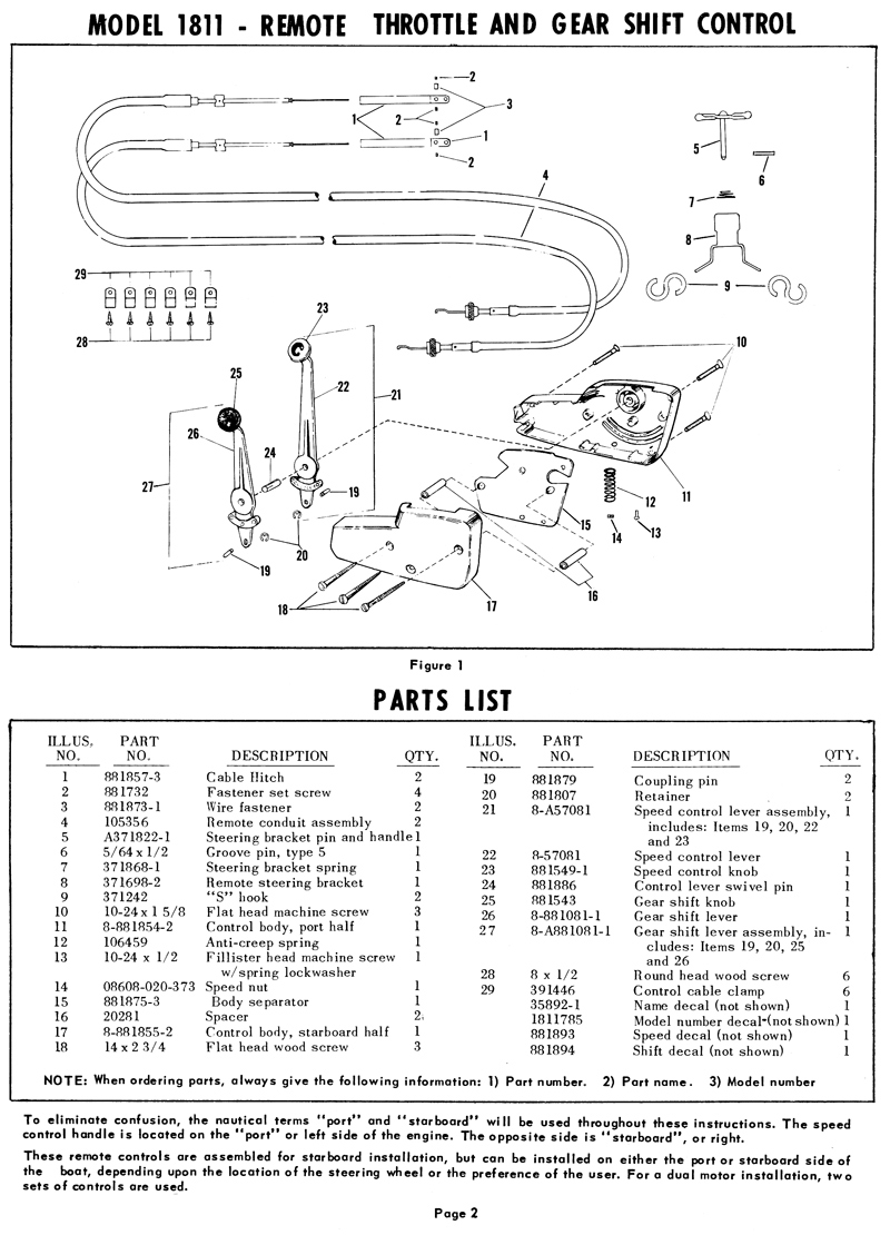

                  Wow, Frank, you are a treasure trove of information!
                  That’s quite a rig for adapting the 12 hp. I wonder who has a pile of those sitting on a dusty shelf somewhere? The 30hp comes with internal receivers for the cables. It’s an interesting setup. Pretty clever.
                  It’s helpful for me to see the illustration of the steering bracket. I wonder if there was a more rugged bracket for the 30?
