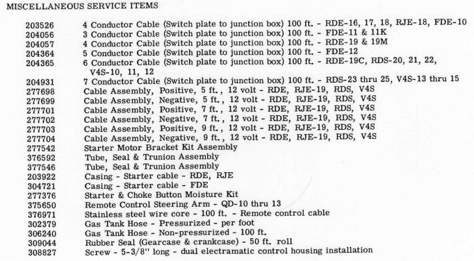

        I’ve repaired lots of them back in “The Day”.  You could buy the wire in 100′ rolls from OMC.  Matter of fact, I used to save the broken wire and use it to repair shorter cables.  Yes, it is stainless steel, I don’t know the grade.
        #262436
          It was part number 376971
          376971-wire

              #262468
              bob-d
                376971-wire
                Frank, the info you have tucked away in the back of your brain is amazing.
                Bob D
