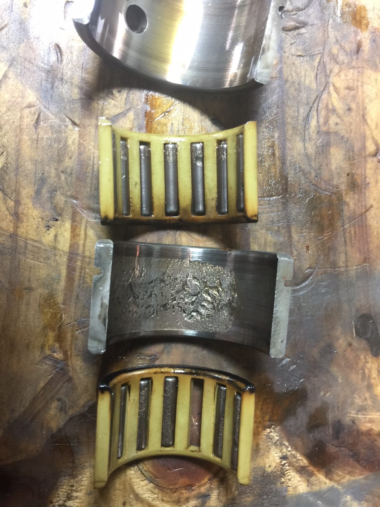

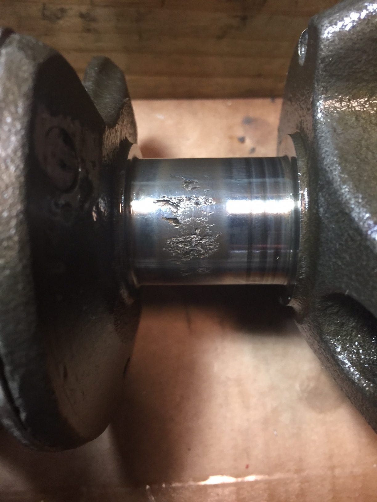

          While we are on the subject, think about this–the CRANKSHAFT is the inner race for all the bearings. If the bearings are damaged, there is a likely chance the crankshaft surfaces are also. Then it becomes fatal.
          #220088
            Like this one I found in one of my motors. Note one of the bearing needles was completely missing when I opened the case!
            Crank-Ctr-Bearing
            Crank-Journal
            1982 Evinrude 25hp

                  #220181
                    I think I see the missing needle. It’s now part of the crank and the race half!
                    #220185
                      Indeed it is! When I first opened the case, I saw the needles in the one retainer were all chewed up and thought “that’s not good”. Then saw the missing needle in the other retainer and thought “that’s really not good”.
