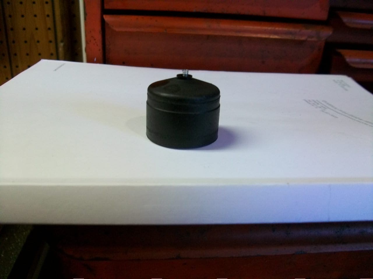

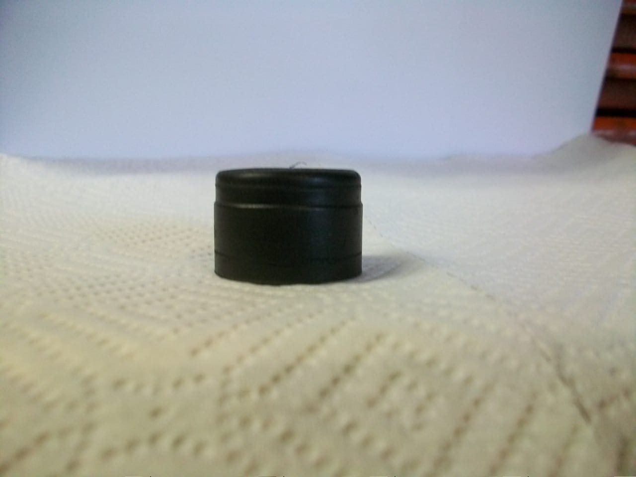

        #176472
          Pictures
          100_1143
          100_1152
          100_1153
          #176475
            100_1143
            #176478
              100_1152
