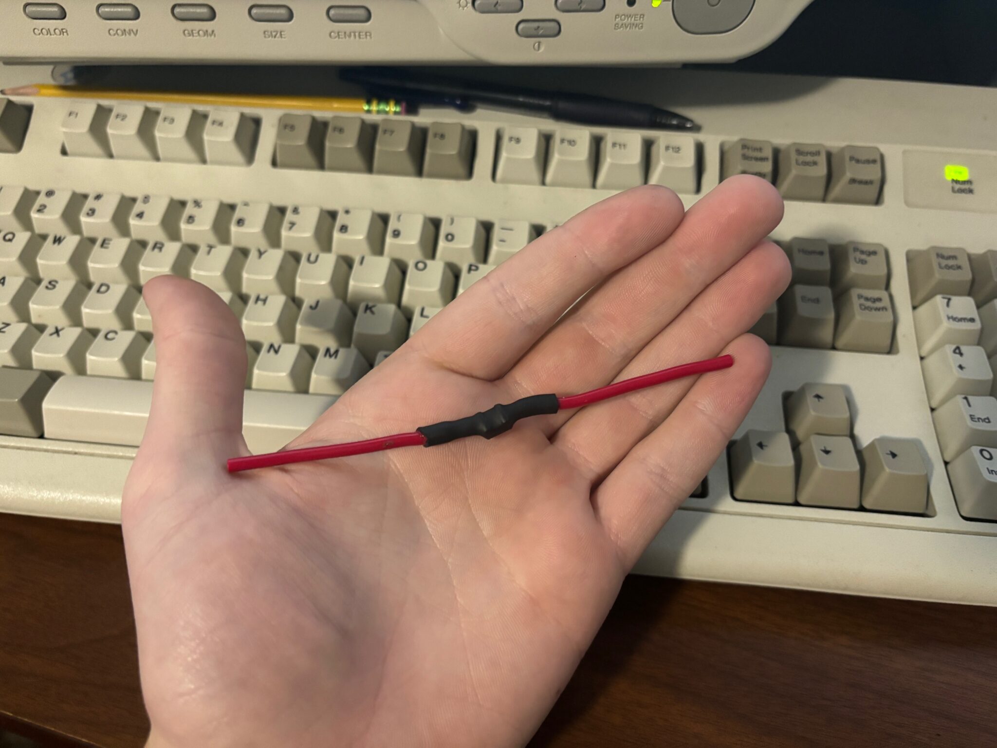

          IMG_7598
          ”I plan on making a detailed video on the process next time I order more, but here is the short version:
          The soldering iron needs to be HOT. I ran mine at 350 degrees Celsius, but I probably should go hotter. Spend as little time as possible touching the iron to the capacitor. Use rosin core 60/40 solder. Do not use any flux. Tin both ends of the capacitor and tin the wire. I found that I needed a considerable amount of solder on the end of the wire for it to easily bond and hold to the capacitor. Hold the wire to the capacitor and just touch it with the iron till the solder melts. Polarity does not matter when installing the caps.
          Some of this advice is what I was told by Jay Miller and some is what I learned by doing it myself.
          I used 16 gauge wire and 5/16 in. double wall, adhesive-lined heat shrink with a 4:1 shrink ratio.”
          Also, my statement about making a video still stands. I’ll be ordering some more later today
