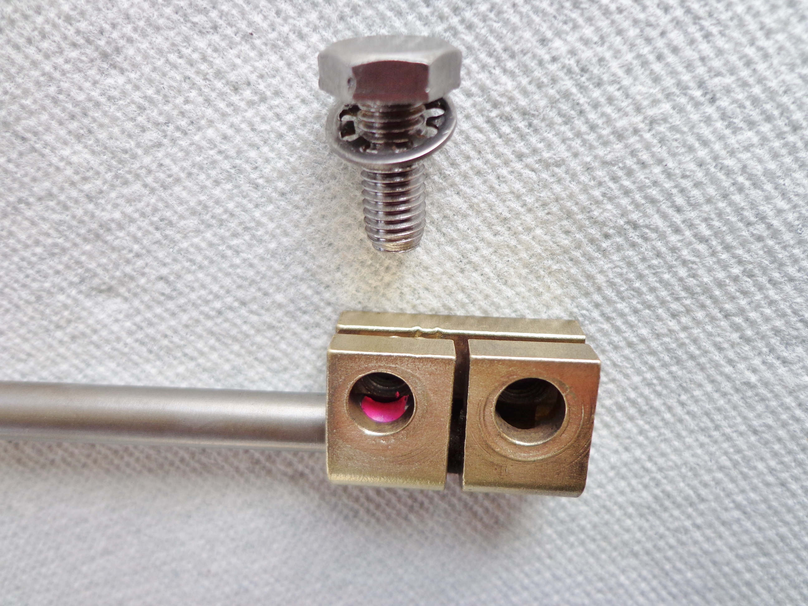

February 8, 2017 at 7:56 pm #52656When Mr. Asa says "remove" that means take completely out. The bolt in the shift rod connector goes through a notch in the shift rod. ( It helps to have a magnet in your socket.) It is OK to drop it on disassembly because it is easy to fish out of the lower unit. Not so on reassembly. On reassembly the hole in the connector MUST be EXACTLY aligned with the notch in the shift rod. If there is any misalignment, the bolt threads will be dammaged and tear out the threads in the connector making it impossible to tighten. Then in use the bolt falls out and you loose the ability to shift out of reverse. (The rod can push, but can’t pull) . . 😉

February 8, 2017 at 9:10 pm #52661February 8, 2017 at 9:21 pm #52663Are those just brass?
classicomctools@gmail.comFebruary 8, 2017 at 9:22 pm #52664quote Richard A. White:Are those just brass?Yep. Real easy to strip out.
February 8, 2017 at 9:28 pm #52665I wanna make some since they are so easy to strip out…
classicomctools@gmail.comFebruary 8, 2017 at 9:44 pm #52666quote Richard A. White:I wanna make some since they are so easy to strip out…It uses a notch in the rod to hold onto the rod rather than compression. You could conceivably do some out of a small chunk of stainless that has two threaded holes along the X axis and one hole drilled all the way through the Y axis.
I’m not sure why they made them out of brass originally.
February 8, 2017 at 11:52 pm #52671Brass is a LOT easier to machine than stainless. I bet that’s the main reason. More production and less tool wear.
