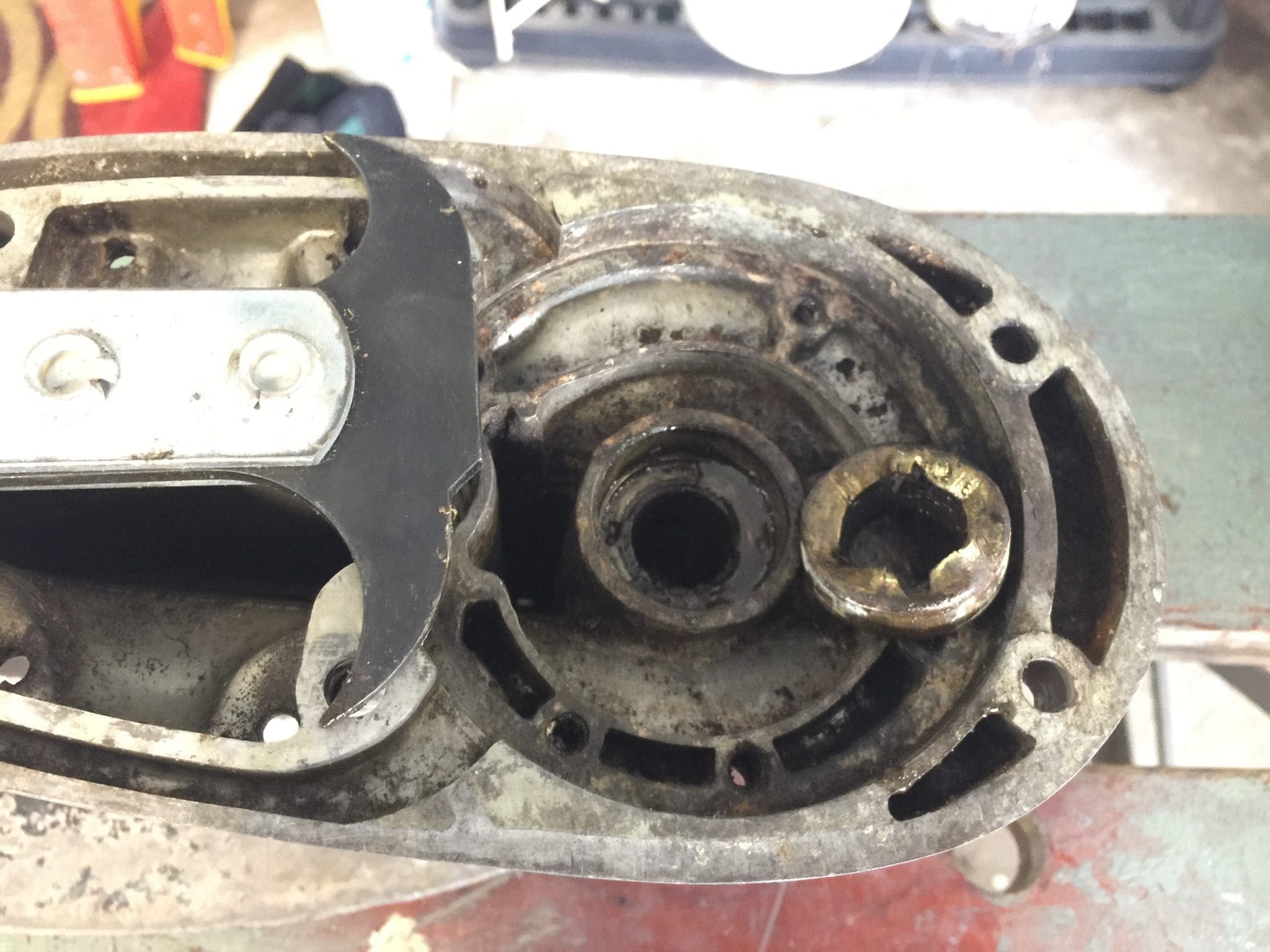

      What’s the best way to remove and install a new water pump seal?
      I am rebuilding the lower unit in my 58 Big Twin.
      This one is really stuck in there.
      Thanks, Steven
      #184286
        A seal puller, or hammer & punch or chisel, screw driver with block of wood for leverage,
        drill a small hole, insert a wood screw, and “pry”. Some work some days, some
        work no days, lol.

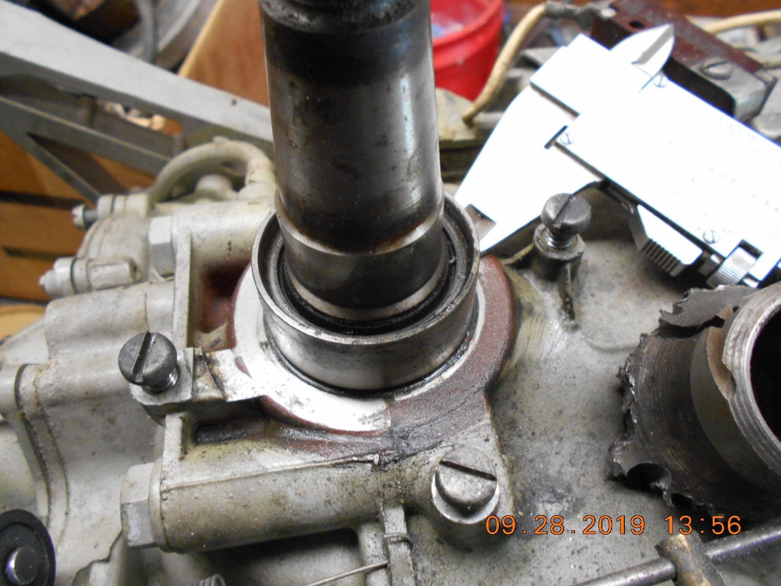

        At least you have room to work. I’m wonder about this crankshaft seal removal, without
        using the “proper” tool.

          That gearcase seal is not the original. Is it leaking?
          Richard White might be making the crankshaft seal tool. richardsoutboardtools.com
          #184304
            Richard’s website says he hasn’t gotten the 40 hp upper crankcase seal removal tool
            into production yet. I wasn’t planning on working on a 40 hp, but it came with the boat
            I wanted. I don’t plan on ever getting another one…. especially a manual start, therefore
            I’m hesitant about spending $58 to remove one seal. I do have a 56 Evinrude 35 hp
            awaiting revival, but it appears that takes a different seal removal tool.
            #184307
              Yep, a 40 seal is larger than a 35. Personally, I’d run the one that’s in there unless it proves to leak in the future. Time enough to deal with it then.
              #184316
                I’m guessing it’s the original 56 year old seal. I had the torch on the flywheel several times
                trying to get it to pop off, but I didn’t see where anything melted, i.e., the old broken coils,
                so perhaps the seal didn’t suffer heat damage.
                I may leave well enough alone with the seal. Perhaps I’ll just put on
                new ignition components so I can at least hear it run once.
                The Gale’s “Evinrude” lower unit has been gone through with
                new seals, bearings, etc., so that can be used on other projects
                if wanted. I think we decided it was off a 25 hp…… looked the same
                as my 25 hp RDE-17 anyway.

                        I’m usually able to get them out with my seal puller with one or two sharp yanks. I had one that was really stuck where the puller just ripped up the metal edge of the seal and I then used a pair of linesman pliers to grab the torn metal and pull the seal.
