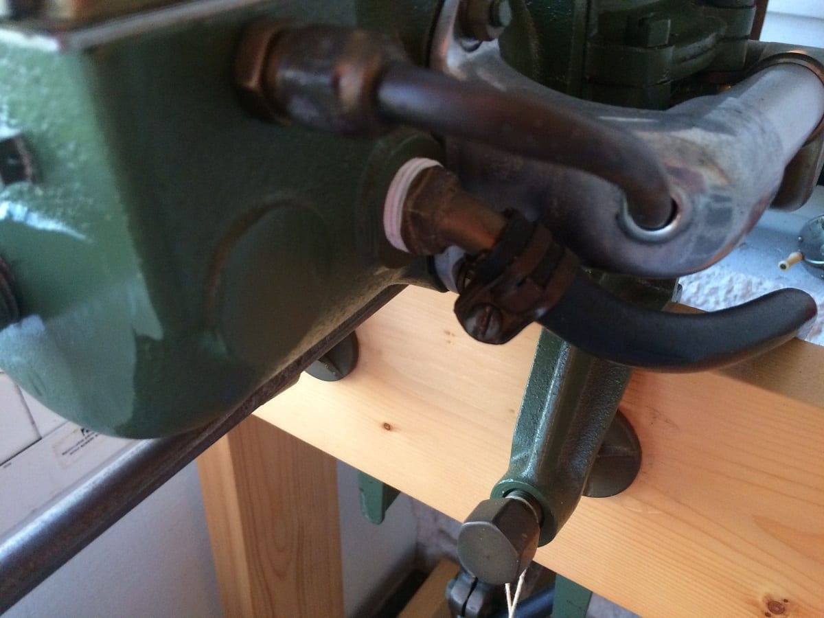

      I’d like to know the answer to your question as well. The old red hose that was on mine
      disintegrated as well, and I have clear vinyl on it for now. Can’t remember what
      mine had for clamps, if any.
      DSCN7486

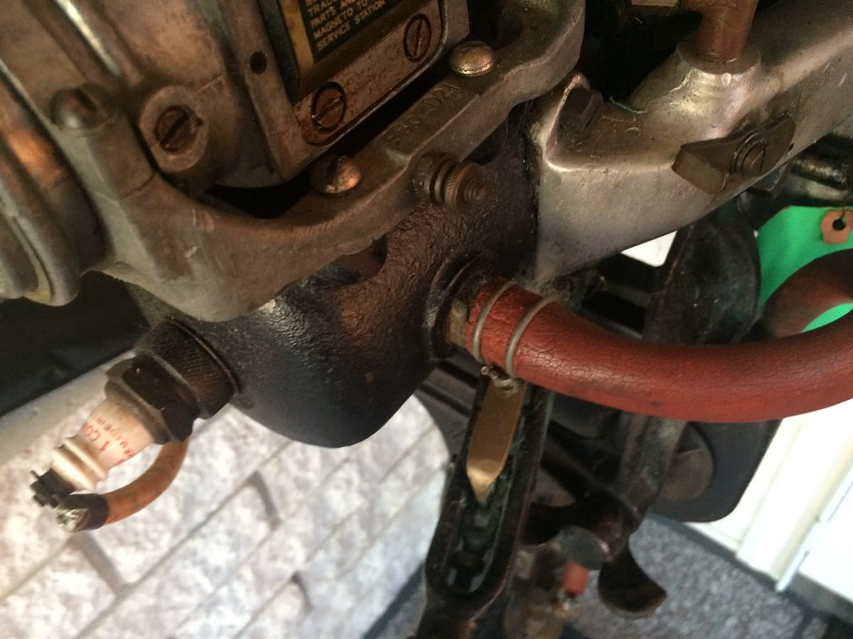

            TOM GOEPFRICH
              Here’s what I’ve found on a couple of my RBMs. Probably findable at swap meets, flea markets etc.
              IMG_1122
              IMG_1123

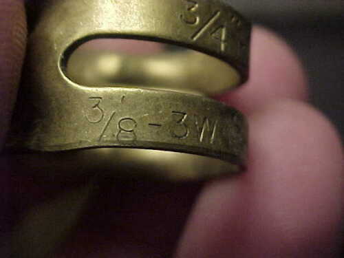

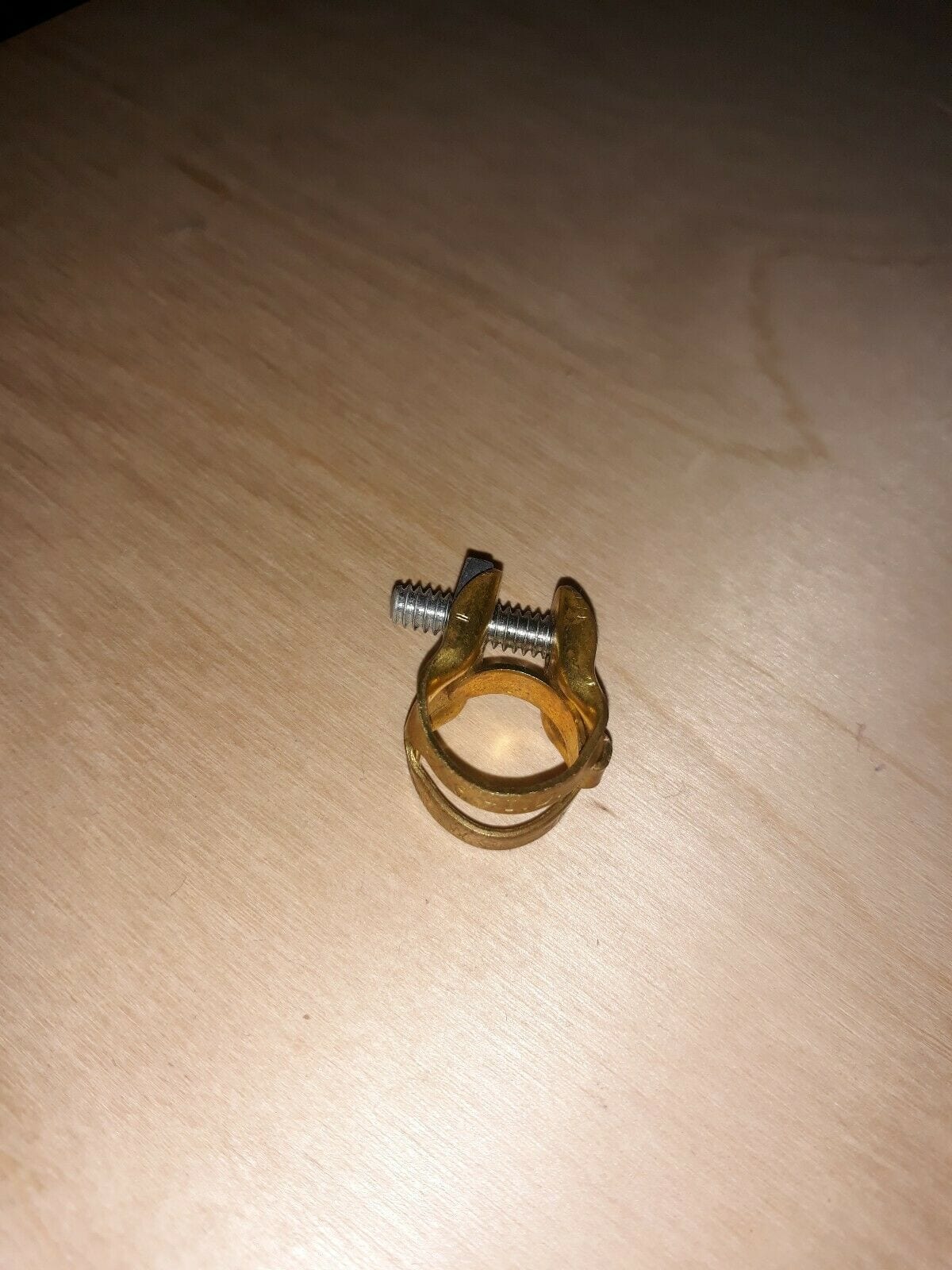

              ROBERT LAFAYETTE
                I found some brass clamps on EBAY.
                https://www.ebay.com/itm/4-NOS-Sherman-3-4-ID-3-8-3W-Brass-Water-Hose-Clamp-Antique-Car-Truck-Tractor/164126518808?hash=item2636b3ee18:g:YTwAAOSwd2tdHbuy
                s-l500
