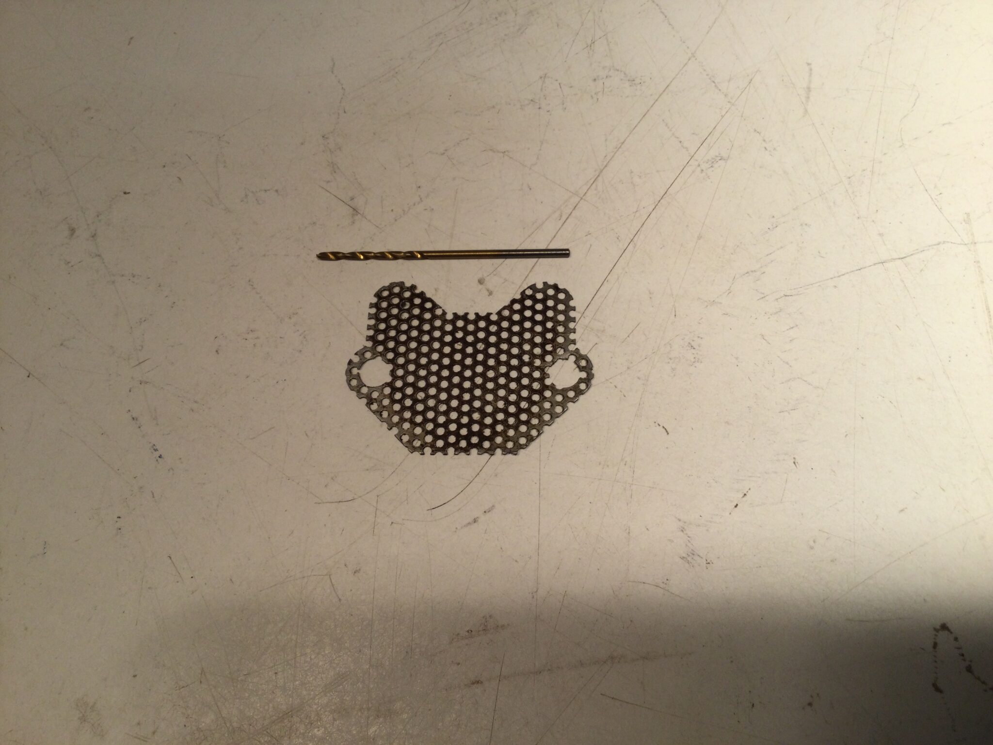

      #247682
      Rusted Junk
        5690EEF5-A9C7-4904-AB3C-4D1DFD2FDE55
        They are .062 or 1/16 “ if this is the part you are referring to.
        RJ

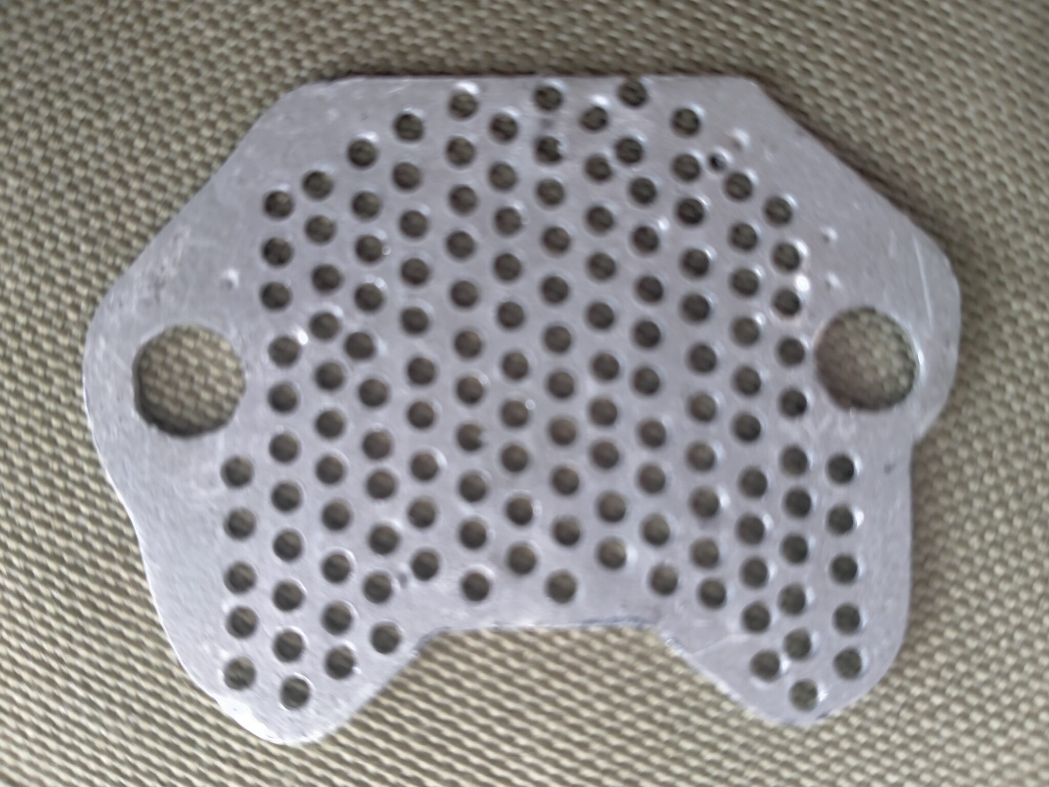

        #247714
        Monte NZ
          Thanks very much RJ for the info and photo…….much appreciated!
          I spent most of this afternoon making it. It isn’t perfect but the holes are all in the right places………certainly better than not having one, going on what I have read.
          Attached below is a photo of the finished screen (hope this works…….haven’t done pictures using Google Drive on this site before……..hope it works!
          https://photos.app.goo.gl/PPtiA6E5GuB9naqY7
          Thanks again
          Monte NZ
          #247755
            Your determination has paid off. Well done!
            JW-Carb-Plate
            #247760
            Rusted Junk
              Monte,
              No problem , I have one in my stash of treasures, was easy to slip a drill into it and send a picture,nicely done on the homemade part, I found one on Evil Bay for a friend about a year ago and I think it was around $30 US to buy. 👍👍
              RJ

                #247853
                Monte NZ
                  Thanks Mumbles for your kind words and thanks again RJ for your help …….$30 on Evil Bay is pretty steep and then there is the cost of postage!……talking of high postage costs, I was quoted $30 Canadian recently for a set of decals to be posted to NZ! Needless to say, I will see how well the motor performs before I consider getting a set.
                  Thanks too crosbyman for your comments……..from what I have read in Garry’s posts, it would appear that having one installed,could improves the idling.
                  You may be interested to know that it was made out of an old aluminium Champion Spark Plug sign……….nothing like a bit of recycling!
                  Thanks again
                  Monte NZ
                  #247855
                    If ever you get the chance try idling with a screen and without the screen to make it official…
                    To bad for the Champion plug sign antique a can of Pepsi or.. Coke could probably do a good screen also (easy to cut a copy and easy to punch holes 🙂 )

                      #247917
                      Monte NZ
                        Crosbyman
                        When I get the motor finished, I will certainly be interested to do a idling test with and without the screen and post the results
                        and by the way, you will be pleased to know that I didn’t have to wreck a good Champion sign……..it was made from a bit of one on my Dads metal rack…….I recon it must have been there a good 60 yrs!!!
                        Thanks again
                        Monte NZ
                        PS I had tried a Coke can, but found it too flimsy
