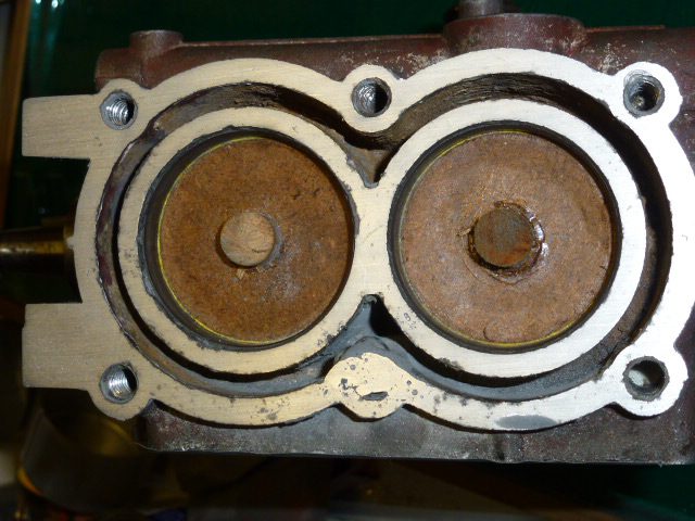

      Attached are photos of the block and cylinder head that I have lapped.
      Going on the photos, do I need to do any more lapping?……..the bungs in the block are to keep the grindings from going down the bore.
      NOTE The welding repair on the water jacket………head bolt hole to be rebored
      Thanks very much in advance for any help.

      #245614
      RICK EICHRODT
        Monte,
        I am no expert but the reason one laps the gasket mating surfaces is to take any warpage out of the block and head. From your pictures, you have lapping marks all over the gasket area which is what you want, I believe. I would not worry about the tiny marks that I see. The more you lap and take away material, the more you raise up compression. It looks good to me!
        Rick

          Monte NZ
            Thanks Rick and fleetwin for your replies…….much appreciated.
            I didn’t think there was any need to go any further, but I was concerned mainly with the block having a lot of corrosion.
