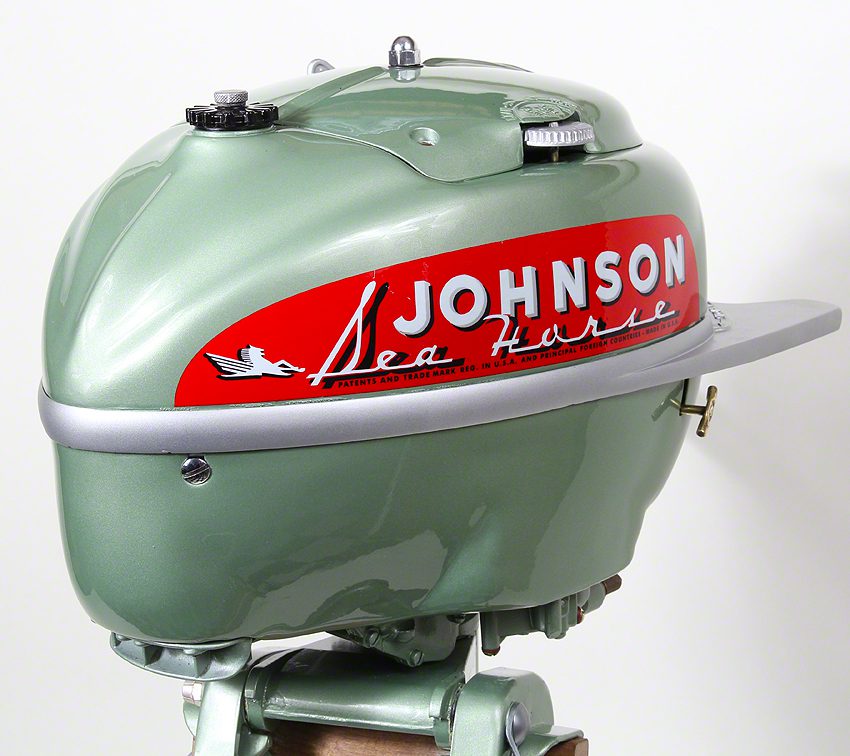

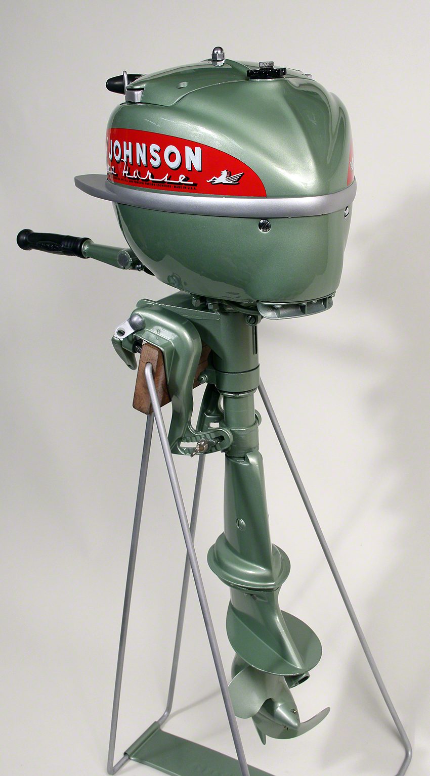

February 22, 2023 at 1:50 pm #273034Looks pretty good as is. Might benefit from gentled cleaning so as not to to disturb decals Grips for handle, recoil starter and water pump oscillator are available as reproductions. I do not know if ignition coils are out there. But, coils may be OK unlike later OMC coils.
Work on only one project at a time, take photos and notes. work at your pace. Some are skilled and fast and can make a living as mechanics. In the hobby speed is not required. Work with care and keep track ow what goes where. A parts manual for the model and year may help in tracking down parts or in assembly. Not essential as many in hobby do quite well without.

February 22, 2023 at 2:34 pm #273035what model is it tn# ?? td #
tn27 and up use standard magneto coils points condensers and easier to fix up here is some info

February 23, 2023 at 9:26 am #273061Exceptionally nice looking original TD or TN. It will surely need new leather primer seals and instructions to install them. The Poche Website is very helpful, but the Add there for my primer seals and instructions is very old. I had to raise the price to $10.00 a few years ago as it is getting harder to find proper leather to make new ones.
February 23, 2023 at 11:42 am #273070February 23, 2023 at 6:30 pm #273085That’s a beautiful TN Mumbles!
February 25, 2023 at 1:45 pm #273146That’s a good looking 3 hp Johnson Mumbles, looks like new, but it’s too shiny, not like the old original faded green. Does it run as good as it looks, those were good trolling motors, back in the day. Gene.
February 25, 2023 at 3:13 pm #273147Mumbles’s motor is a 5hp TN with neutral clutch. Necks must be thinking of the early Johnson 3hp JW.
