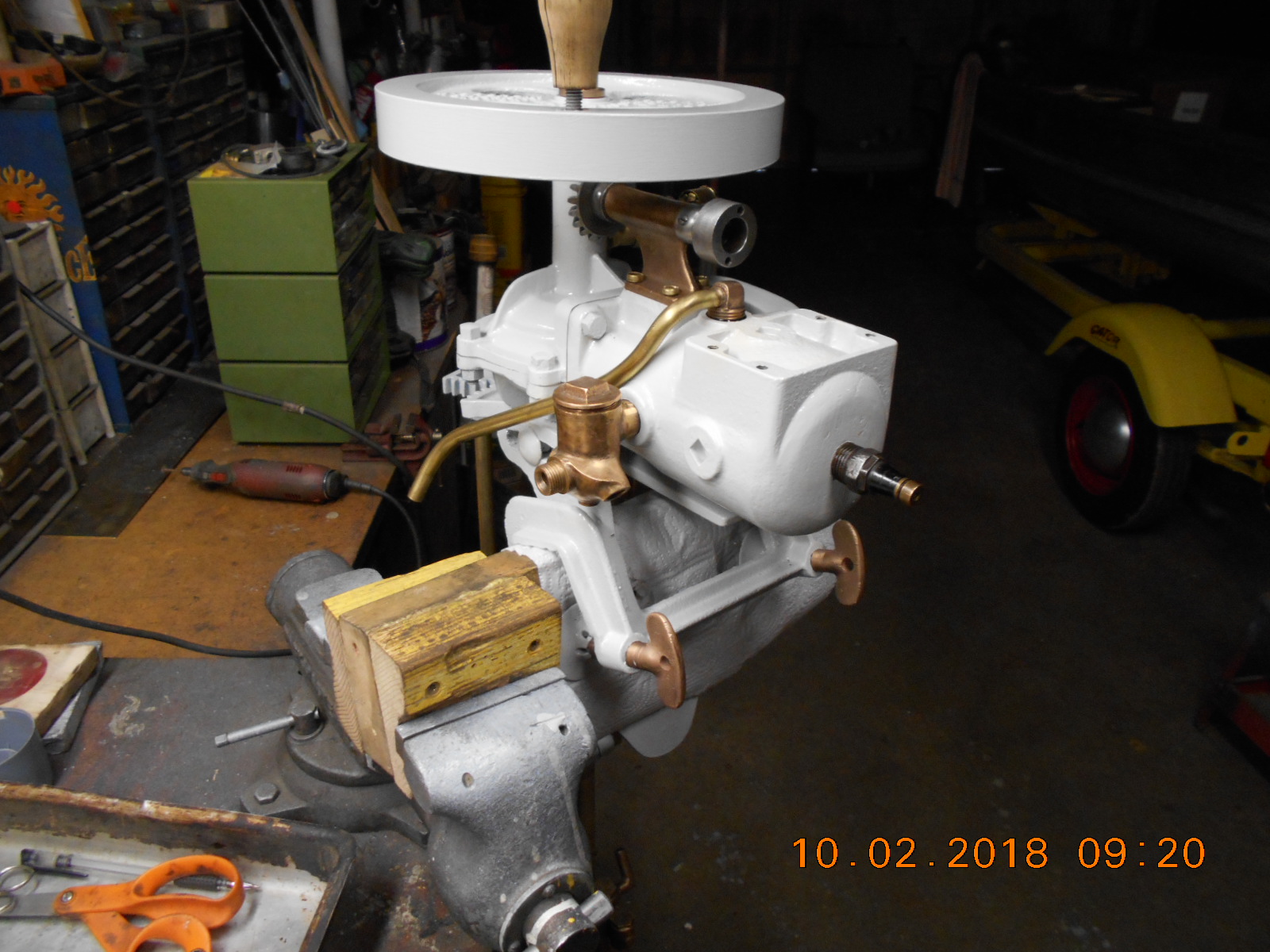

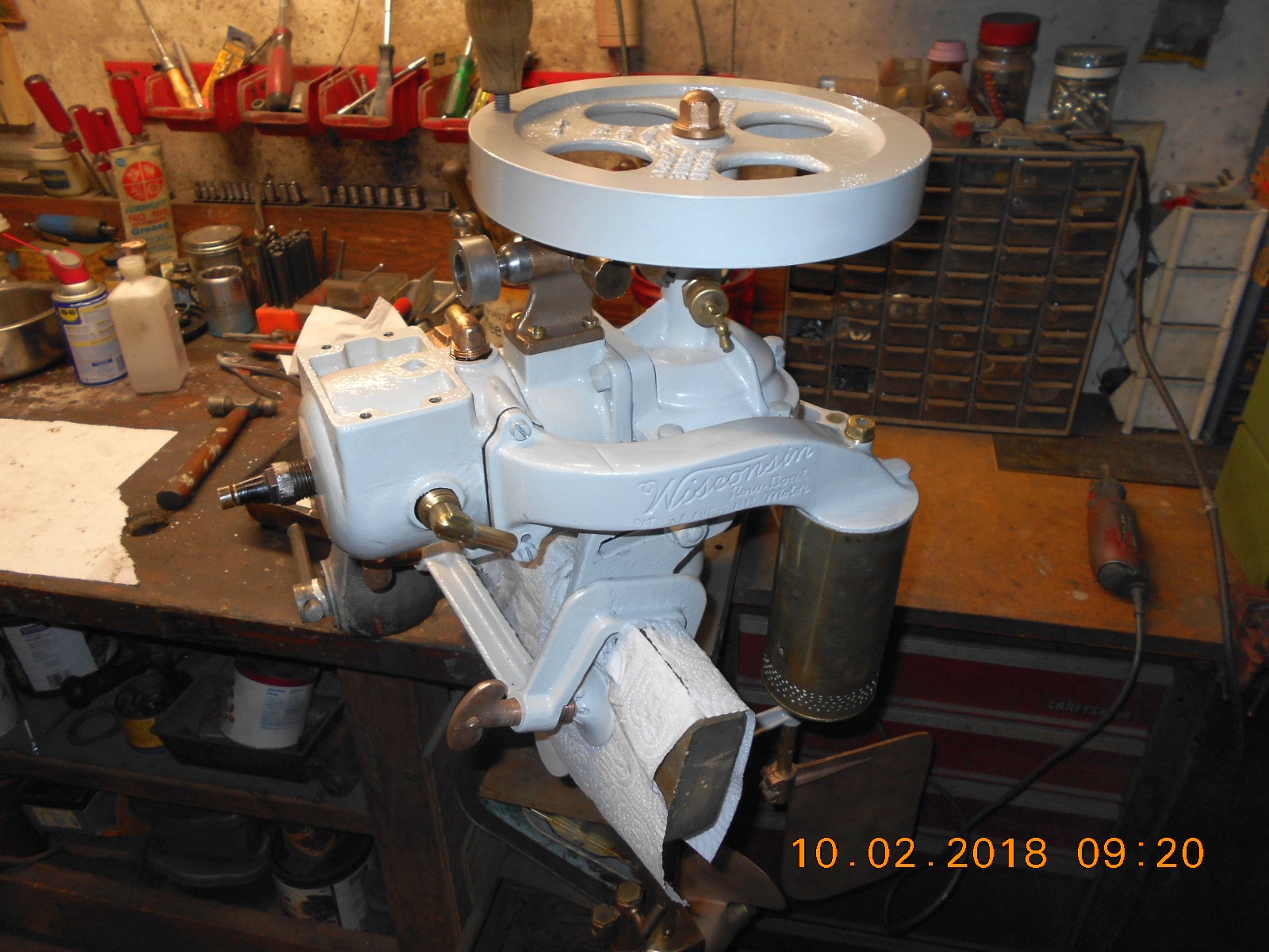

            #83904
              Buc,
              Looks like you have yet another masterpiece in the making. Keep up the great work!
              1982 Evinrude 25hp
              #83915
                One note, is that paint going to hold up on the exhaust???
                #83918
                  quote Richard A. White:
                  No, that paint will be toast if it ever runs. High temp silver would have been
                  a better choice. I may never find a magneto to hear it run, so the paint is
                  safe for now, lol.
