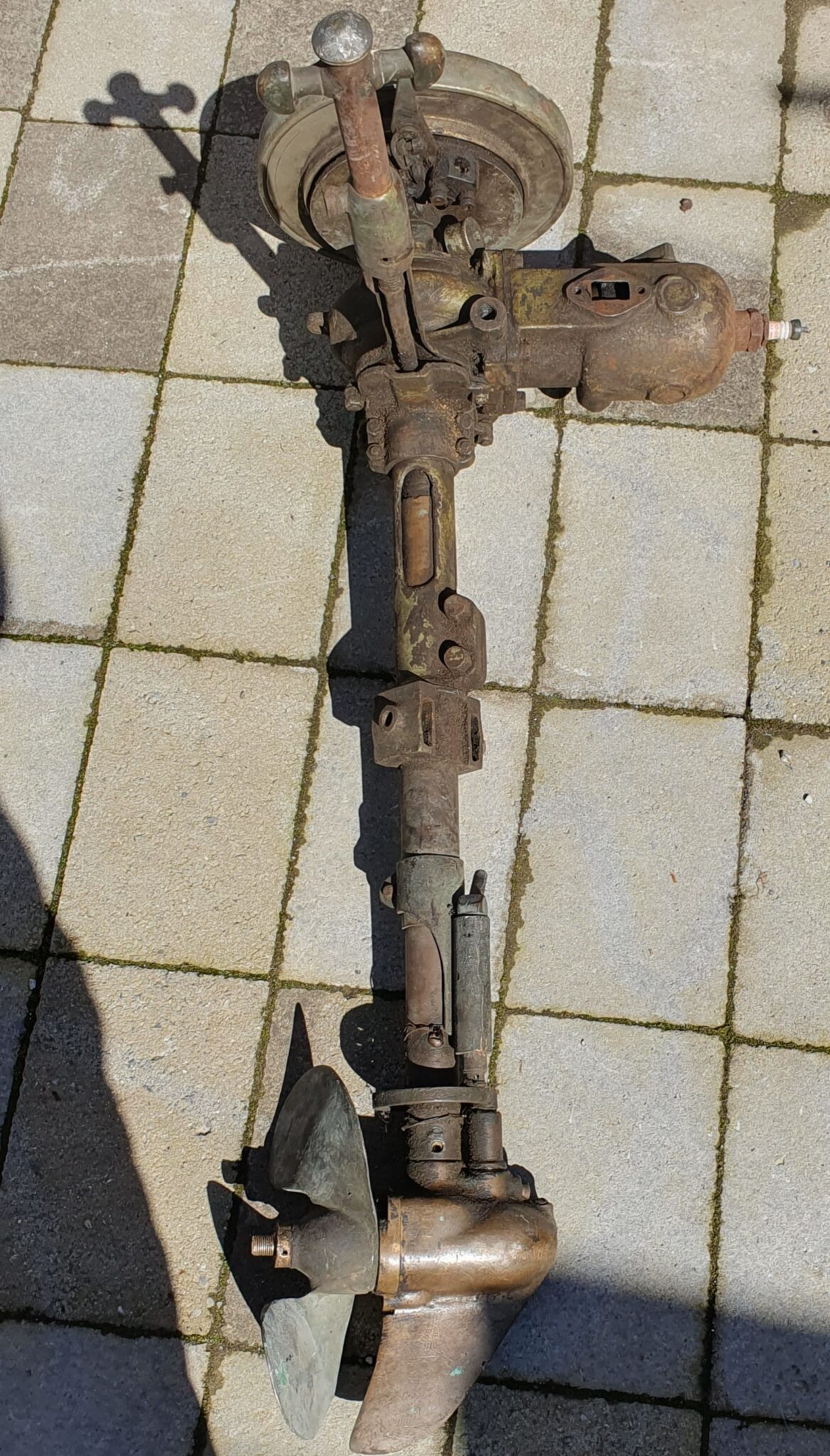

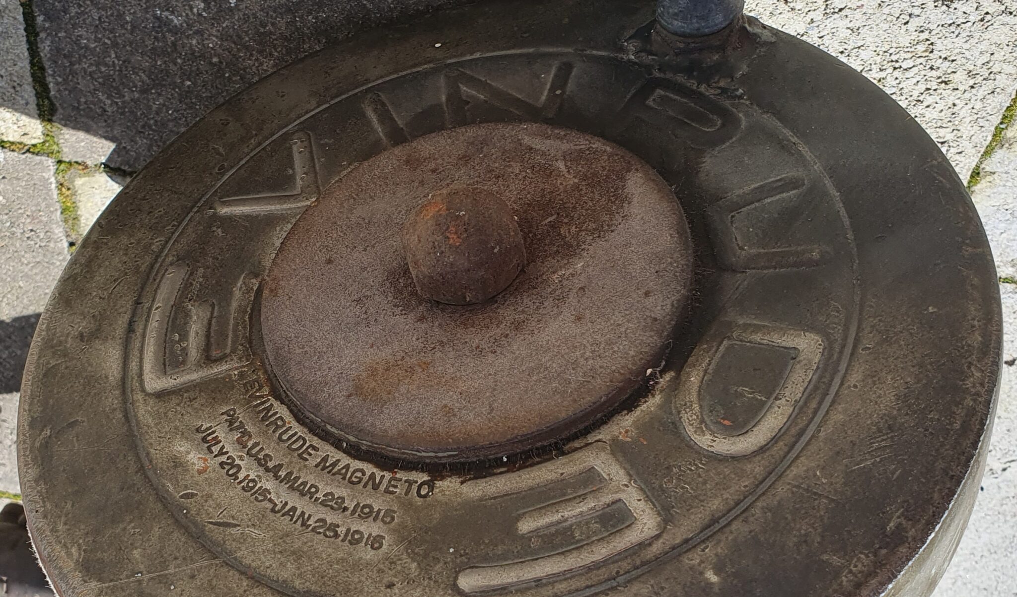

Your garden variety Evinrude “A” , with the reversing lower unit. Interesting modification to the tiller handle, I suspect to afford a better grip to twist the tiller handle into F or R mode. Mid 1920 ‘s I would guess.

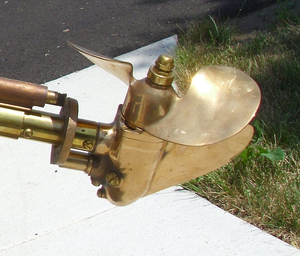

Going by the gear case it’s earlier than 1920. I’m not very knowledgeable on these. I believe that gear case was used from 1913 to 1919. If anybody tells you different – you should listen to em.

April 20, 2025 at 10:23 pm #295685Its 1922 or earlier because its a RH rotation prop lower unit. Hope this helps.

April 20, 2025 at 11:49 pm #295686PM T2, Good catch on the prop rotation.. that’s why we keep ya’ around

Thanks guys I’ll push on so with the restoration, I did get a box of bits with it and it seems to be all there the fuel tank is in bad shape full of holes that will need brazing, the tilt arms are missing off the transom bracket looks like they were riveted on so probably not original but easy to make new ones. I haven’t tested the coil yet but hopefully I can get it going again, the keyway was snapped in half so hopefully that was the only reason she was put away. Thanks again. 👍🏻
