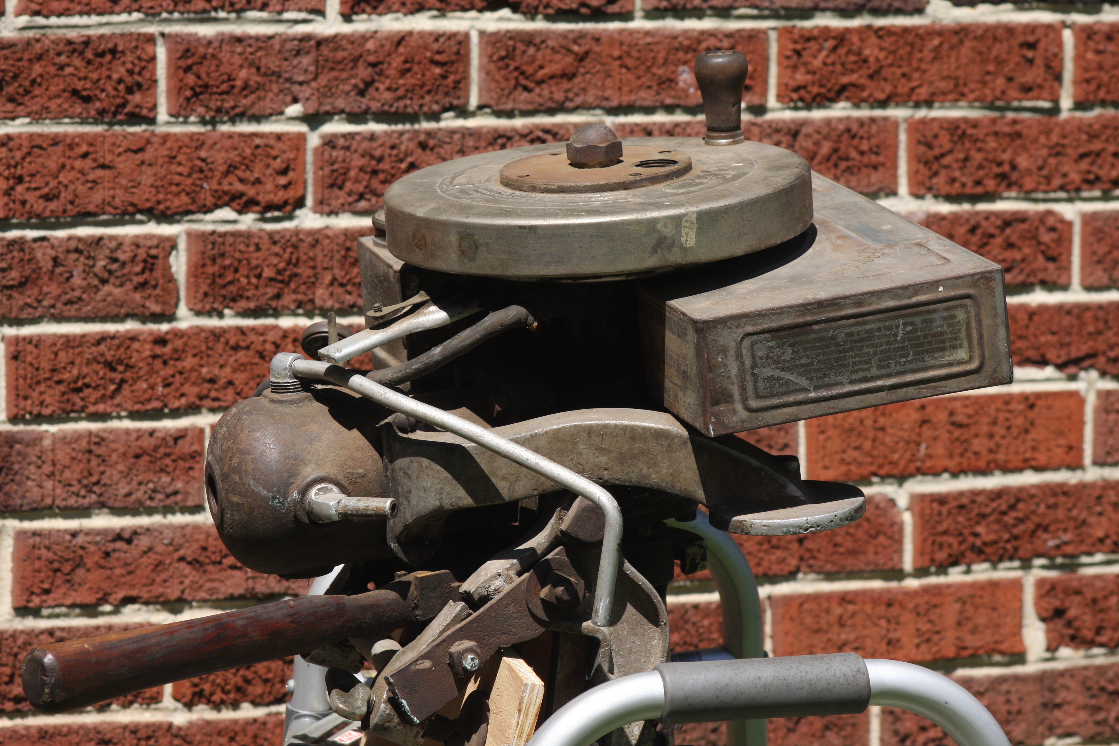

      Good morning gentlemen!
      What size threaded rod will i use to install the muffler wrap and lower muffler end cap?
      Will i use a nut on top and bottom or is it drilled and tapped?
      Thanks
      Jim
      2Fast4Me
      #82648
      lyks2tinkr
        That’s an early manifold. What’s the serial number?
        I don’t recall if my 14 is threaded through. I think it is. I’ll look when I get home from work.
        #82649
          That is an interesting mash up of parts you got there… The manifold for that year should be wet, that one is dry and lack any markings…that puzzles me… threaded rod I think nut on top…. Bottom depends on that of manifold and that one messes with my head…
          #82650
          RICK EICHRODT
            Bottom is tapped 1/4 X20 I believe. I use a 1/4 brass rod, threaded on both ends and have it stick out the top about enough for a nut and lock washer. I am sure if I am incorrect, I will be smartly corrected.
            #82653
            kees
              International Member
              To all here
              has no one noticed that this muffler is for the model " K "
              yes, the aluminium model and misstep of Ole
              see also the bracket !
              #82654
                Kees, read the first line of my post…lol
                #82656
                kees
                  quote Richard A. White:
                  yes, I did
                  but, if it has an aluminium carb, lower unit and a ID plate with the "K" model
                  than it is NOT a mash up of parts
                  lets wait if there comes more info
                  #82657
                  2fast4me
                    I’m back! This is a lightweight SN K1598. Some of you guys saw it at Constantine in2017. Carb is aluminum, lower unit is brass. It is bent, busted and broke in a lot of places but it’s getting a new muffler can. One piece at a time as Johnny cash would say.
