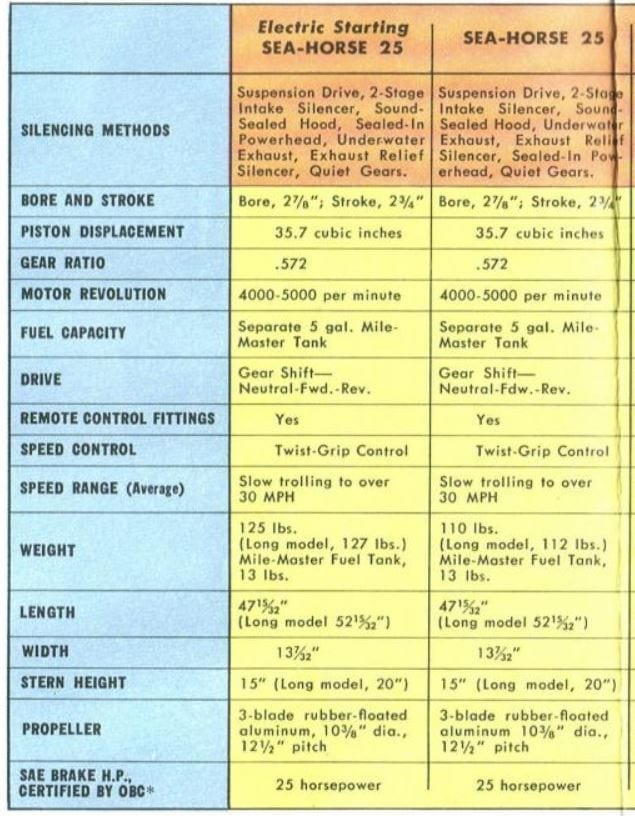

      My manual says it is rated at 4,000 RPM.
      Does that mean that is the maximum RPM I should run at WOT?
      I’ve seen other posts mention that the ideal RPM is 4,500 RPM at WOT.
      Right now with w 12″ pitch prop, I’m turning 4150 RPM at WOT in my ’55 Crestliner with normal loading. speed is around 24 MPH.
      I could drop the pitch down if I needed to achieve 4500 RPM.
      which RPM should i be trying to achieve?
      #218970
        You are within range. “Ideal” probably would be around 4500.
