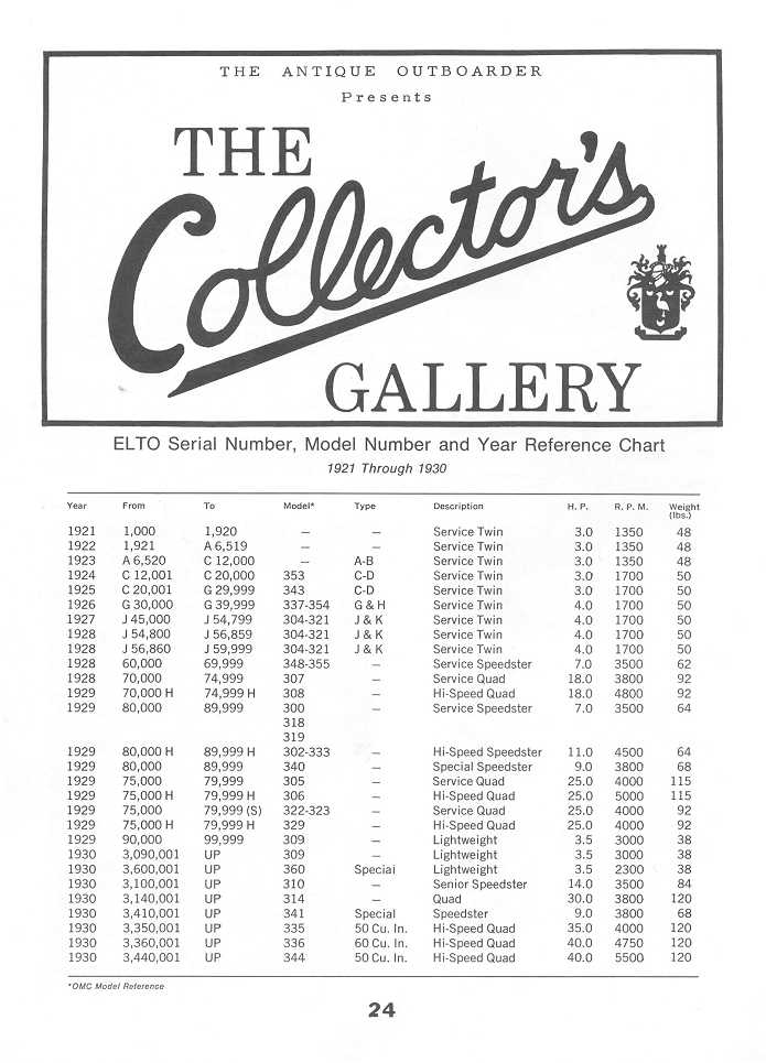

      Merry Christmas to all my fellow outboard enthusiasts!  This relative newbie to hobby finally found his dream antique outboard…an ELTO Rudder-twin. I need assistance in determining the year it was built as well as the most appropriate sources of literature for repair, parts list, and general info.  The Rudder-twin is in generally good condition and has no dents in the tank.  The S/N is “C12315 …not sure what the C designates.  I am guessing that this is a 1922 or 1923.  Any help would be greatly appreciated as to where I can find literature.
      #270291
        Elto-Serial-Number-and-Model-Year-1921-1930
        #270296
